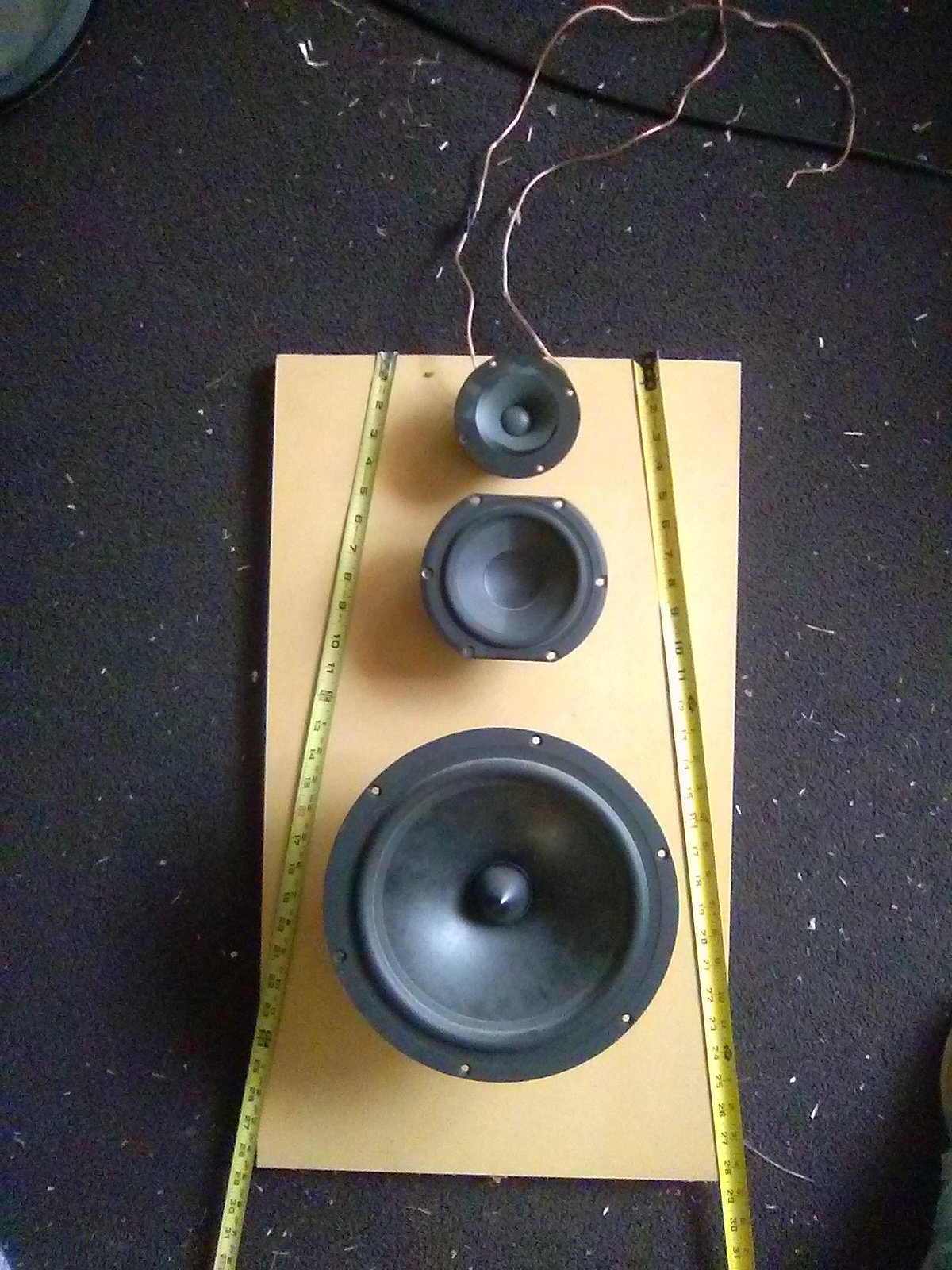

The box will be sealed. I've been using the woofer in a 1 cu-ft box. I will check, but I think I can reduce that a little. My plan is for a tapered baffle that also has a slight slope.
I may detour a little before I start building a complicated box shape. What I will probably do first is add a baffle to an existing box, and make a x-over. If that goes well, I will continue. If it goes really well, I may stick with a more traditional boxy shape. What I need to confirm, is that the x-over is not going to get messy. I have measurements already, but the baffle will change the required x-over somewhat.
I want to keep the box short enough that it does not block the projected image. On the other hand, I'm willing to raise it on a stand five or six inches for some programming, if it makes a difference in sound quality. This is the primary reason that I want to taper the box. If I'm casting a shadow on the bottom of the screen, I would rather it be 6" wide, than 12".

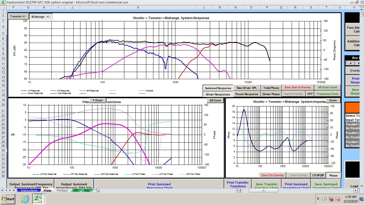

Here's a sim that I made from my measurements. I stacked a small 2-way speaker onto a second box containing the woofer. Actually, the tweeter was on a 3rd box.

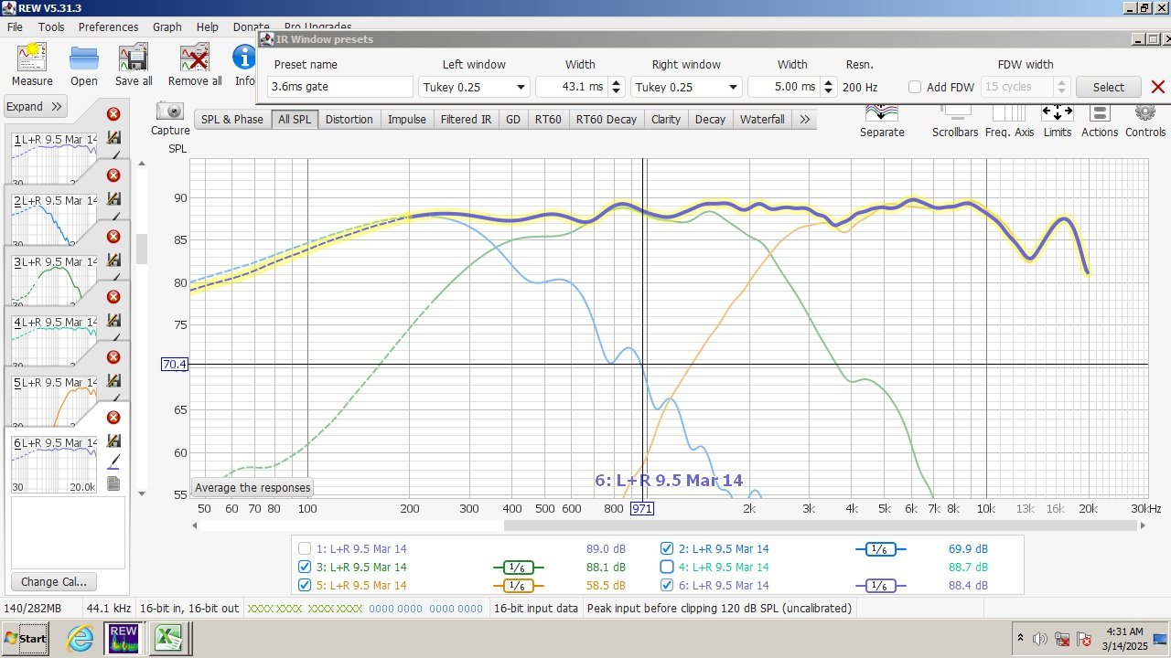

I got a little done on the box construction. The odd angles are a challenge. It was cold this morning so I worked on a x-over instead, using two stacked boxes. The tweeter is not the one I plan to use, but I think matching the other will not be a problem. Here are some measurements. Off axis about 20 degrees which is where my seats are. These are gated measurements, taken indoors. The speaker was only on a 24" stand so, it is what it is. Needs to be higher. It will change some with the new baffle, and other tweeter anyway. I just wanted to get a jump on the x-over, and see if there were any surprises. My sim for the mid was no good. I used a zma for a different driver. I resorted to trial and error for this. If I have enough energy left, I'll move it into place, and give it a listen.
Well, it sounds different than my other speakers. Not sure if the difference is an improvement. It's a voicing issue, I suppose. This sounded more laid back in comparison. Voices seemed softer, and smoother, but some vocals seemed to lack a little bite that perhaps I just prefer. I'm on the fence as to whether or not to continue with the design.
The x-over was all 3rd order electrical, and there were three padding resistors, so the x-over part count was 15. That's not terrible, but it would require that I buy one driver, and a few coils to replace my on hand parts. I keep needing 2.5mH coils, and coming up short. I would likely add another notch on the mid at 4.5k too, so, that's three more parts. Might get crowded in the box fitting a large x-over.
I may change the mid to a 4" Peerless HDS driver I have, and raise the x-over points. The 4" is very smooth up to 4k, and beyond. I suspect the x-over might be a little easier, maybe with second order filters, and without needing the 2.5mH in the mid high-pass.
