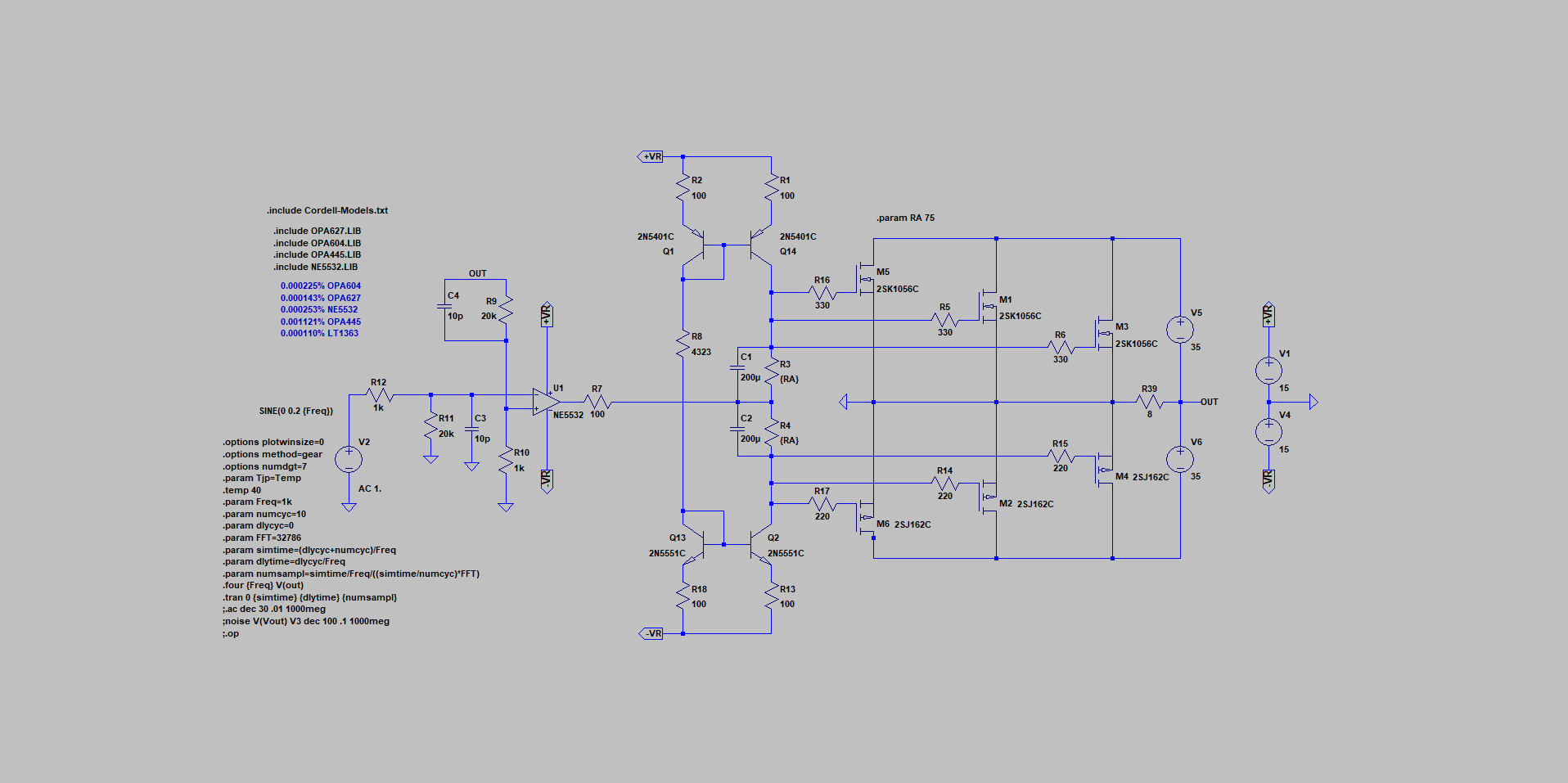

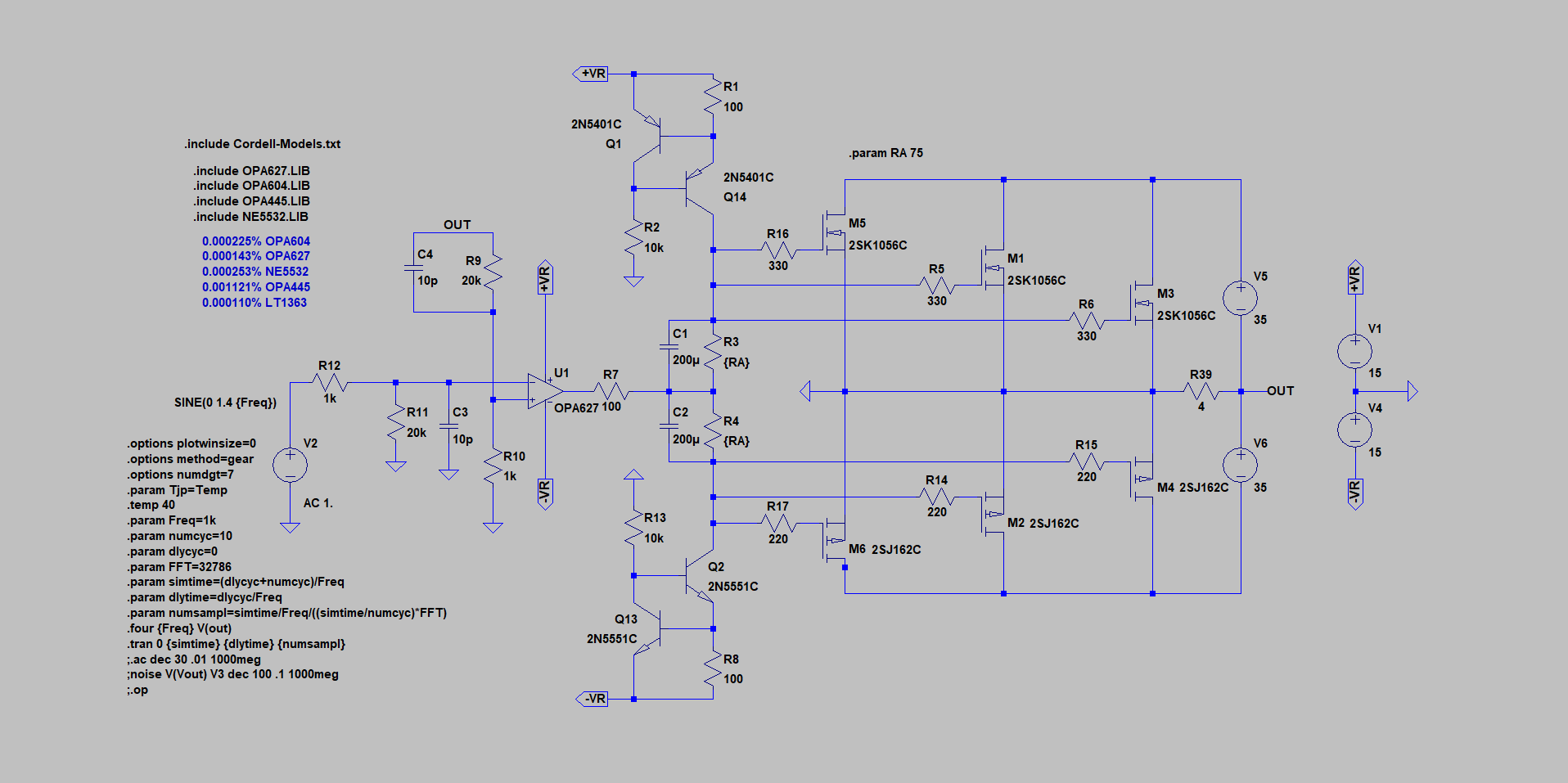

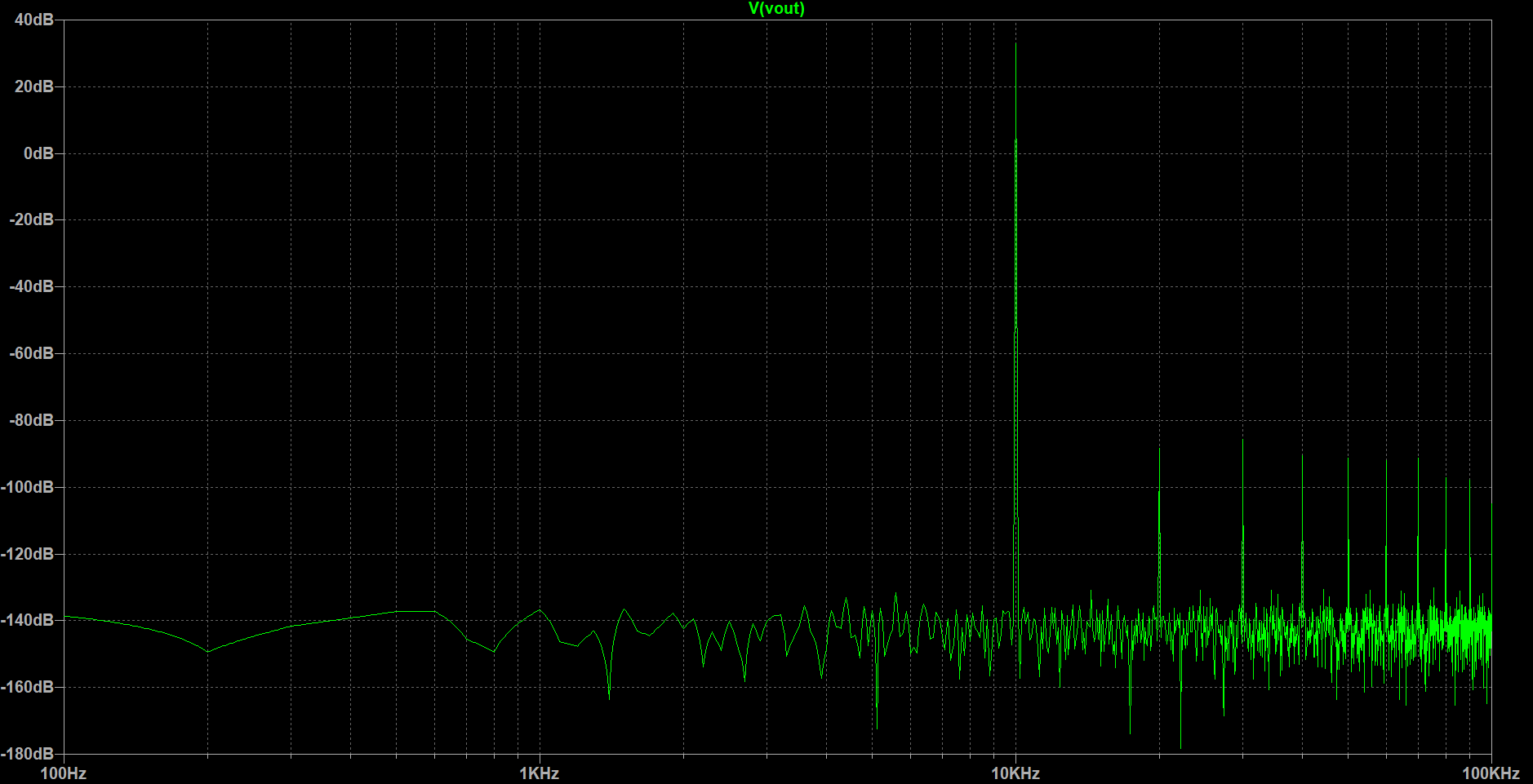

Hello,
I'm interested in floating supply power amps like Transnova Hafler, QSC, Acoustat, Dalix, and I just found these diagrams on my hard drive.
I do not know where I copied these pictures, I search for their provenance.
I searched on google, on this forum but nothing.
I like the use of op amp directly on MOSFET
Best regard
Sébastien

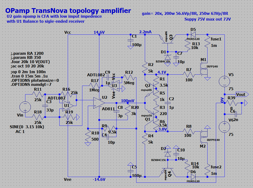

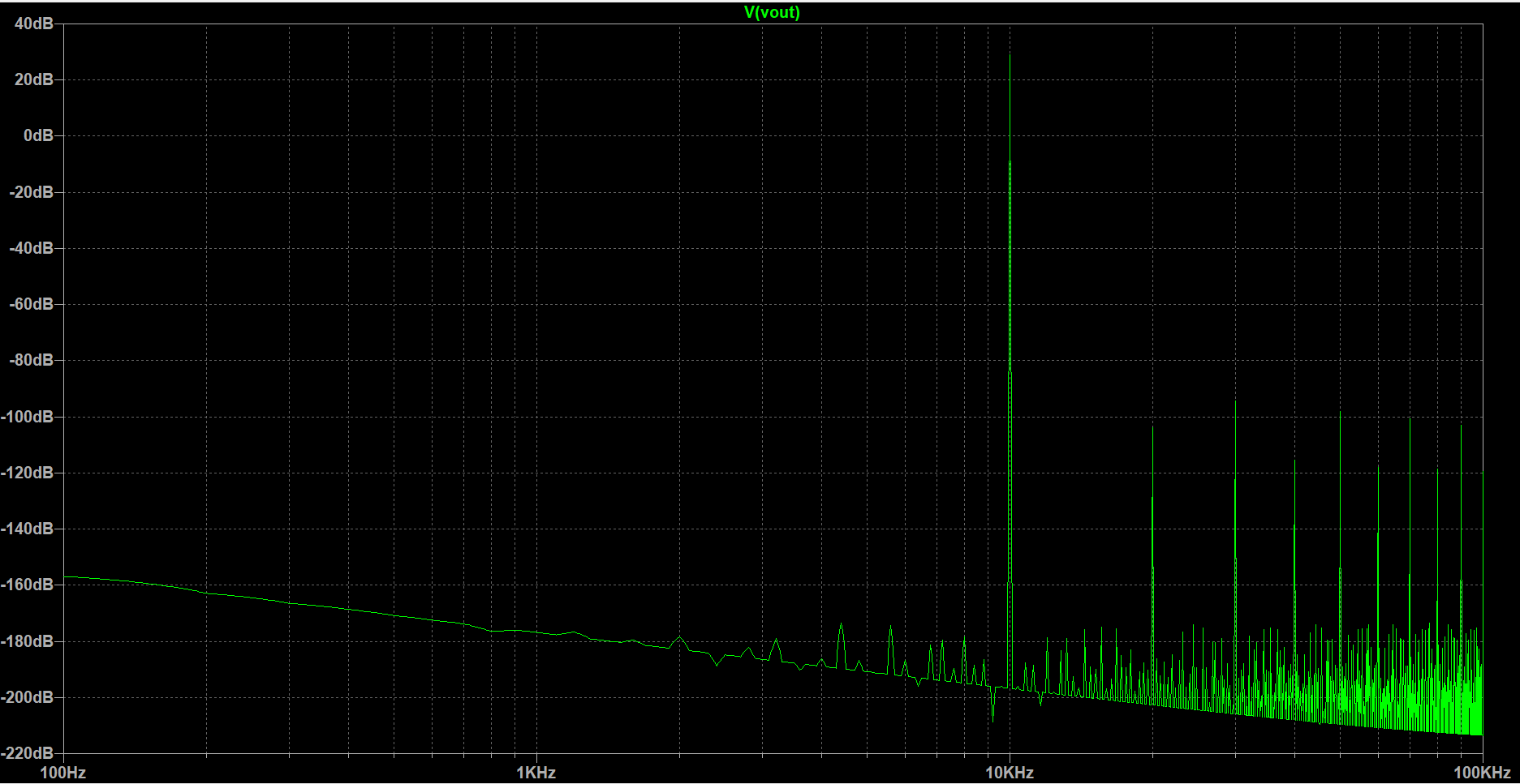

This is a AD811 CurrentFeedback OPAmp TRANSNOVA topology 250w/8R power amp simulation.
Main amp use AD811 , with TL082 as balance-to-unbalance input buffer and dc-servo .
The AD811 can alter use AD815 CFA will get same good performace, but if alter use AD823 or TL082 will increase much more THD.
