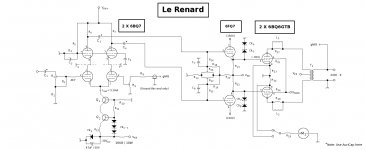

Otherwise, an LTP with an active tail load will have much better balance, both AC and in terms of harmonic distortion. Uses fewer components as well.
Can you link an example?
It's for hifi use. I should also mention that I have 300vdc SMPS supply. Creating a negative voltage isn't that simple.
Two examples: Le Renard, Vixen (attached)
You could always make a negative rail from a small 24V PTX, like a control xfmr. That wouldn't be much of a problem if all you need is enough voltage for an active tail load.
I tried the circuit at the bottom of this page The Valve Wizard -Long Tail Pair and it's garbage. Over 3v difference between phases. I don't think I've ever got anything off that site to work right. The ones you posted, I don't see how either of them use fewer components. The first would add 4 additional tubes, the second would add 3 (if they were all dual triodes). Due to the reason explained below, I need to use at little tubes as possible.
Really Miles, those are not appropriate suggestions for the OP's level of expertise. Stop showing off.
