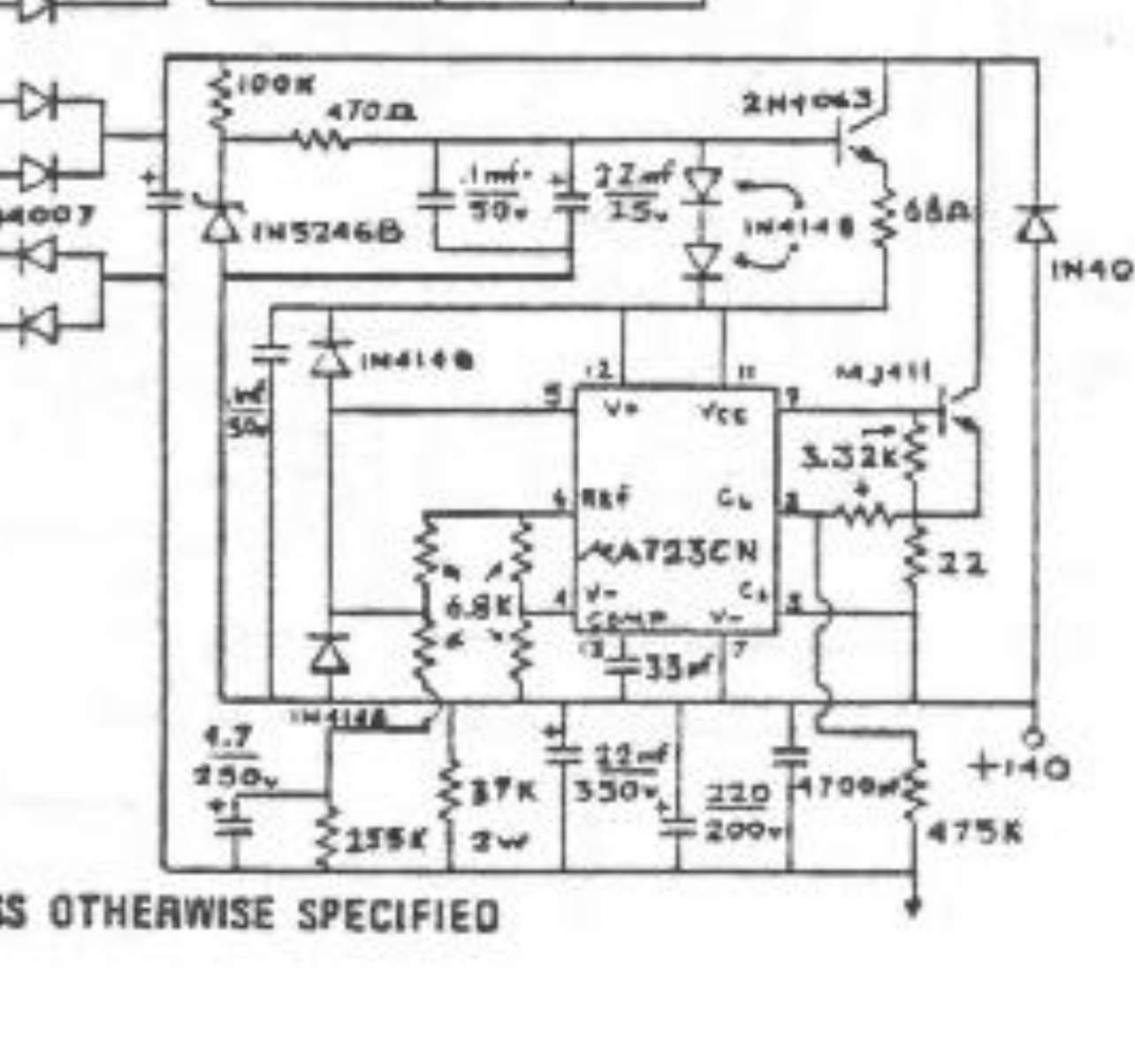

If Your going to do a floating HV regulator do a variation on Roger Modjeski's RM-4 power supply using the UA723, much more predictable results, than using a dual supply opamp, and lower noise floor, 2uV ripple if done correctly. Ive used a similar setup but with a 250V out.

Thanks for the proposed circuit Danny, as far as I can see it seems to use a regulator from the TL783 family. In any case I think to abandon the idea of a "floating" in favor of a more traditional one, like the one among the examples proposed by Elvee.
