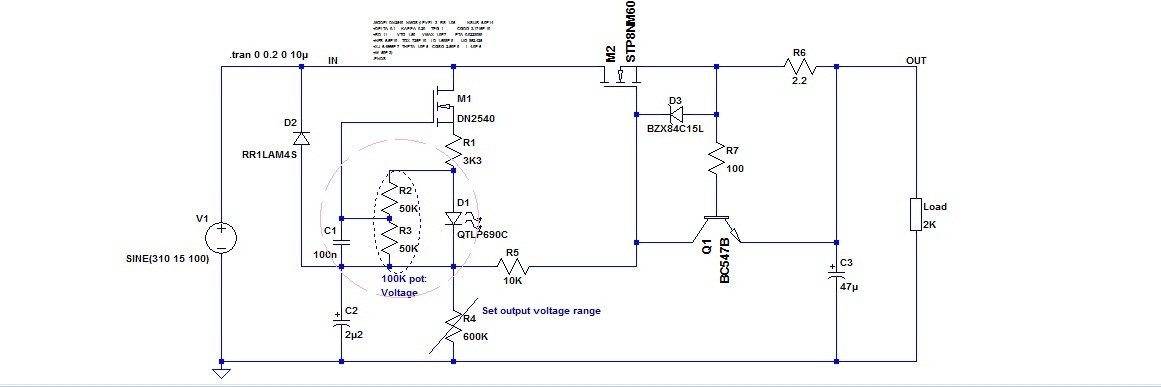

A few days ago I came across a circuit on tubelab, interesting in my opinion, dating back to about twenty years ago. It relies on an opamp as a voltage reference using a certain feedback (error opamp). The resulting circuit is claimed to have low noise and output Z, and stability regarding output voltage drift.
The opamp in question then is fed directly from the AC voltage of the filaments as a voltage doubler (DC floating voltage). There's to say that, according to the author, it must have certain requirements: OP27 is mentioned (unity gain stable at operating conditions) but other cheaper ones I think can be used (NE5534?).
I tried a simulation and gave excellent results, but you know there is half a sea between saying and doing... so I was wondering if it could respond to real needs for powering a pre/phono.

Floating regulators were an inconvenient constraint and necessity in the early days (the need for one or more floating, auxiliary supplies): look at the schematics of early HP supplies, or some Elektor projects.
Fortunately, we have progressed, and such cheap tricks are no more required: it is possible to build a very good non-floating regulator, and also a floating reg not requiring an auxiliary supply.
Jan's regulator is a good example, and I have also proposed a number of alternatives, some fully discrete others opamp-based.
It is always intellectually easier to build circuits like spice projects, where you can throw any arbitrary source anywhere into the game, but being able to do it physically too doesn't mean it's a good idea: it adds complexity and other problems, like the capacitance between the main and auxiliary supply. Truly floating supplies exist in sim, not in the real world.

Elvee, I actually tried to replicate one of your previous circuit working through CCS (DN2540) that feeds a mosfet but I ran into some stability issues. I noticed that one Supertex is not replicable to another and the Vout is not perfectly predictable based on the resistive network below.

This floating technique was widely used in lab PSU’s and gives excellent results. If you reference the control amp to ground, you have to provide some sort of level shifting to control the series pass element and that often entails the introduction of an additional pole in the loop gain which can be problematic. The old LM723 (RIP) showed a nice example using this approach.

Sorry Kevin, I think it isn't right to condemn a whole class of circuits just because one guy is incompetent in designing them.
My T-reg is totally reliable and stable, and has significantly higher performance than a reg that amplifies a low voltage reference to a high voltage. The latter type uses up a lot of loop gain just to amplify the reference voltage which means a penalty in performance. I have not found a hv regulator yet that comes close to T-reg in low noise, stability, low Zout and up to 400mA short-circuit proof current limit at 500V.
The circuit in post # 8 has all the bad things and about the only thing it does is get you some sort of high voltage. 2.2 ohms Zout - gimme a break!
It isn't even a regulator - just a source follower, given the fancy name of capacitance multuiplier. Regulate it does not.

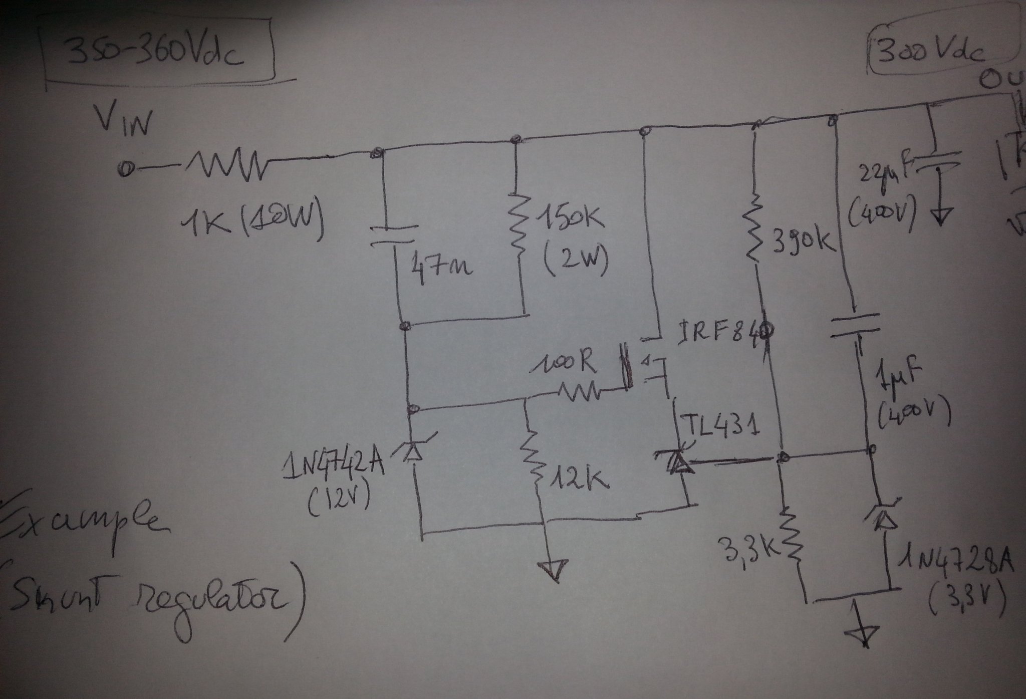

Side question, any benefit to using a shunt regulator like this instead (albeit with higher overall current demand)?
My I(tot) need would be <50mA.
Shunt regs have their pros and cons, and are a realistic option for relatively low currents, if you don't mind the highish quiescent dissipation.
In your example, it would be prudent to add series resistors to the 47n and 1µ caps: in HV circuits, direct connection to semiconductors should be avoided
