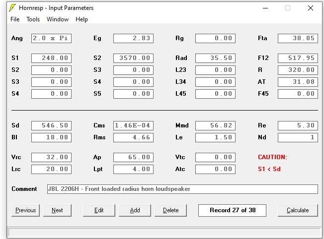

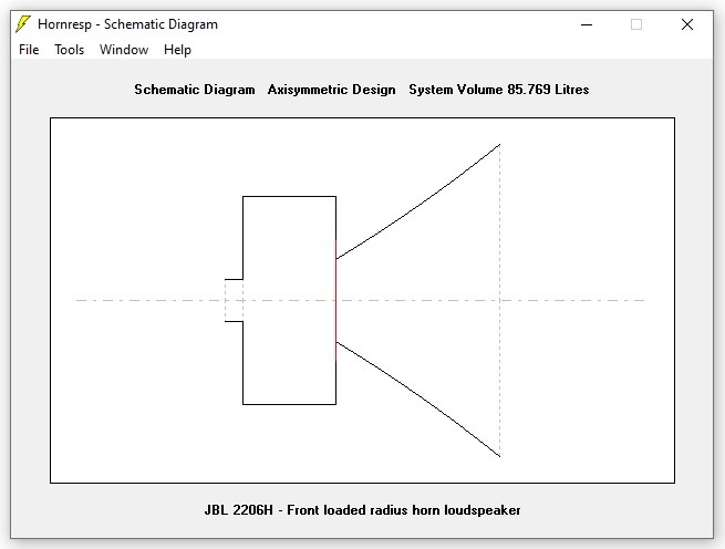

For purposes of learning, can anyone please help identify errors with my attempt at inputting a single vented M80 in Hornresp?
M80 is approx 20"H x 27"W x 14"D. If it matters additional 1/2" flat lip on either side and 1" flat lip on top/bottom. Throat is 7" diameter.

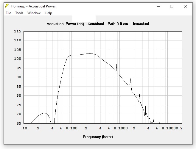

Can the the 6dB dip mentioned by @weltersys be manipulated if Vrc is deliberately small and Fb is high?
Want to understand if these parameters are close or way off.
Yes, by choosing a highly underdamped bass reflex alignment, it's peak around Fb can "fill in" the roll-off below the horn's Fc.Can the the 6dB dip mentioned by @weltersys be manipulated if Vrc is deliberately small and Fb is high?
The underdamped bass reflex output lags the horn by one cycle and rings on after, so transient response is not nearly as good as a FLH.
Thank you @weltersys, again point taken. Your expert insight is much appreciated.
It's clear to me now why my Hornresp example above is going to sound poor, however it could make for a decent 80Hz tuning fork!
