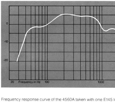

The A7 horn is similar to the JBL 4560, provides ~ +5dB gain from ~200-800Hz.In my case, 2 x B&C 12MH32s per side were planned for use in a FLH design similar to Inlow spec FL midbass horn. I was initially going to use a single 12PE32 per side, but started thinking about trying the altec A7 expo-reflex design instead.

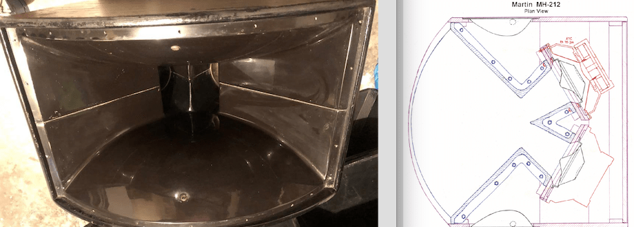

Short depths require some bending. The old Martin MH-212 "Phillishave" was an early example, but didn't make much below 250Hz:I have up to just under 30" enclosure depth to work with. Not sure if that's possible with the Inlow horn, even with the extra driver per side allowing a shorter horn.

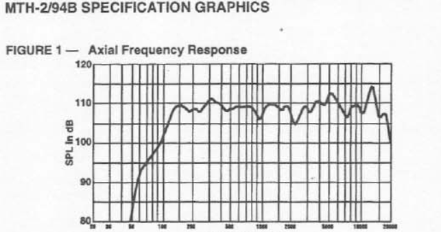

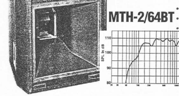

You could base a design on the EV MTH horns, 30" cabinet depth, using a side entrance phase plug and reflector to extend the dual driver horn throat.
The MTH 2/94 response looks a bit better for your application:
The sensitivity would be near the A290s, a 2x12" could easily outrun it at 500Hz.

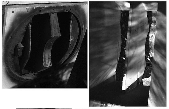

I've used a similar simple phase plug on EVX 150 15" with an 800 Hz crossover, even a random passerby my trailer shop could tell it sounded better "with" than without.

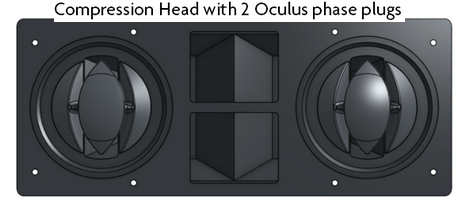

Dave Gunness went on a step from Dave Carlson's patent invention with his "Oculus" compression head:
For a 500 Hz crossover, that level of detail in the Oculus isn't needed, but the extra turn adds more horn length, it could get closer to 100Hz in a 30" depth.

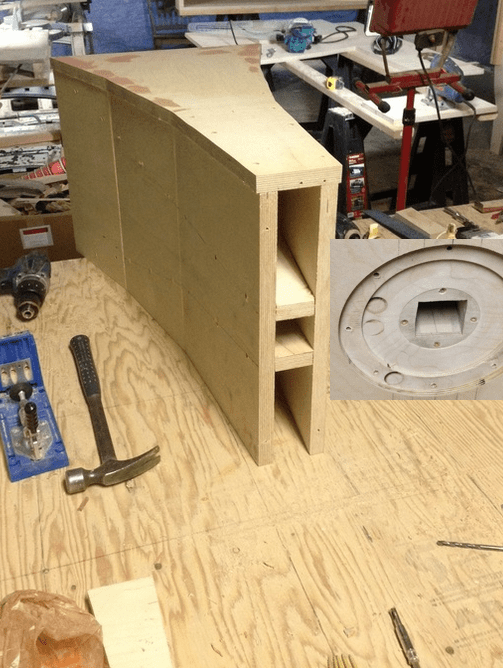

The phase plug isn't that difficult to design using the driver's cone as a mold. Some plastic wrap over the cone to protect it and epoxy resin will make a perfect copy of the cone profile. The passage ways through the phase plug can be duplicated using foam wedge inserts.

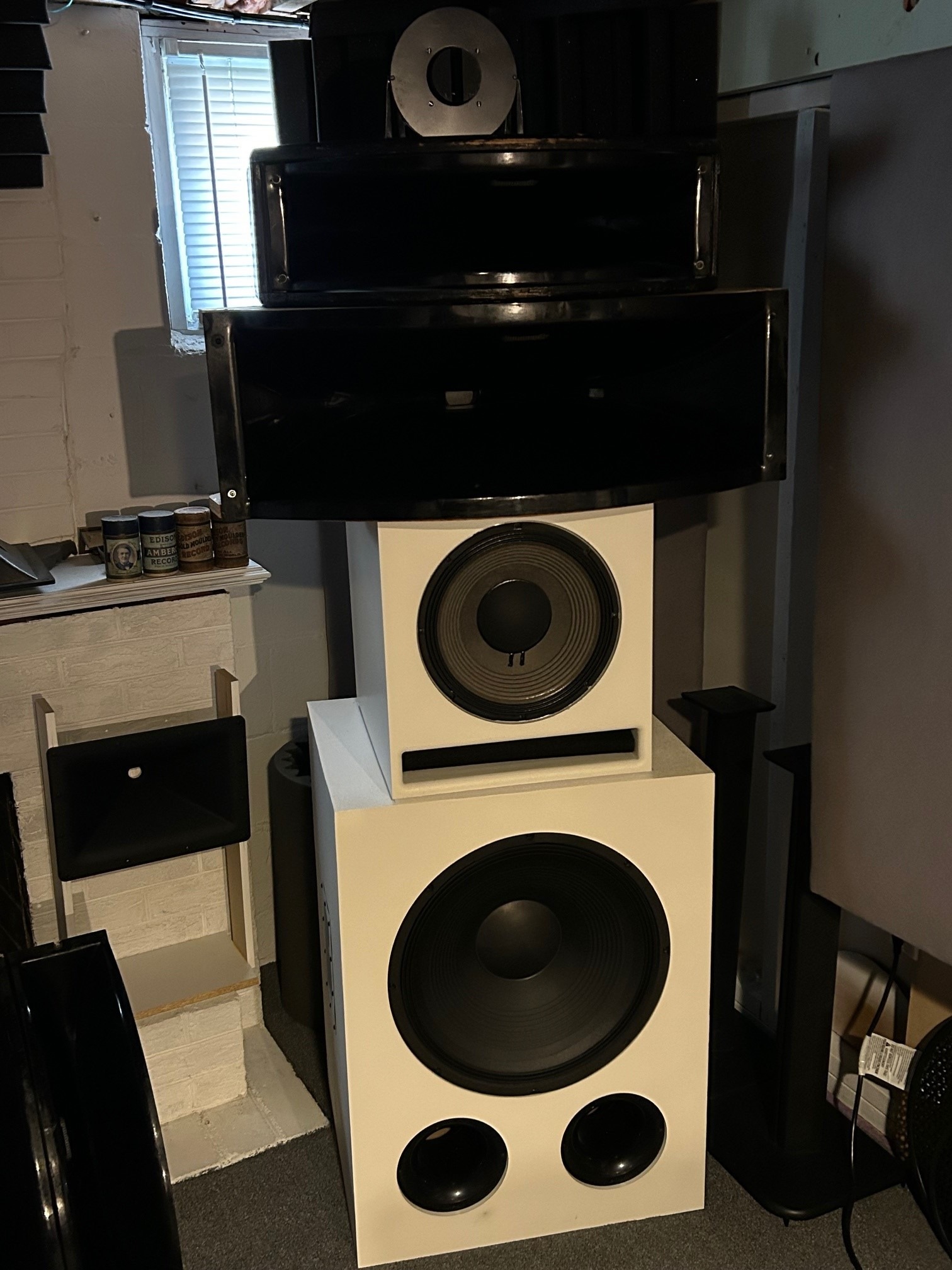

@profiguy do you have any preliminary dimensions in mind of what you plan on building? I'd like to try something similar for my next project.
2 x 2206 per side (target 75Hz-500Hz) in an expo-reflex design underneath large radial horns. I have 4 x 2206H and a pile of Community M80 horn flares but the rear compression caps included are extremely small for a 12" driver. The M80 flares are 28" W x 20" H x 14" D. Tried 1 x 2206 with compression cap full of denim insulation and measured approximately 160Hz-550Hz usable range, 2206H doesn't have rising response but could integrate OK at 500Hz.
I want to try vertical double stack, build vented rear chambers and perhaps add large extension mouth on front. Goal is to extend low end by one octave. Not sure about my HornResp parameters but was going to start with 32L (1.13 cu ft) chamber tuned to 75Hz.

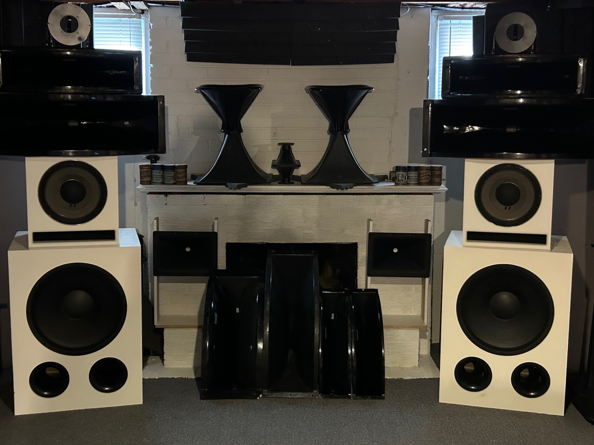

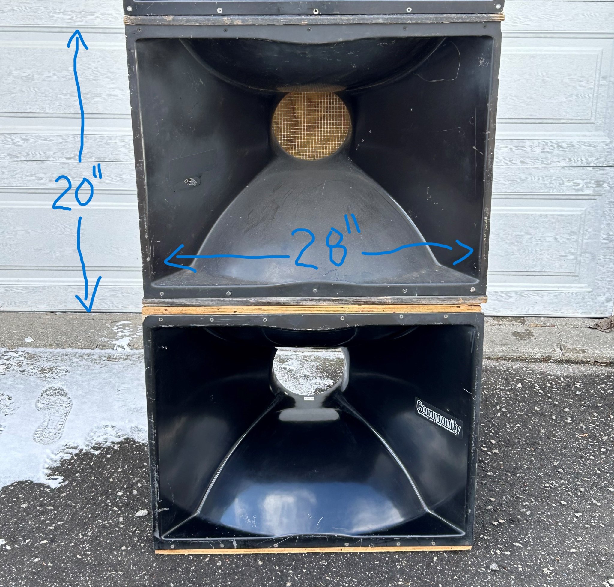

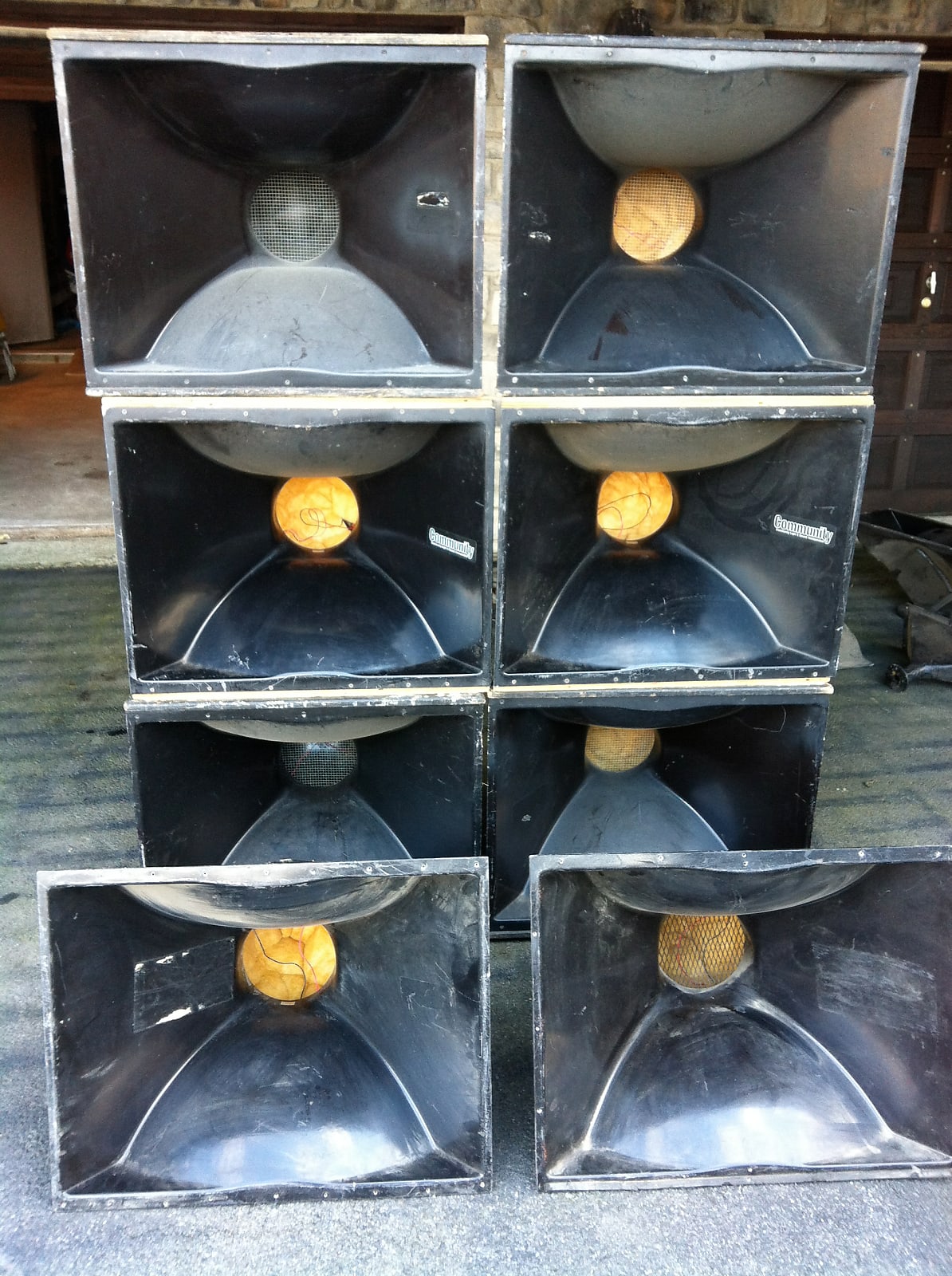

@AE13 Wow, looks like you bought out someone's PA there. I used some of those flares in a large club many eons ago. They need alot of EQ to smooth out with most typical drivers, plus they have a considerable amount of ripple and need more WG depth for their intended cutoff. I'll have to do more math and get back to you on the rest of my plans. Lots to think about here...
Forgot to mention, my intended WG depth is just over 30 inches with the chamber for the straight profile. I don't think you'd get away with less than that for a < 100 hz cutoff unless you're ok with more ripple. Art mentioned a dual driver version with a turned profile using a sideways turned manifold. I'm looking at a 10ft mouth circumference for a 80 hz cutoff in a 2 pi field. The throat area for one driver is around 125 cm^2.
🙂 100% bang on ... I did buy out retired PA guy's garage full of old Community Light and Sound horns and flares. Price was very fair and gave me lots to experiment with at home. The large radial horns were a complete game changer in my setup. This DIY journey led me to understand I prefer the sound of large format horns vs smaller modern horns/waveguides. I can try to build anything as long as I can fit it through a doorway and bring downstairs to basement (aka man cave). Interested to see how your plans evolve.
Throat on the M80 is 7" diameter, which I believe equates to a low compression ratio. Considering about 14ft mouth circumference (3ft W x 4.6ft H). From lurking around various horn threads I recognize the depth of the M80 was a limiting factor for my target range.
It's my understanding that M80 with EVM12L was used from 150-300Hz up to 1000-1200Hz back in the day.

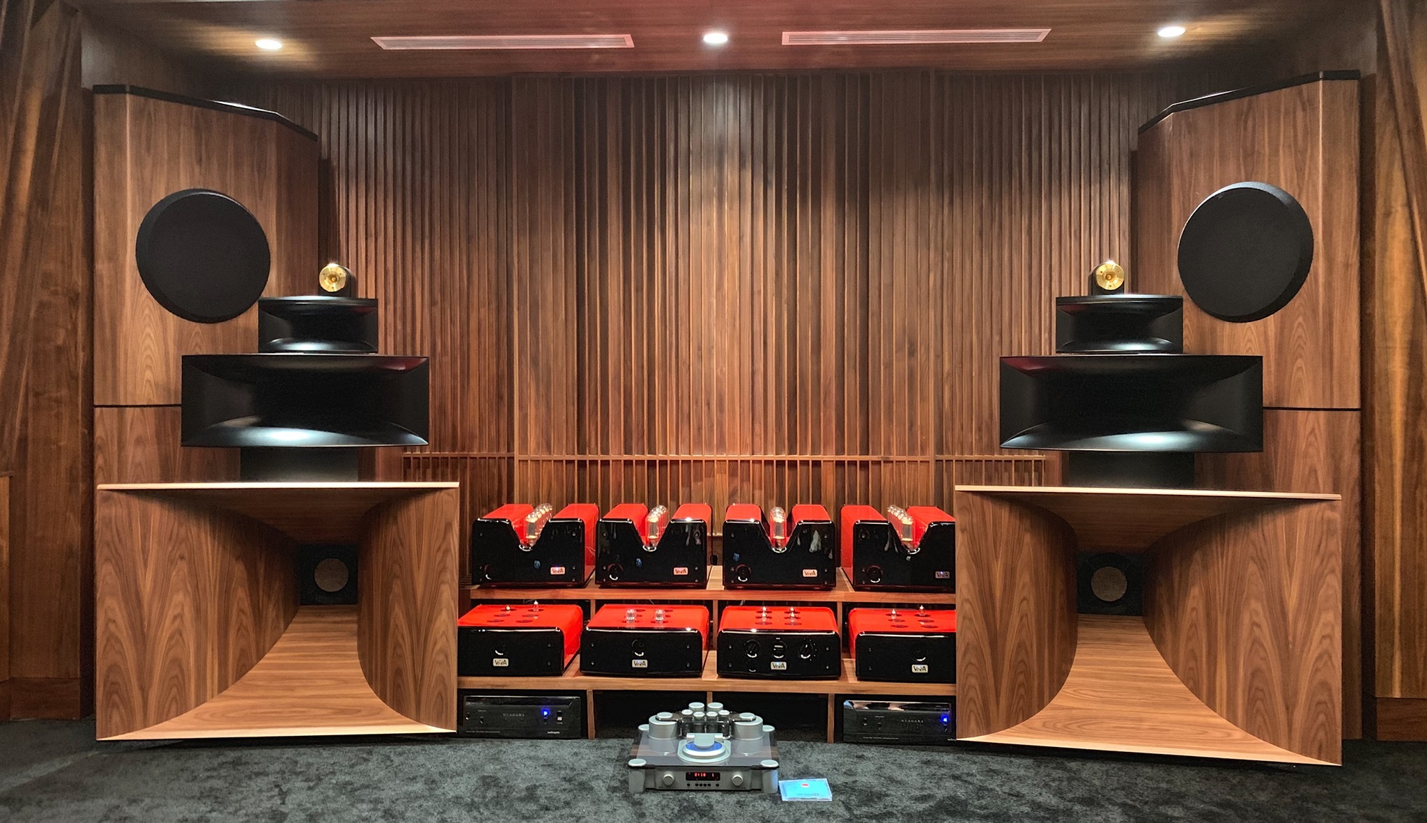

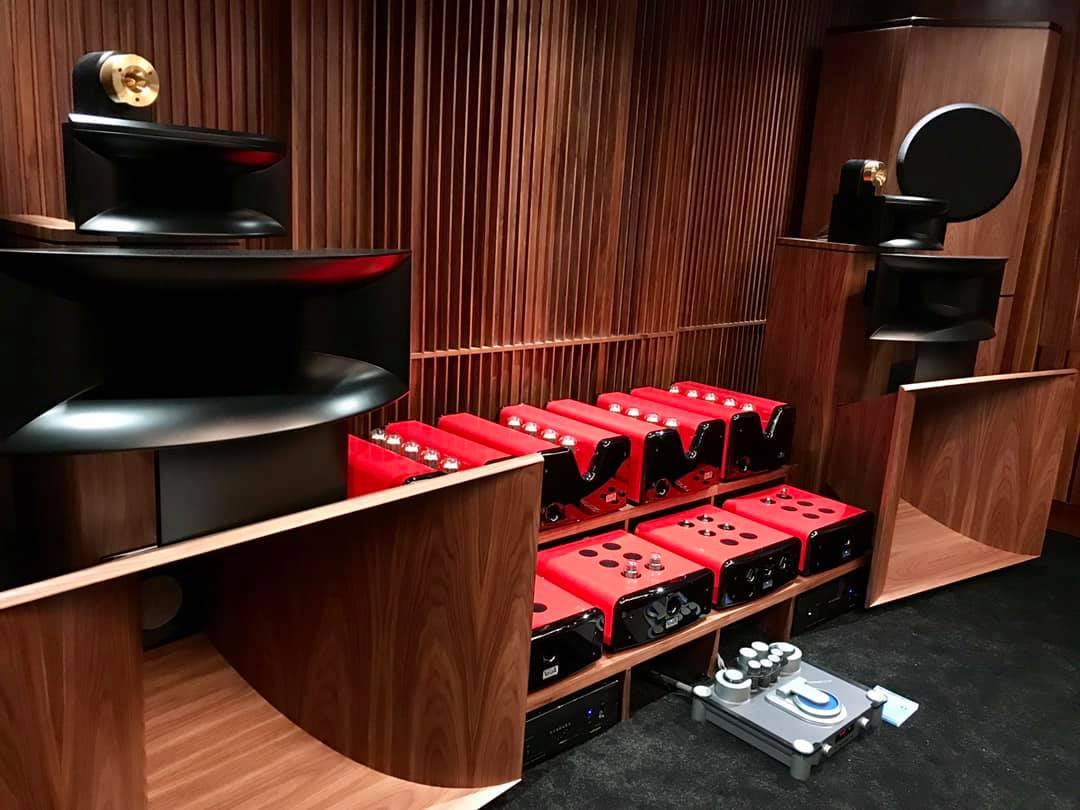

Viva Audio Master Horn is the current inspiration. Midbass horn appears to be about 30"-36" deep (mouth to throat).

As to overall dimensions, my main criteria is depth. I should have enough width for 100 hz cutoff.

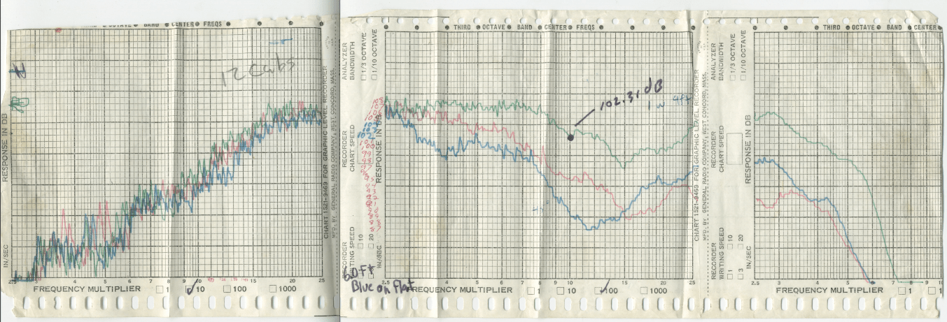

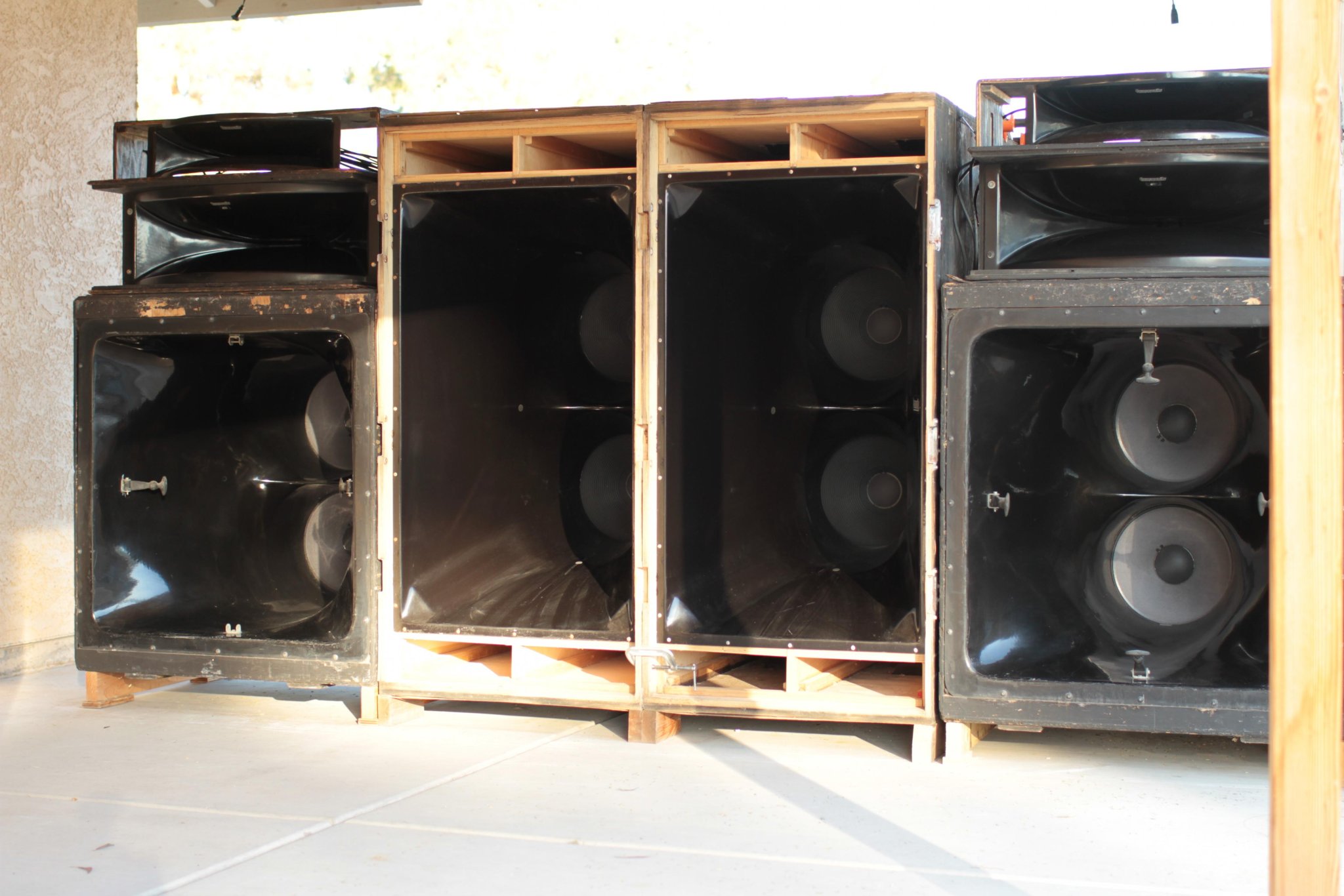

A 2x12" response can be quite good with no phase plug to 800Hz as can be seen in my 1979 PA system chart.The phase plug isn't that difficult to design using the driver's cone as a mold.
The first 1/2 WL bell breakup mode on a 12" cone driver is roughly 800 hz. It should be good to 1000 hz with a good phase plug design according to my basic calculations.
The drivers were the original 1970s EVM 12L series, which were rated for 100 watts sine wave, but +3dB sensitivity over the 200 watt 1980s 12L Series II, and later "300 watt" (EIA RS-426-A 1980) 100dB 1/w 1m.
I still remember when the power rating doubled, but the sensitivity went down by -3dB, but can't find a spec sheet...
The chart shows flat on-axis (green) response from 170Hz to 800Hz, measured at 4 feet.
1/w 1m sensitivity is over 107dB.
The red line is measured 45 degrees off axis, -7dB@800Hz with the drivers oriented vertically, horizontal dispersion.
The blue line is the vertical dispersion, -12dB@800Hz.
The 2x12" low mid cabinets measured in the above chart external dimensions are 45" x 22.5" x 30" depth.
The horn throat exit is ~5.75" wide x 11" tall.
The horn depth to the speaker baffle ~22".
Art

The 1979 fiberglass 2x12" low mid (and the 2x15") in post #13 were exponential horns.
The top, bottom and center divider sections were flat pieces other than the fillets around the speakers.
The left and right exponential curves could be approximated with two straight sections, as in the second picture above. The two conical sections are nearly equivalent to the expo, no bending required.

The back chamber shared by the two 12" drivers was ~80 liters, not very small.Would it be correct to assume the back chambers on these horns were all relatively small?
The later generations of horns we built used no corner fillets and all straight plywood sections.Is there anything to gain going through the hassle of transitioning and smoothing the corners of the throat entry into the WGs?
Only had 1/3 octave RTAs to measure with at the time, but our hearing was still pretty good, and we didn't notice any difference.
Even though no more of the fiberglass bass and low mid horns were built after the initial 1979 run, it was about ten years after construction before we put the horn molds in the dumpster..
The center wedge improved conformity to the expansion profile and frequency response linearity, but don't know it's comparative effect on vertical dispersion, as I never made any dual or quad driver horns without them.Would it be correct to think adding fillets between the driver throats would help with vertical dispersion?
Bruce Howze was building fiberglass bass horns around 7 years before me, he always put a center wedge in his Community Light and Sound horns too 😉
