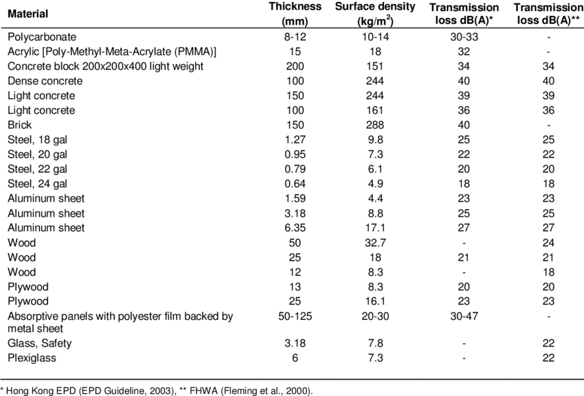

For the sake of completeness, allow me to define 'Transmission Loss' (TL).Do you know where I can find data on transmission loss?
Since TL depends on material, density, thickness and frequency, finding data that directly compares the TL of different materials is proving difficult.Transmission Loss is a measurement of the dB (volume) difference on either side of a wall. Let's say we have a 100 dB tone on one side of a wall. Pretty loud. We measure this same tone on the other side of the wall and find we have 75 dB. So we would say that at this tone or pitch, we have 25 dB Transmission Loss.

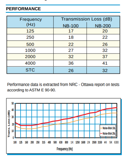

There's some data for this stuff NoiseBlok, Mass Loaded Vinyl (MLV), Noise Barrier Roll Toronto Canada

The TL of a material simply tends to rise with frequency.It would be nice to see the materials in your list at different frequencies.
