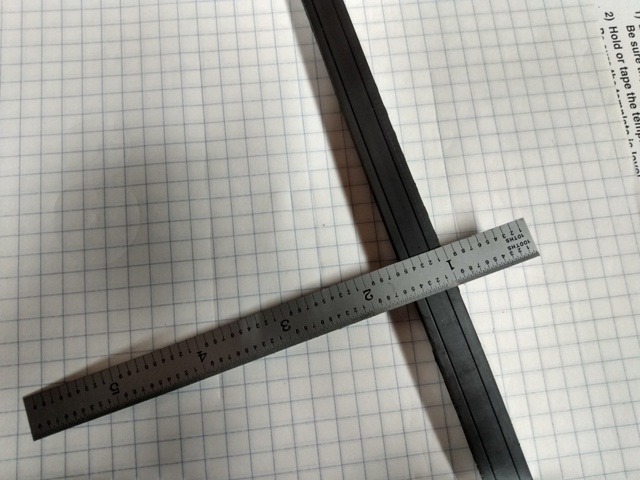

I received my Rochester magnets today. Seems pretty strong for rubber magnet material. It's magnetized correctly anyway. Its 5.2" wide with two grooves near the edges. One side is at .120" and the other is at .150" from the other edge apparently to facilitate slitting it lengthwise. We'll see how it works out.
for any one that wants i got roles of 50 meters for sale. 100 euro ex VAT ex shipping. for those that want to play around with them. i buy them bulk from a wholesale company that does not sell to private persons. and it is the rubber magnet i used in all my projects. you might need to cut them to size in width depending on the metal you want to use. i usually cut it down to 7-7.2mm when using R3T5 perf metal. my first planar used the magnets as is 8.5mm wide
