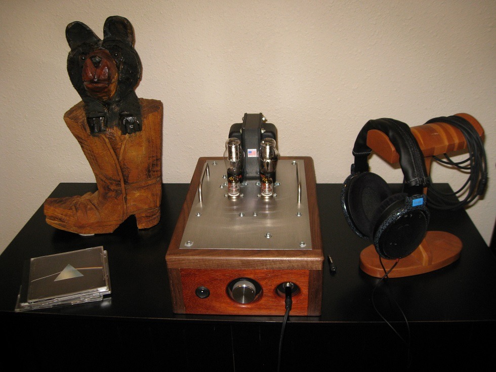

Your OTL amp - what is it out of curiosity?
It is SE, with custom ONetics transformers (now unobtainium) mounted underneath top plate. The circuit was designed by Rene' Jaeger, tailored to the 300 ohm load of the HD600's. The large tubes in the rear are 0D3 v.r. tubes, and the triodes in front are 5842. I laid out the components and built the chassis. The top plate is aluminum, the wood base is padauk with walnut edges.Your OTL amp - what is it out of curiosity?
Very happy with the combination of amp and headphones. 👍

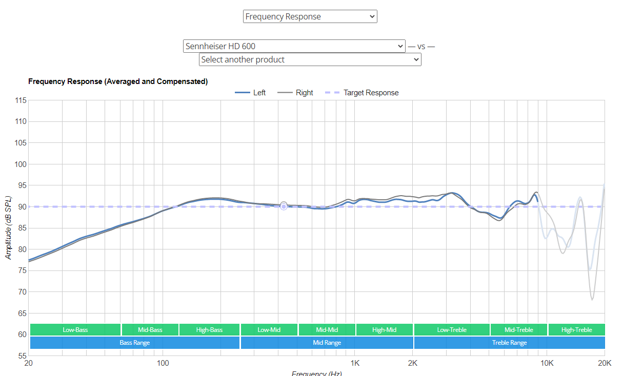

Thank you for the responses. I took a look at the HD600 on rtings.com. The frequency response not as flat as I would like. I did find an interesting site that audio compares MICS: https://www.audiotestkitchen.com/
Headphone responses should NOT be flat! They should be closer to the Harmon curve.

Yes, the environment is missing with headphones. So is the crossfeed. But phase and distortion are generally good, distortion decent. The hope (I think) is to find a pair of cans that have a neutral tonal balance on your ears, and use them as a reference.
Keep in mind that Harmon is a preference curve not a flat FR. And it's not what everyone prefers but what most people prefer.
