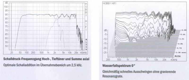

Can you find the PHL woofer in stock?
Remember, that flat response was done with at least 8 filters on the woofer and 8 on the horn, if I read his post correctly. REW does EQ like that in auto mode.

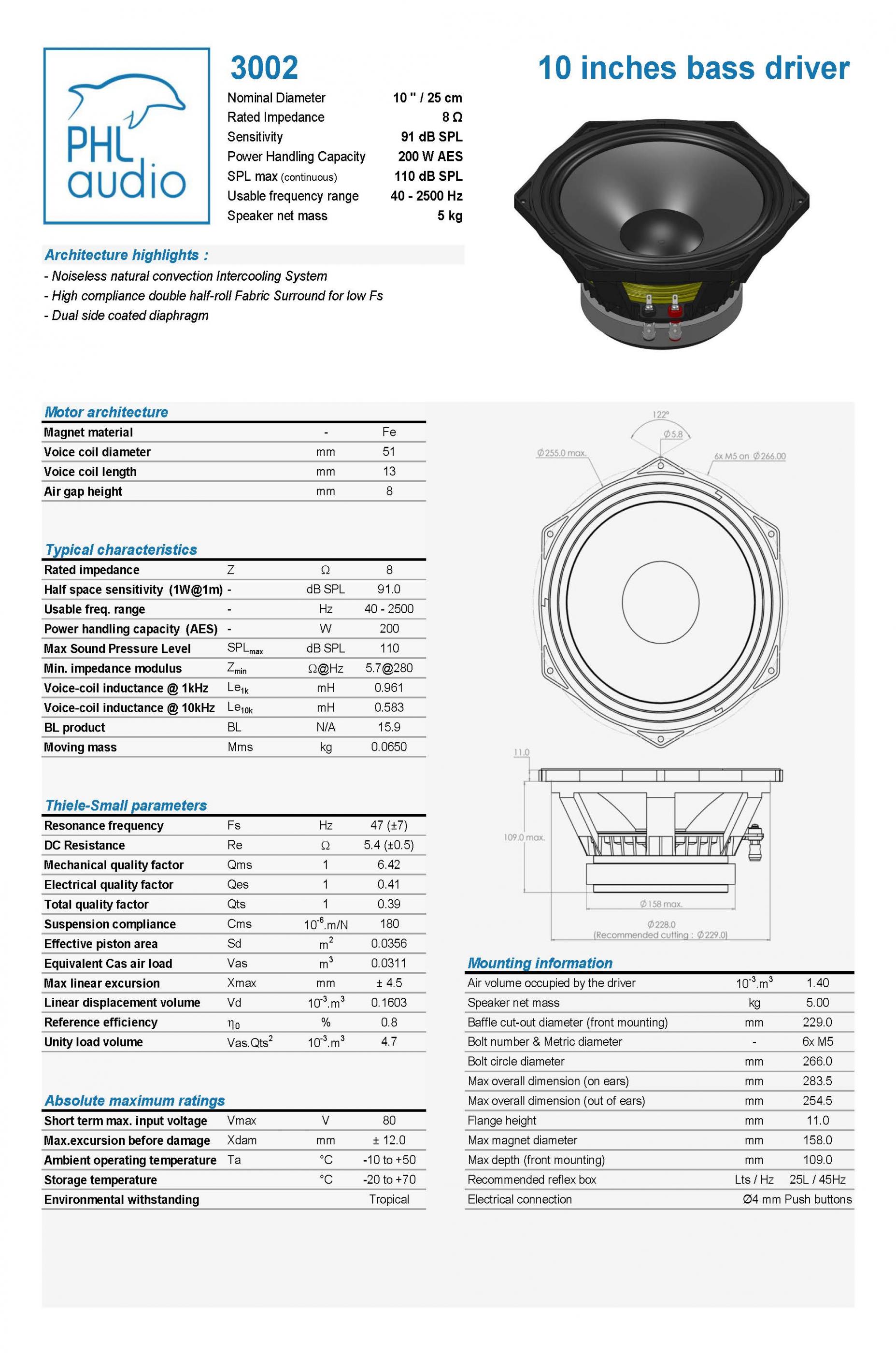

The 3002 is available to order for € 214,03.
What is your opinion of this driver?

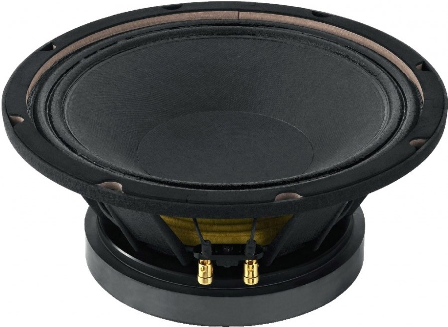

Half the price, not so fancy product name but a good measured result in HobbyHifi. The specs are basically the same with an edge of BL, cone area and linear stroke of the lousy Monacor;o)
MONACOR: SP-10/250PRO
Good one!
While the Monacor doesn't match the low end extension of the PHL, it appears to be better throughout the midrange.
The response is ultra flat up to 1.5k and it's also a bit louder.
If you plan to use seperate subs, the Monacor would be the better deal.

Use a bigger box, high shelf it down 70-100Hz, with 7mm stroke there's head room. Extension will never be down to 30Hz due to the Monacors lower q but close enough. HobbyHifi's measurement is with 40L minus driver and horn.

I ask myself why they choose so highFs in the low...BR load are not so good when you try to get a load lower rhan the impedance peak allows...transcient are less good for the few hz winned in the low end, no ?
...or they EQ so much wirh embeded active dsp that the T&s are perhaps not really revelant ?

- Flatter than flat. PHL 10" and Beyma 1,4"
