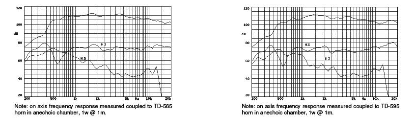

I just started my MLS-measurements and discovered that there is any thing near flat.
I must say that I am now understanding more of the measuring technique, and know now with FFT screen length to choose how to get reliable results. So my first results can be improved.
So I have my doubt about the result??? Because it seems you made the perfect loudspeaker.
It can't be the woofer and the HF-driver is that perfect flat even at beyma spec. So unbelievable result.
What are the measuring conditions length FFT screen. 1/3 oct filter ? smoothing??
Or does the DSP the smoothing
attachment beyma 1.4 HF driver

Helmuth said:Because it seems you made the perfect loudspeaker.
Yeah, and that's what worries me! 😀 To see that kind of FR from an 80Lbox, 10" woofer and horn, well..... I think we are all a bit surprised and amazed. There must be more to it than that - right?
I've had my eye on the DCN23 for some time, looks like a nice bit of kit. The driver software is a little pricey, but it's a cool tool. One "should" be able to do the same thing with other digital crossovers.
Still would love to see the EQ graph and some off axis stuff.
Cool project!
The perfect speaker?? Hahah.. I dunno....
There's no hokus pokus going on in those graphs. Just a good mdf box, L-R filters, time-aligned and equalized. I have only the simple freeware of the DCN23 crossover. I measure with a calibrated Clio system. So yes "panomaniac" you could get this resault with any other digital crossover. (only worse sound 😉 )
I have 15 years of experience being a recording engineer so I know my freq's 'n' Q's... 😉
Our recording room is exceptionally great to measure in as well.
Helmuth: See pictures for smoothing, etc. The DSP doesn't do any "special smoothing" except equalizing. Which is a manual sort of "smoothing" though...
