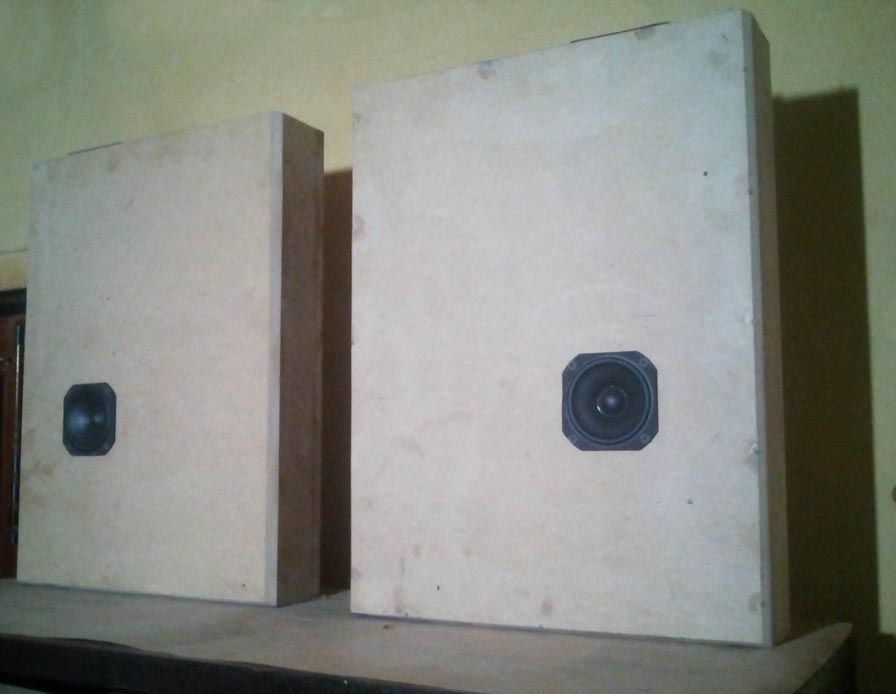

Vifa TC9FD speaker has arrived.
still wait speaker box
You mean you have to wait to start building the enclosure? Good luck.
My friend will build enclosure for me.
Nice friend! 😀
Making it out of wood or foam core?
Using 12mm MDF board, if MDF board enough, also make tabaq box
http://www.coolcat.dk/bjoern/TABAQ BOX Cabinet build.pdf
foamcore only in big city, must buy in large quantity 😡
12mm MDF board (122 x 244 cm) only $11
unfinished vifantastisch, source PC Soundcard change op-amp with lm4562 power amp audiobah tpa3116 / tda7297 unmodded, sound good, detail, bass is ok, but too bright to my ears
Did you put the MLTL ports on or are you running it open ended like the original Vifafantastic? It sounded quite balanced once the MLTL ports were installed and playing against a wall.
hi xrk, would dayton ps95 drivers work in this box? looks like a fast and fun project to try out this weekend!! 🙂
Yes, the PS95 has a similar Qts, fs, and Vas (actually half of TC9) compared to TC9FD. The only thing to do is make the vent length adjustable and tune to taste.
I just ran the simulation of this speaker with the PS95-8, works perfectly and similar response compared to TC9FD - no need to change anything.
I built a set this past weekend with TC9's and foam. They are great for TV speakers...much better than any soundbar I've heard. I picked up some MDF, so I'll make something more permanent.
Good to see the PS95 may also work, so I'll try one of those.
