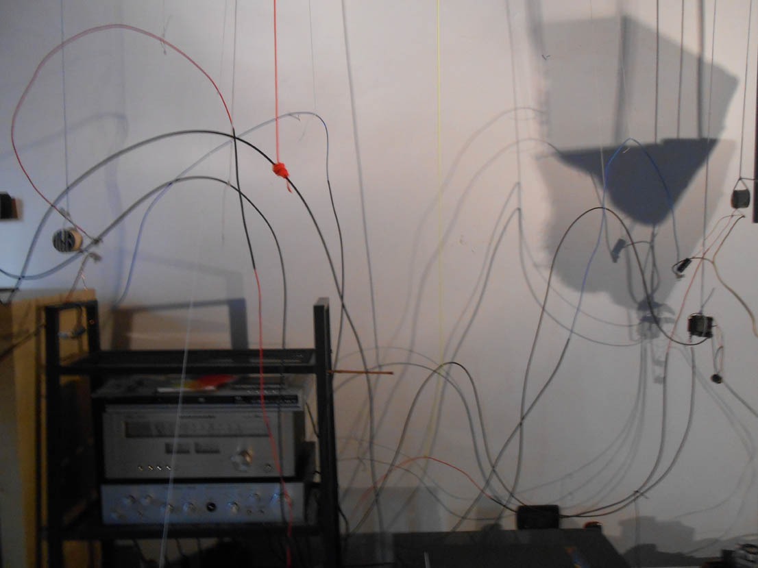

Look what I've found yesterday in an angle of my computer desktop!
