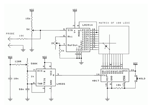

Flat Panel Real Time Scope
I would like to have something like the drawing
BUT with way more pixels.
Say 255 x 255
Perhaps addressable with 8 bit counter and flash ADC
Using either a converter to HDMI ? ... Composite ?
Or a graphics display .......
