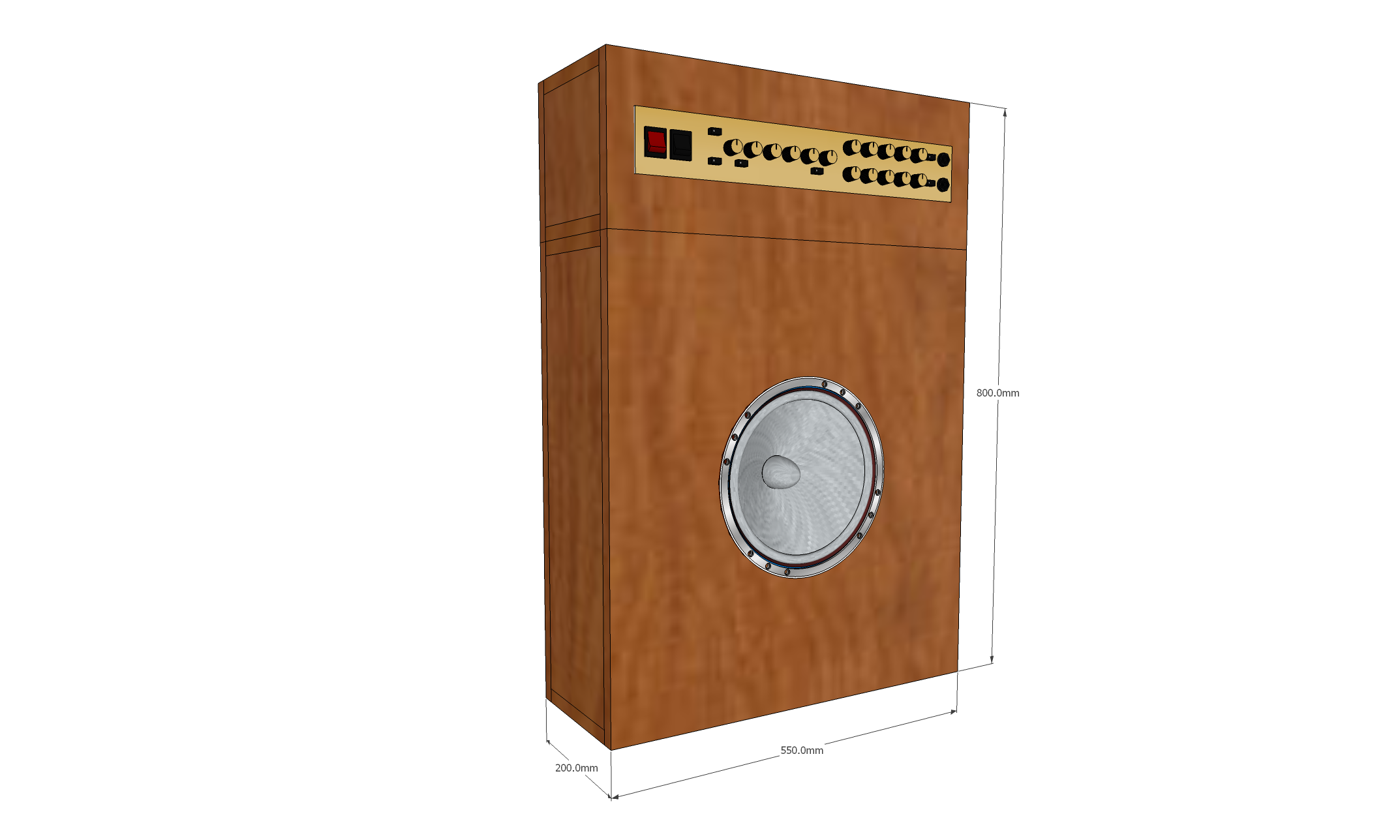

I have put together a basic drawing of the idea. Also, I put in a driver into the system that Printer2 said liked (I gave alisten to it on the WGS website) - WGS 10" Veteran.
I hae also used the information on the WGS website to calculate the cabinet port size. At this point I put in these parameters into the online calculator HERE:
24,5 - Diameter across the speaker cone including half of the cone suspension
110,86 - Resonant frequency of the driver
17,2304 - Q mechanical
1,9694 - Q electrical
1,7674 - Total Q of the driver
0,808 - Equivalent volume of compliance
And got these results:
62,14 - Calculated Enclosure Volume in liters
27,89 - Port alignment frequency
12,99 - 3dB Down Point (not sure what that is)
The problem is when I press the button to calculate single or dual port dimensions. Somehow single port is less than dual port. Is this supposed to happen? Im sure theres something that I dont know..
This speaker is too stiff for a bass reflex. The high stiffness swamps box effect. About the "best we can do" is a long falling bass with a minor resonance, which this calculator proposes for 28Hz, which is FAR below the guitar band thus useless.
That speaker is aimed at a large open-back cabinet, traditional Fender. The "too-high" Q of 1.8 will compensate the bass fall-off of a 24"-wide open cabinet well-enough.
What does stiff exactly mean in this instance? The plywood is too thick or the dimensions are too close to each other making the box very stiff? Im sorry I dont know if im getting it the right way..This speaker is too stiff for a bass reflex.
Can you elborate on this sentence, please? 🙂The high stiffness swamps box effect.
Are you offering an open back design? Im afraid it is not possible, because it will be fitted on a surface..The "too-high" Q of 1.8 will compensate the bass fall-off of a 24"-wide open cabinet well-enough.
> What does stiff exactly mean in this instance? The plywood ...
No. The *cone* suspension is stiff. Push on a cone. A Hi-Fi woofer moves easy. This class of guitar speaker, the cone is hard to move. The Designer proportions the cone suspension for an appropriate stiffness for the intended use. For a closed-box system, the box air adds stiffness, we want a low-stiffness speaker. For an open-back spealer, a limp suspension would let the cone "slap", we want a stiff suspension.

The *cone* suspension is stiff. Push on a cone. A Hi-Fi woofer moves easy. This class of guitar speaker, the cone is hard to move. For a closed-box system, the box air adds stiffness, we want a low-stiffness speaker. For an open-back speaker, a limp suspension would let the cone "slap", we want a stiff suspension.
Thank you brother, your explanation makes it very clear 🙂 Any speaker you would recommend?
Conventional HiFi/PA/DJ/Bass cabinet design tries to extend Bass response downwards and make it as flat as possible.
So the myriad cabinet designs available, with soft suspension closed box and tuned cabinets being specially popular; there are others of course.
None of that applies to Guitar cabinets because requirements are very different, and at the same time, speakers themselves are very different.
Stiff, harsh (by Hi Fi standards) , **LOUD** , typically with a STRONG peak (10/12dB) somewhere between 2500 and 3500Hz (which gives them "bite"/attack/definition) ... and no Bass to speak of, so concentrating on that is wasting time.

So if I understand this correctly, what PRR was reffering to was a subwoofer design instead of a guitar cabinet? Correct me if im wrong, but then it works out that a stiff cabinet and a stiff speaker actually go hand in hand with each other, if I do the closed back design?None of that applies to Guitar cabinets because requirements are very different, and at the same time, speakers themselves are very different.
Yes, this must give the speaker its unique tone and character. Are these calculations a representation of the driver I have provided (WGS 10 Veteran) or is it a speaker you like?Scary 108dB peak at some 2500Hz, huge dip at 1500Hz, response dropping **24dB/octave** above the peak, yet this is a KILLER Guitar speaker.
What software are you using?Standard "Box designer" software does not know what to do with them.
Actually I was thinking of a vent at the bottom to 'relieve' the pressure effects. Don't forget there are other speakers. I never used the Veteran in a closed box but I put the open back cabinet against a wall and it seemed to work.
......Scary 108dB peak at some 2500Hz, huge dip at 1500Hz, response dropping **24dB/octave** ..... Standard "Box designer" software does not know what to do with them.
All that wobble above 1kHz is "outside the box"; box volume has no influence on the highs (though low/high balance is a consideration).
What I see is that 'your' speaker has Q of 0.7 at 90Hz. So 90Hz is 3dB down from the general trend 200Hz-1kHz. In a large box this would be fine for guitar. Open-back, the resonance is unchanged but baffle-loss shaves less or more bass away; a range of acceptable (to guitarist) responses.
We generally want final system Q between 0.7 and 1.2. Flat to the lowest note and then let all below fade away.
The proposed WGS 10" Veteran is no-doubt a fine speaker but the very high Q of 1.78 means it is aimed at large open baffle (a popular guitar cabinet type). Messing with box does little, until we make a box about the size of the driver's shipping-box, which will push Q up to 2.5 (an 8dB bump) at 150Hz (carving off almost an octave of guitar low-notes). This may even be a great busking amp because it is the most sound in the least box.
