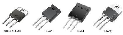

Gain is much better with Newer devices and Ft is also higher that is the good thing. Total power dissipation more limited to the flat plastic things
You wont see Max ratings of 200c like T0-3. Most will be 150c and Most no more than 150 to 180 watts
Except for a few exceptions and likely more with a search. Common Big Boy packages will be T0-264 to support 200 to 230 watt transistor
So almost to the usual 250 watt or more metal cans of yesterday. But again Gain is way way better, much less current to drive than old T0-3
Many shrunk to slightly smaller T0-247 package still good for power and little wimpy small plastic stuff, still common T0-3P-3
and million other annoying numbers I cant keep up with. Basically small power transistor obvious when you see it. And obviously not a TO-264
For a low watt driver from 8 to 15 watts metal can T0-39 moved to plastic classic BD139/40 it is still T0-126 For Higher voltage ratings
And a heavy duty 30 to 40 watt Driver you would see with a Metal Can T0-66 will now be T0-220
Anyways dont care for much more than these for power Transistors
