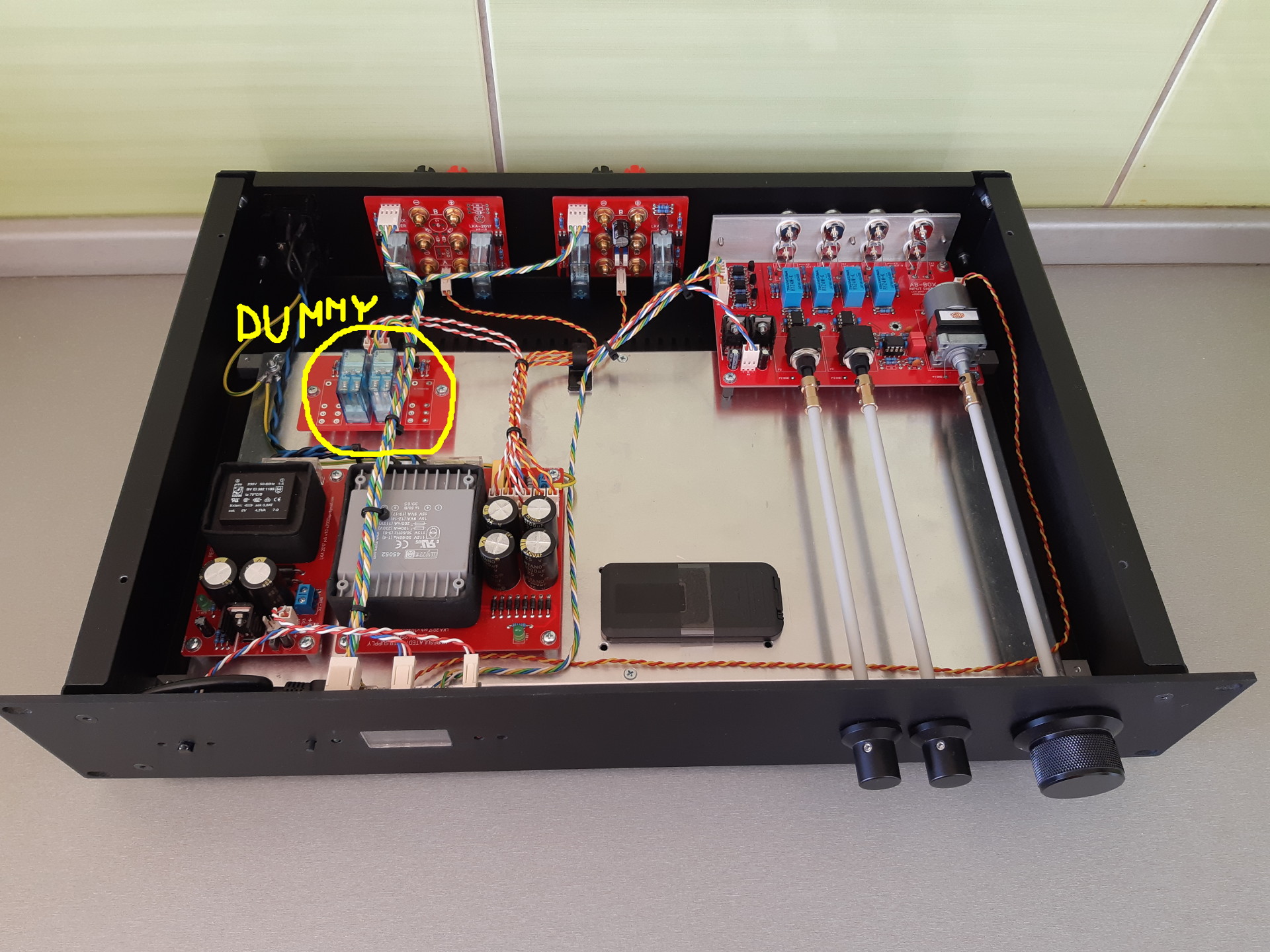

This is my true ABX comparator.
AB-BOX : The ABX Comparator - Google Photos
I use dummy relays when switching A->A or B->B
