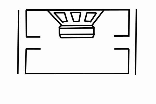

Here's the basic concept of invisible or magic ports for you. Basically the only neat thing about them is that you can look directly through the box and not into a black hole. So they look like they're not actually ports, but they are.
Its easier to fit a slot port into the box because you can actually build them into the box. True it takes up much more volume(3/4"MDF is much thicker than 3/15" thick PVC and of course a circle maximizes area for a certian perimeter) But if the box volume and how it is built are of no issue(One thing more common with DIYed designs) then it will be cheaper fitting a 10 foot slot port into a box than a 10foot PVC port
Forgot the pic
Very interesting. Their diagrams depicting turbulence appear to be about as accurate as those from the B*** marketing dept!
It looks to me as if it would be LESS effective than a regular flare, as it doesn't really tackle the problem of boundary separation at high velocity very well IMO. Instead it slows down the velocity by causing the rapidly moving air to increase in cross sectional area. However, at the exit there will still be eddies caused, and they would be worse than those of a regular flare if not for the fact that the velocity at this stage has decreased. Looks to me more like a showy solution more based on cosmetics than function.
Also the volume of the sub box is tiny for a vented box intended to get down to 20 Hz! There is no room for a vent, so I don't know what that thing actually is! Aperiodic? Doesn't seem like that is their intention ...
They talk about it as if it is some kind of dipole, with their mention of directional bass ...
I think it's more novelty than engineering, but perhaps someone else can shed some more light on this ...

I think I deserve FAR more credit for intelligence than that. If you want to make a statement like that, at least back it up rather than making broad sweeping statements like "these are highly regarded experts ..."
I raised some specific issues. Rather than respond to them in a specific manner you make only general statements.
I have not been misled by any "common marketing habits" which should be obvious. I see this company using misleading animated diagrams, which do nothing to help their credibility. In particular look at their diagram showing eddies caused by high velocity air movement in vent flares vs their nozzle. The airflow within their nozzle is shown to be perfectly laminar, following the profile. Within the flare, it is shown as moving in a straight line as if the flare does not exist. The flare rate of their nozzle is more gradual, hence it will remain laminar within the nozzle at higher velocity, however at the end of the nozzle the performance will be much less than that of a regular flare at its termination. As shown by Collo's experiments, the velocity would have to be low at this point to avoid chuffing, as at that point it would be like a very large unflared vent. At this point is relies purely on size to reach its performance goal. I would expect better performance of a regular flare of the same size.
So how is this misleading?
1. First look at the diagram with knob at position 2. The flare profile at this point is almost identical, yet theirs is shown with laminar air flow, while the regular vent is shown with eddies.
2. At position 4 on the knob, the air from theirs moves out in straight lines past still air, yet no eddies are shown! This is precisely how turbulence occurs in unflared vents!
3. Theirs is shown with many more arrows, where the regular flared vent is shown with less, so that they can draw exaggerated large eddies, and not really give an accurate visual comparison
In short they have selectively exaggerated the weaknesses of the conventional design, while hiding their own. But who am I to question the rocket scientists!?
