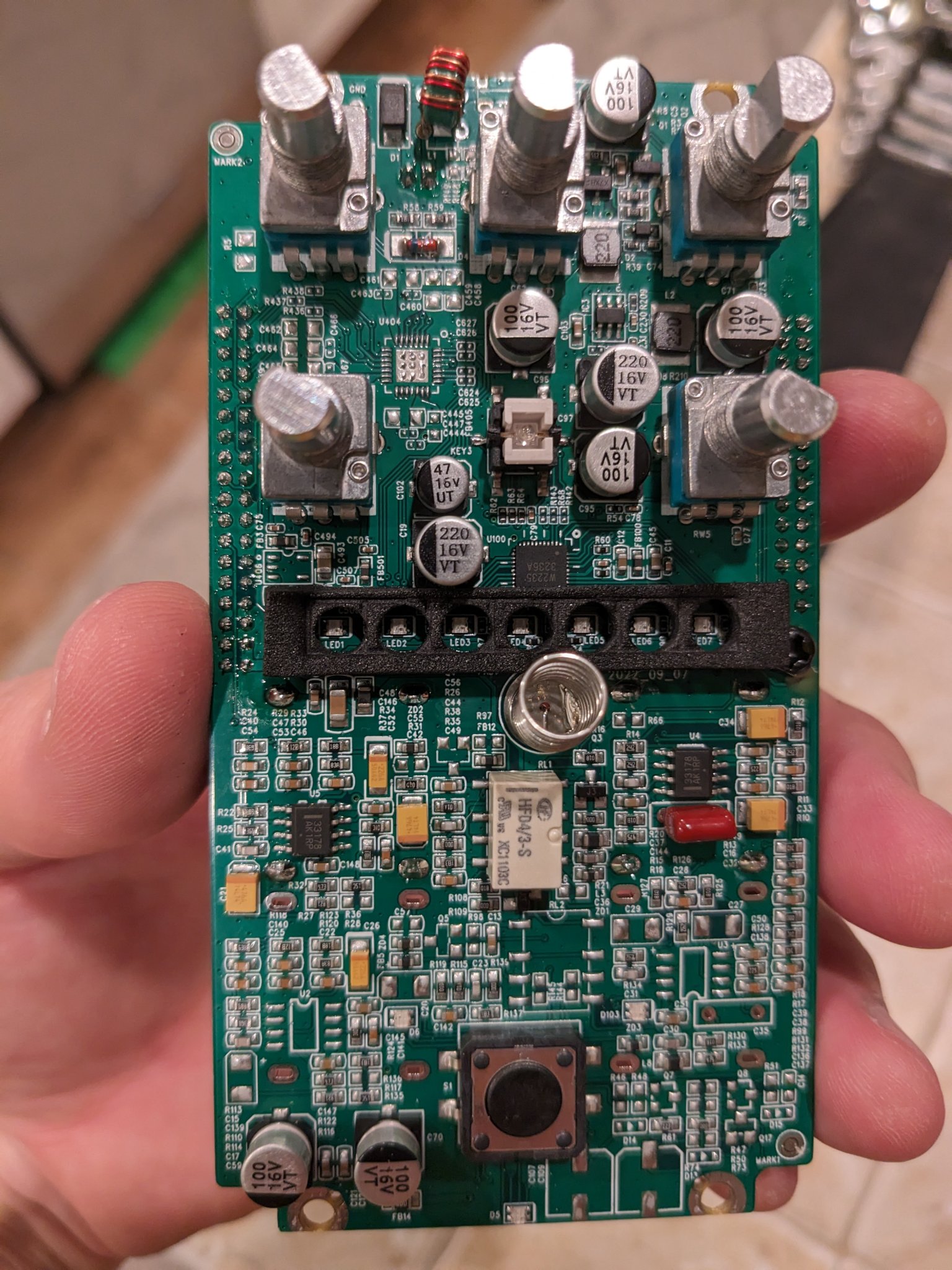

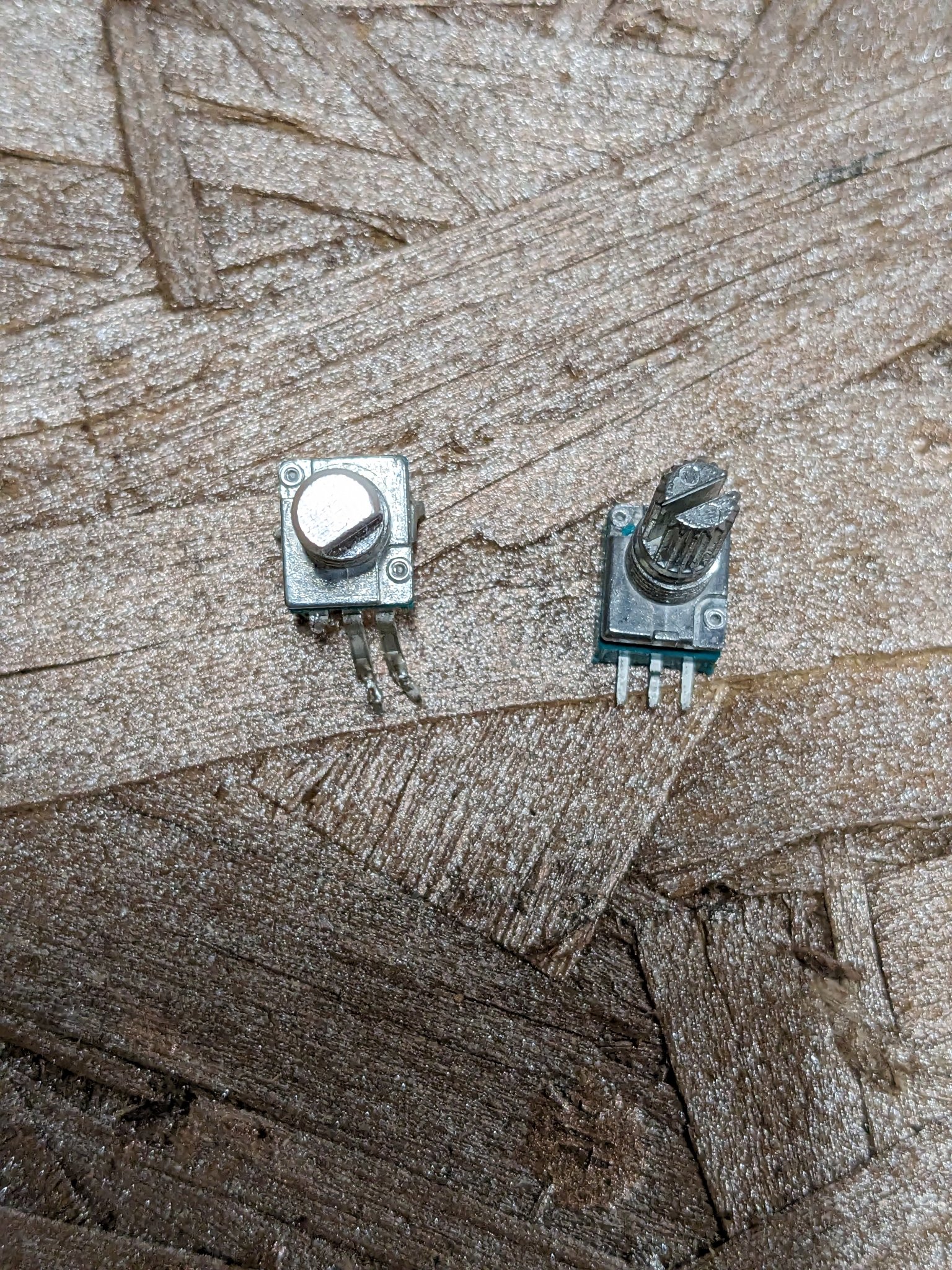

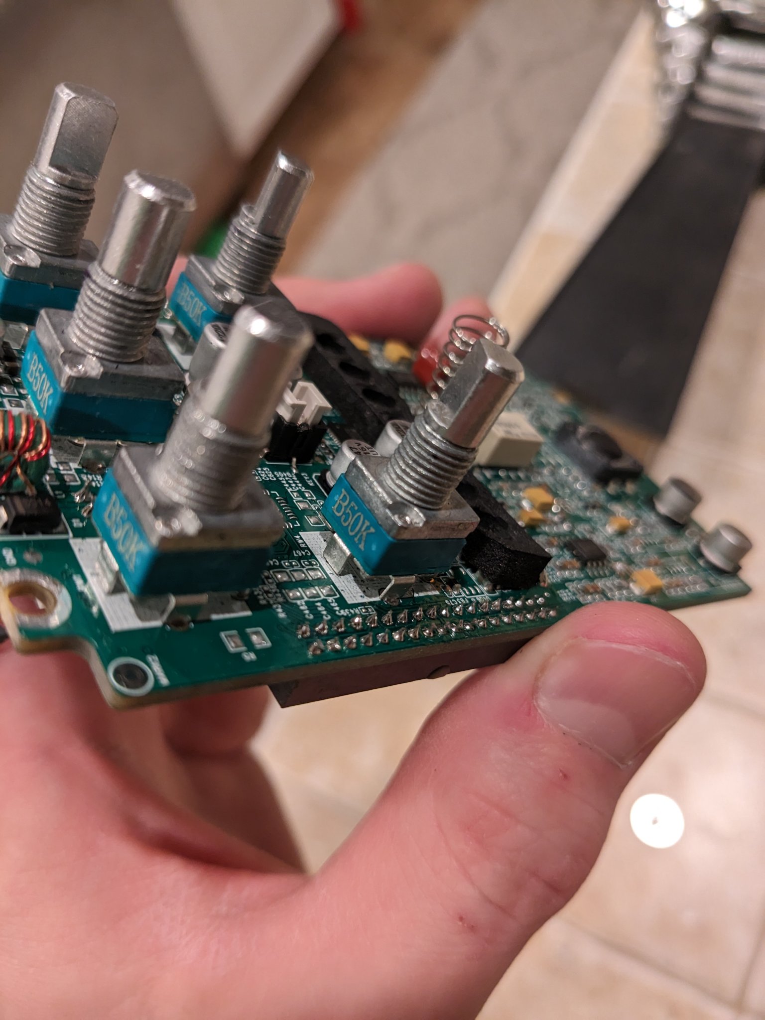

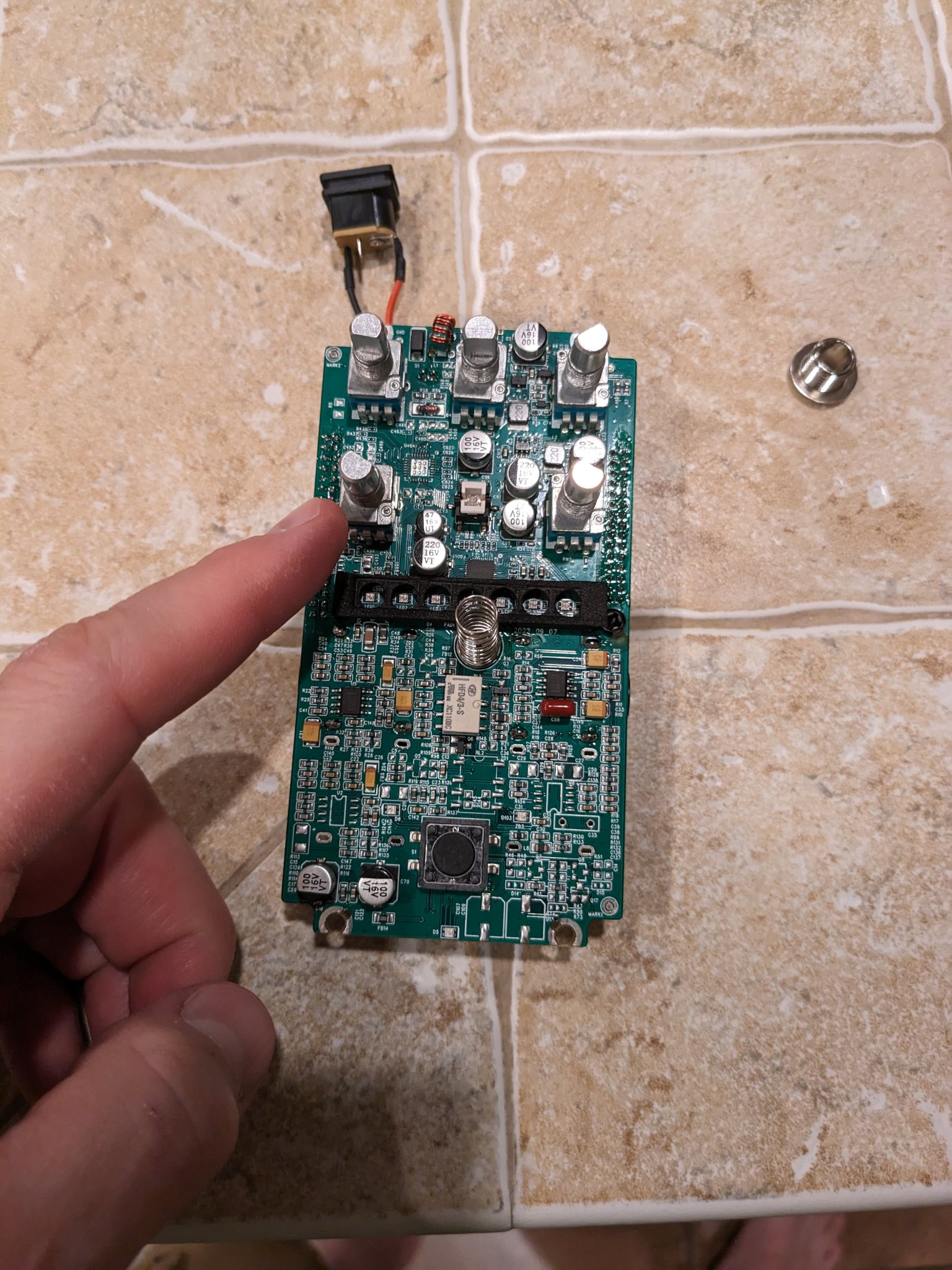

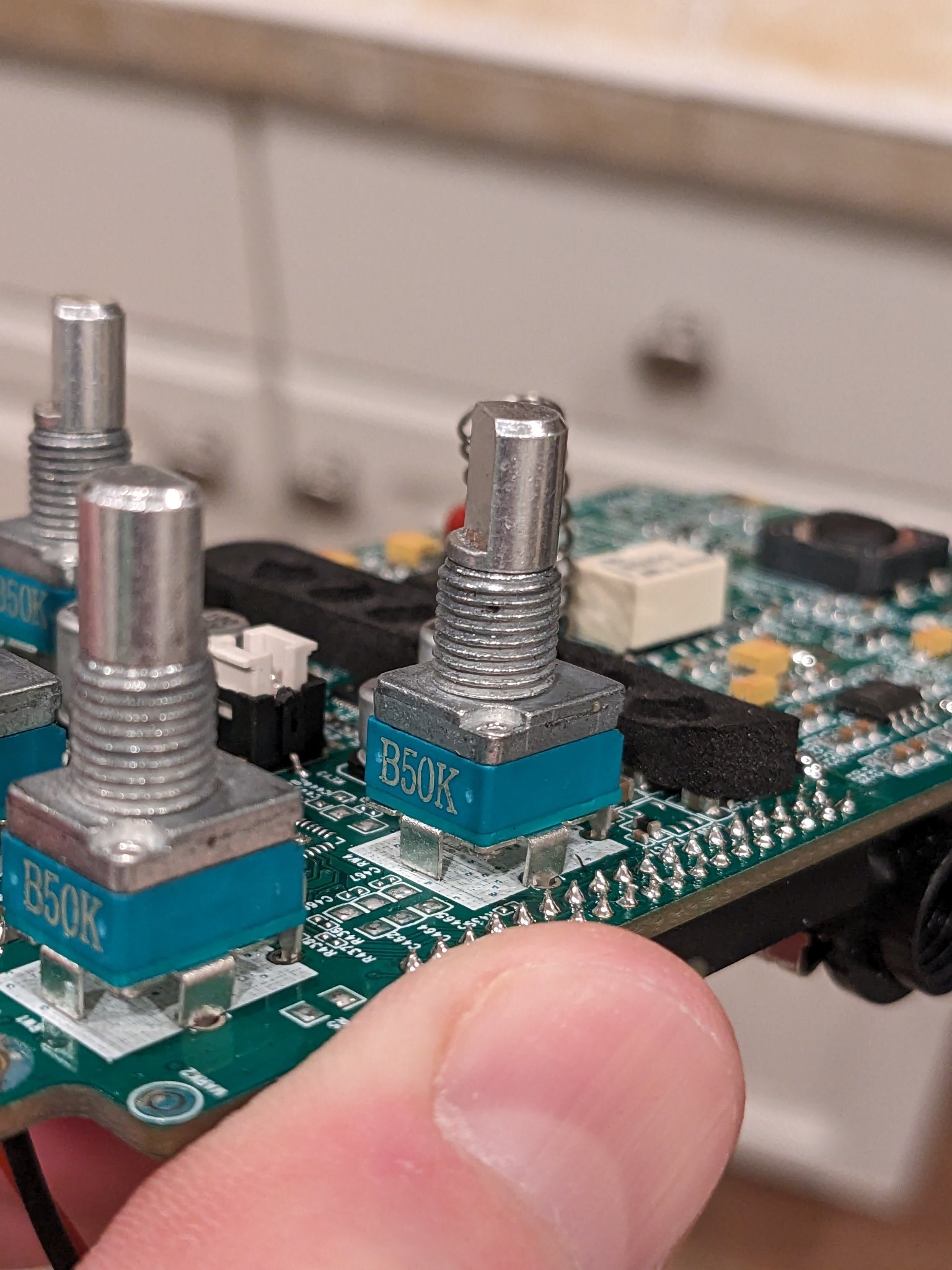

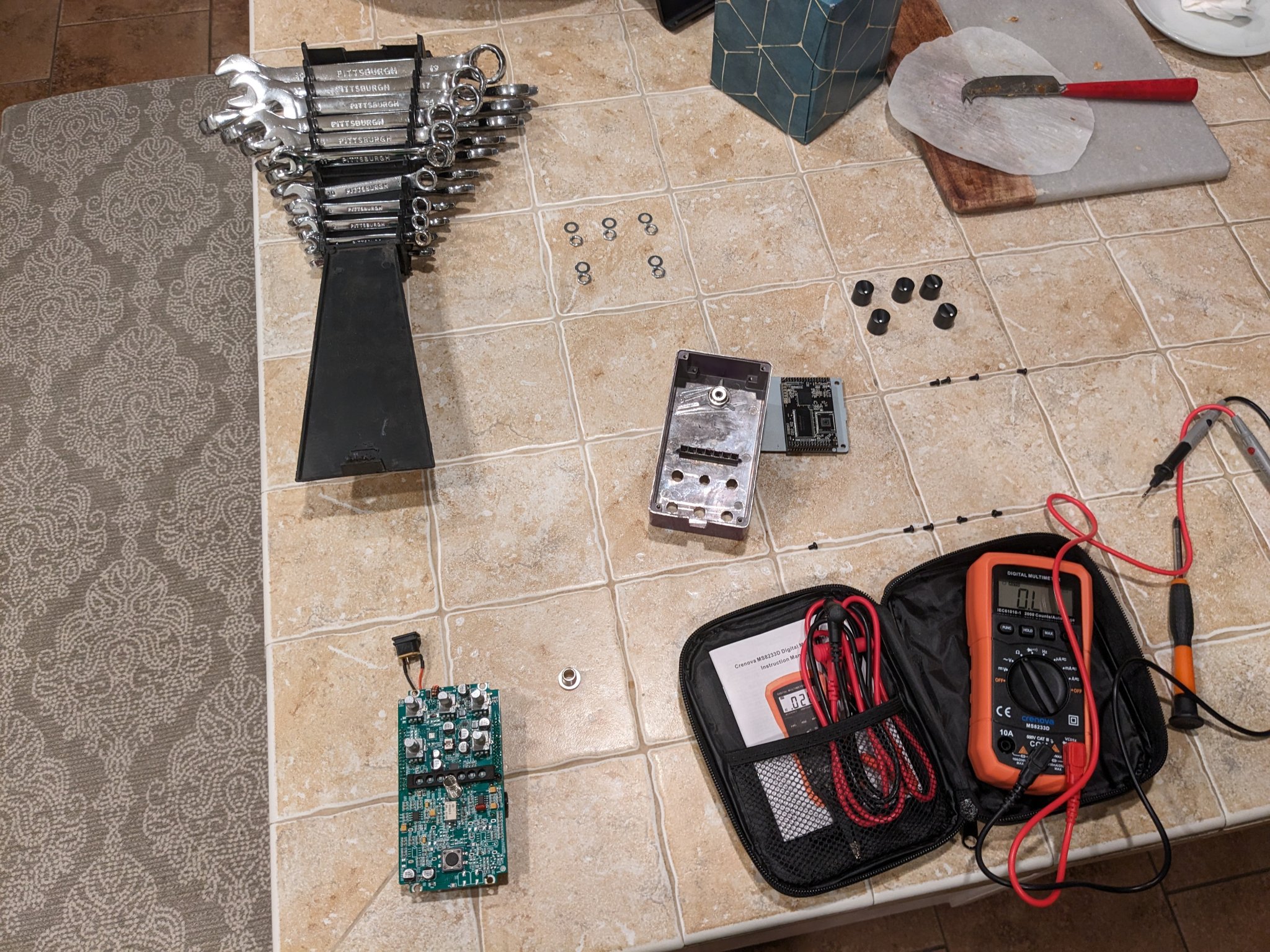

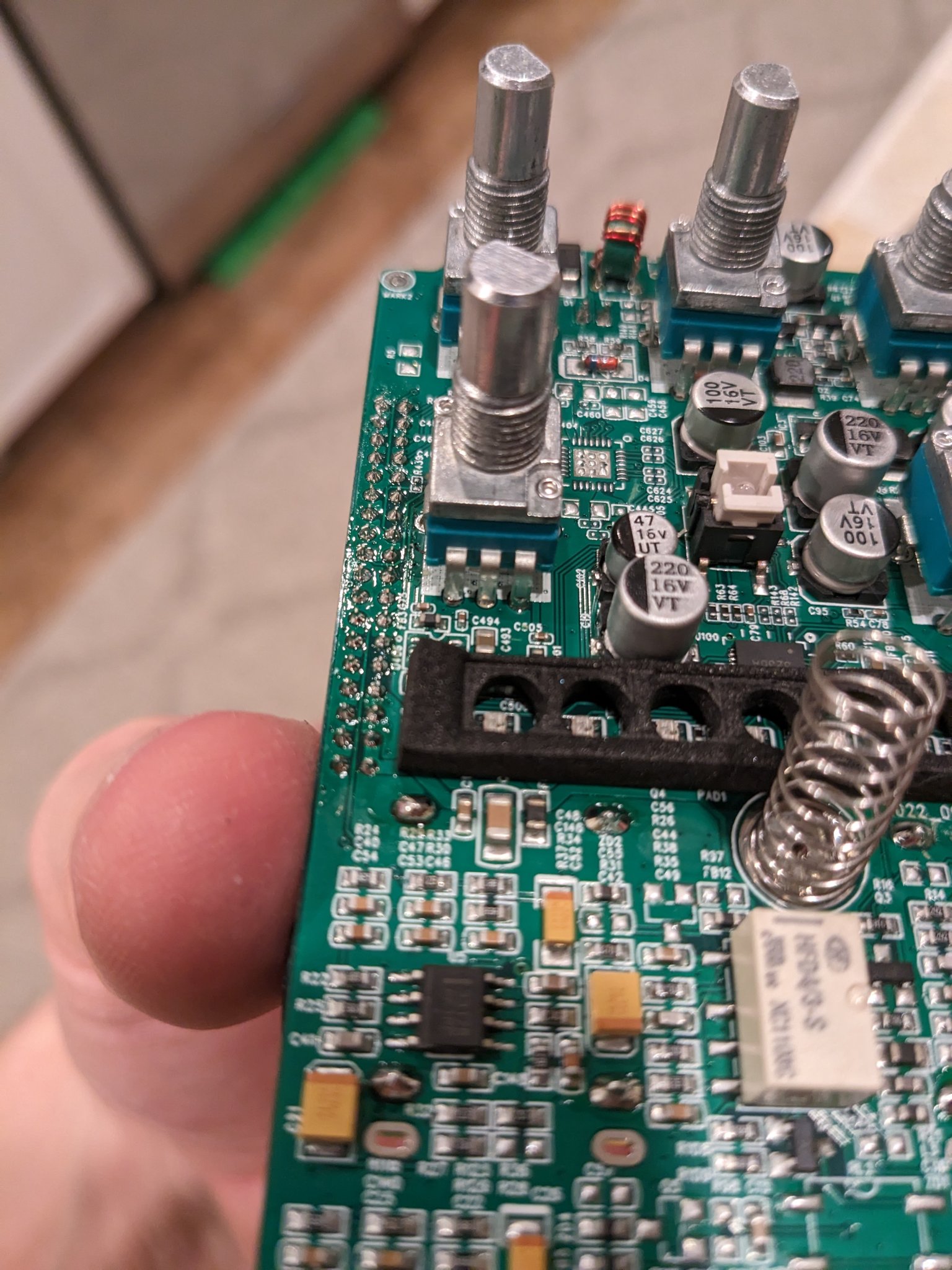

So, Flamma never responded again, so I got fed up with waiting and took it apart. I think it's a bad potentiometer but I'd appreciate somebody checking me. Please see the pictures. I think it's a simple 50k pot, and when I measure resistance between the middle contact and either one on the sides, I get like 5 megaohm measurement, which does not change when I twist the pot. I compared to the other ones, which are the same: they all vary from zero to about 10K.
So, I'm thinking I should just replace it. I cannot find the exact mount type on Amazon but the same one with three pins is there, and it'll probably hold by the nut, so I don't have to firmly mount it on the board I think.
What do people think?

Place a piece of rubber under the pot body to give it some height. That's one.

I was kind of surprised it wasn't an encoder type control, but that's a good thing it's a potentiometer. While you have it apart I would inspect the solder connections on the other pots, just to make sure they got a good amount of solder on them and no bad joints.
Reactions: Crocobar
Well, I replaced the pot, and the pedal works as intended now! As careful as I tried to be, I missed one detail, see the picture. 🙂 I guess I have to find a new knob cap...
But that's minor: thank you for the advice folks!!
