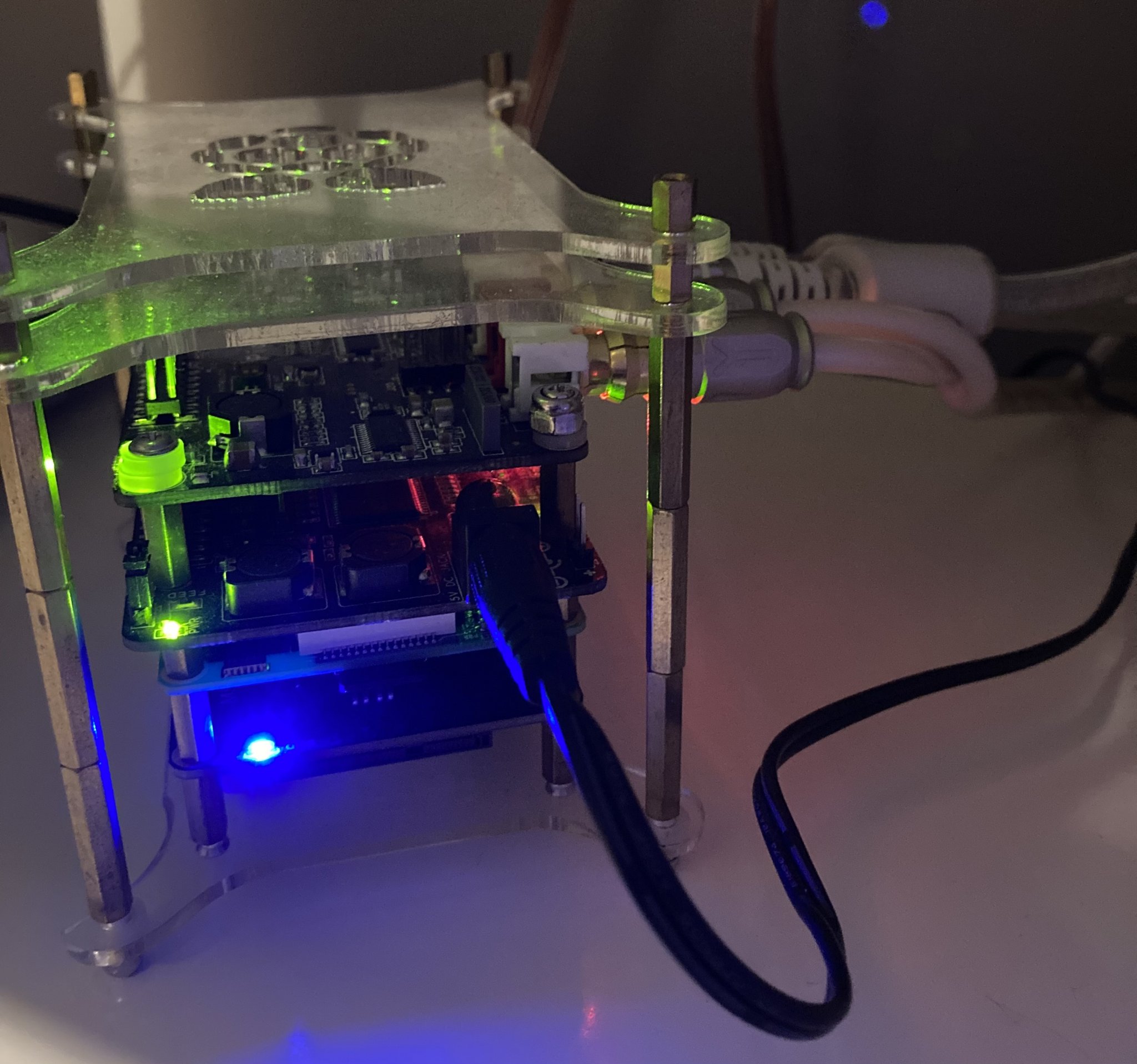

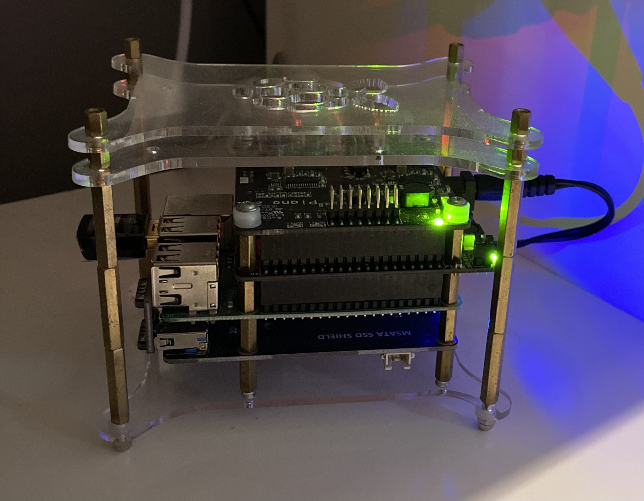

Just for the sake of example, here my setup, similar to the request except it has RCA outputs from a DAC instead of SPDIF output as asked.
Pictures are blurry because of low light.
1. Bottom is a Raspberry Pi add-on board with MSATA harddrive (long time ago. Now, everybody switched to NVME connection, easier to find hardrive at cheaper price). FLAC on it, ripped from CD.
2. Up is Raspberry Pi 3
3. Top is both Reclocker and Allo Piano DAC. (both together are functionnaly similar to the suggest Allo Boss)
2 points
A. Power comes from an additionnal 19V or so power supply. I have to connect it to power the system. And i have been lazy to buy a cable with a switch
But one of the poster mentionned it as an hassle and it can be true.
B. Keeping up with the software update / trial of Volumio or others might not be your cup of tea.
Have a nice dayView attachment 1073893View attachment 1073894

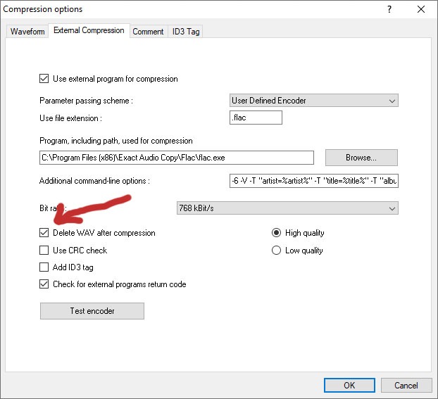

Yes, dBpoweramp CD Ripper deletes temp files automatically, unless you apply a DSP effect during the rip.I've ripped 100s of CDs directly to FLAC with dBpoweramp and find it very good.
So there aren't any wave files to store or delete (temp files are cleaned up automatically AFAIK)
ExactAudioCopy needs a little configuration -
