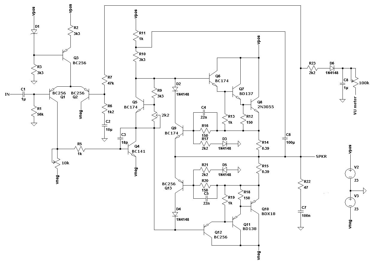

Yesterday and today, in the process of figuring out which terminals goes to what I managed to reverse engineer a schematic. Please excuse my messy drawing 😀
So now I ask you, does this look ok? I'm not really knowledgable about linear analog circuits other than basic opamps and such. And I still have to check the part values. There are three trimpots in there for adjusting things (bias I assume, the third one is to adjust the scale on the analog VU meter), how would I go about checking that they're set right?
I still have to check the health of power transformer (which also appears to be a DIY job and by it's weight I'd call it slight overkill). In the enclosure I found some scribbles suggesting "23V" for the power supply, I'm guessing thats bipolar (the wiring is so bad that that I can't even tell). The power supply was built on turret board and was just a basic bridge rectifier and two 4700uF 50V capacitors but I'm going to rebuild the entire thing anyway.
Alright, spotted a section of the schematic I missed, checked all the part values and redrew it in LTSpice (where the circuit functions so I guess I got right!).
On one channel the BD138 PNP transistor mounted on the heatsink next to the lower output transistor is destroyed, the base pin is ripped out of the package. The 150ohm resistor with the capacitor parallel to it at the base of Q13 has some charring on it but measures correctly. Other components around there measure strange but most components do when they're in a circuit :scratch:. The closest thing for a replacement to that transitor that I've found in my drawers is a TIP32C, would that function or should I order something closer? Other than that I've got a bunch of TO220 package transistors. I'm not going for pristine sound here, just the learning experience and satisfaction of fixing stuff.
So along with fixing that issue, I still need some guidelines on how to approach adjusting the trimmers when I get it fixed, I just need to know what to look for (I've got a scope)

It's a standard "Lin" topology amplifier using a Triple Darlington output stage. I'd say it's probably from the very late 1970s - early 1980s judging by the transistors.
If you've got a dead Q11, then it's possible the output Q10 is damaged. A TIP32C should function. BD137/BD138 were popular driver transistors at the time. Remember that TO-220 pinout is backward from TO-126. If you lost Q10 then an MJ2955 would now be the transistor of choice.
The transistors being on separate heatsinks could be a problem. Is D2 or Q5 mounted on the heatsink?
Modern BD139/140 devices are substandard compared to the Philips devices that will have been prevalent when this amplifier was made. TIP32C will function, it just will not be optimal. Though, if you want to get "optimal" the answer will be to scrap the circuit and build something similar with modern parts.

It sounds like Q13 has turned on hard, which is a protection transistor. This points to output device failure. To be honest the implementation of the circuit looks awful.

I've just desoldering a bunch of components from the broken channel and so far the death toll is every transistor from Q4 onwards except the BDX18 and the BD137 and the diode D4 :spin:. I'm going to rig up a better test the multimeter's diode test to check those two that survived.
Well I might as well finish this story... it now works! 🙂
I wasted two hours yesterday wondering why it was giving me -18V on the output until I finally realised I put a PNP transistor in for Q4 instead of an NPN :razz:. I replaced all the smaller transistors with MPSA06/MPSA56, the driver transistors for BD139/BD140 and just replaced the dead NPN output transistor with another 2n3055 that I already had. That and a diode and one of the 2watt resistors.
I also changed the R2 resistor from 3k3 to 2k2 because the offset adjust didn't get low enough (and if its designed to be adjustable it should adjust to 0)
