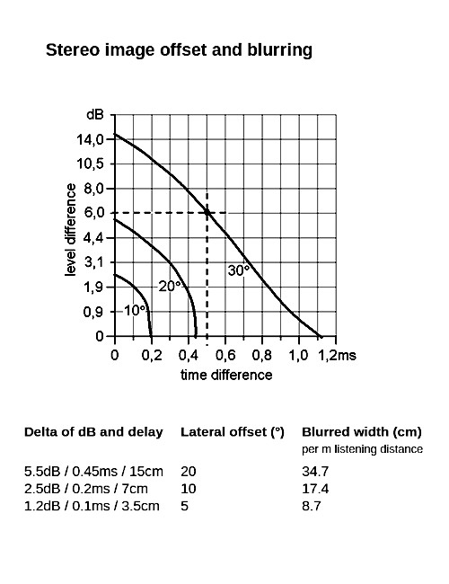

I take the risk of reiterating some well-know things.
Stereo and the stereo phantom is a matter of intensity and phase (arrival time) between signals of two channels. This goes for the everyday domestic stereo reproduction, and as well as for microphoning:
https://www.dpamicrophones.com/mic-university/stereo-recording-techniques-and-setups
In this paper, a basic graph (..."Fig. 2 Inter-channel differences to provide specific directional information from a two-loudspeaker setup" ...) shows the effects of intensity and phase deltas on the stereo phantom location.
Taking this graph and performing some trigonometry, it gets evident that for a best possible stereo phantom you will have to match both speakers in terms of spl and phase response in a quite tight matter: An interchannel intensity mismatch of only 2.5dB, or a interchannel listening distance delta by 7cm will already cause a subjective shift of the phantom by 10°.
- Case 1: A static delay delta due to asymetrically misplaced speakers will cause a static lateralization of the phantom. This lateralization remains equal for all frequencies. Therefore, in this case, the phantom gets displaced, but itself remains intactly sharp. This phantom displacement is certainly not perfect, but a lesser evil ...
- Case 2: An interchannel SPL frequency response delta instead will will blur the phantom, tearing it apart to both sides, in dependence of the relative channels loudness at different frequencies. This blurring is definitely bad.
- Case 3: An interchannel phase mismatch basically acts as a combination of case 1 and case 2 principles. It's effect on the stereo phantom adds up to the case 1 and case 2 in a specific stereo setup. Further shifting ans blurring the phantom.
In our daily listening room, we well meet a combination of all three cases. Case 1 is easy to remedy by physically shifting your stereo gear around. To cure case 2, you will have to equalize your speakers to match each other best possibly at the sweetspot in terms of SPL response over the frequency range. Personally, I equalize the first wavefront only, and not the room response. To cure case 3, it's more complex. You have to selectively influence on the excess phase of both channels. But it's worth the effort in case of coarser phase mismatches.

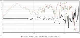

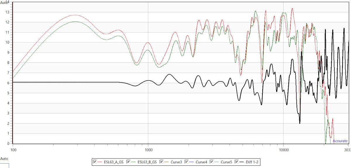

As an example for a case 2 assessment: This is a first, uncorrected and thus "native" measurement of my both Quad ESL63 raw (non-)matching after having reworked them. They show an interchannel mismatch (black curve) of 1dB from 1kHz to a 4dB below 10kHz and a max. match error of 7dB above 10kHz:
Looking now at the above graph and the trigonometry: How accurate can the stereo phantom get with such an uncorrected, raw stereo pair, at a typical listening distance of e.g. 2m?
This is why it seems wise to match both speakers best possibly for a distinct listening speetspot. Geometrically, in terms of frequency response, and, if the tools are handy to do so, also in terms of the phase response. Nota bene: By equalizing both speakers independently to a maximal flat frequency response, also the case 2 mismatch inherently gets minimized to a certain extent. But in terms of the stereo phantom precision, not sound coloration correction (correcting for a flat frequency response) primarly matters. It's interchannel match that really is important.
- With a mismatch of approx. 1dB between 1kHz and 4kHz, in this frequency range the phantom would be blurred to a width of 17cm (=2m*8.7cm/m).
- Then, with a mismatch of approx. 2.5dB between 4kHz ... 7.5kHz, the phantom expands to a width of some 35cm.
- Finally, at higher frequencies the phantom gets more and more diffuse, finally getting nebulized to a width of some 70cm and even more.
