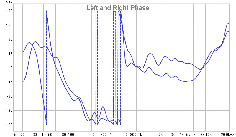

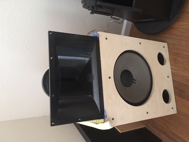

About two months ago, I finished hooking up the horn system (JBL2226 + 2380 horn and 2445J driver). Using a passive crossover between the drivers. I was in such a rush that I connected the right woofer in reverse polarity. Then applied DRC to correct for the room response. Of course, DRC also fixed the phase of the right speaker such that it ends up being close, though not exactly the same, as the left speaker.
The sound was somewhat phasey, but 'Birds on a wire' from Famous Blue Raincoat was a revelation. There was so much space and air between the various instruments on that song and they were all locked in place. All music was improved. Symphonic music and other 'depth' recordings were amazing. It felt like you were listening from the perspective of where the microphones were placed during recording. Even sitting way off to the side, the soundstage remained in place. It was truly amazing. At first, I thought it was the 2380 horn, with its perfect polars that was the cause behind this amazing imaging. But after a while, the phasiness got to me and I started looking in the measurements and found the reverse woofer polarity. So, I repeated the measurements with the correct polarity, and ran it through DRC, and... the magic was gone. It measured better (phase and crossover null), but imaged less better.
I still haven't figured out what happened there, but then I started reading this thread, having played around with Pano's phase shuffler a few years ago. Then I landed on Frankl's LoCo pages and gave that a go. I used Voxengo's MS plugins for encoding and decoding and inserted their linear phase equalizer between the two and used the S-curve for the side channel--boost around 400 Hz and dip around 1.3 kHz. That did improve imaging quite a bit.
Is that what you are doing Wesayso? When you said MS enhancement, what EQ are you using? Also, I'm not confident I'm doing the LoCo technique correctly though it does improve imaging quite a lot. Does anyone have any experience with it?
I am attaching the 'phasey' sounding but superb imaging configuration measurements. Note that these have no MS processing at all. What you see is what is playing.
Your measurement shows a phase offset exactly in the spot where we played with the shuffler. The left/right channels are separated by 45 degree which will alter the cross talk perceived at the sweet spot, but also in the rest of the room.
My mid/side EQ mimics the resulting frequency response of something like that but does not alter the phase. Similar but not the same 🙂.
Cross talk cancelation is another variant to achieve the same. It was easiest to get great results with mid/side EQ. Those results hold up over a larger area without sounding weird.
