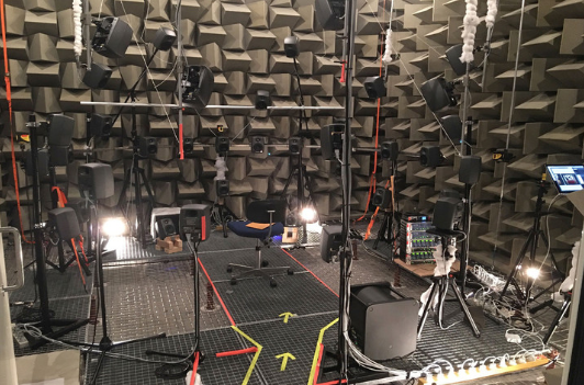

Its not simple 😀 but in University 40 kilometers north of me they sound happy with realism and natural performance http://www.digitaltrends.com/cool-tech/sound-lab-replicate-any-acoustics/.
They claim this amazing sound lab can replicate the acoustics of any building that exists… or doesn’t.
