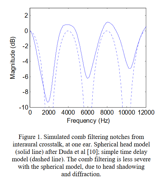

Two identical* signals arriving from a left and a right speaker, will cause cancellation and comb filtering at the human head. This results in notches in the frequency response at each ear. See the attached chart.
Those notches fall at approximately 2K and 6K, resulting in a sound that is duller than one arriving from a single source. The phantom center is formed by two identical signals arriving from left and right. Thus the phantom center sounds duller than the sides alone.
*identical is important

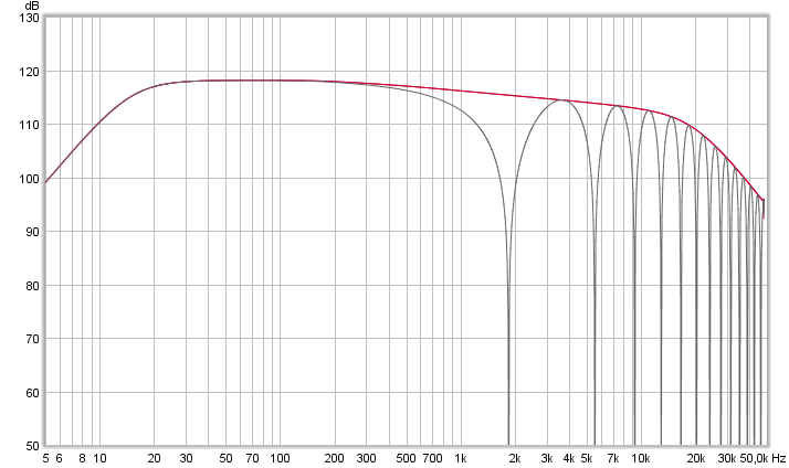

.....(And that way I could tell if there is any relevance to my own observation: a dual-mono REW freq response trace falls neatly and uniformly above the individual L and R speaker traces across the band (allowing for small amounts of high-freq phase conflict sometimes). Is that relevant?).....
To model 2 ears (HRTF) verse mono micophone into REW take say your left speaker measurement and open it twice, then for one of them delay IR -0,27mS and on "All SPL" tab pick them as (A+B)/2 and hit "Generate". You welcome share curves here 🙂 below is a result from perfect IR-wav file created in Rephase.

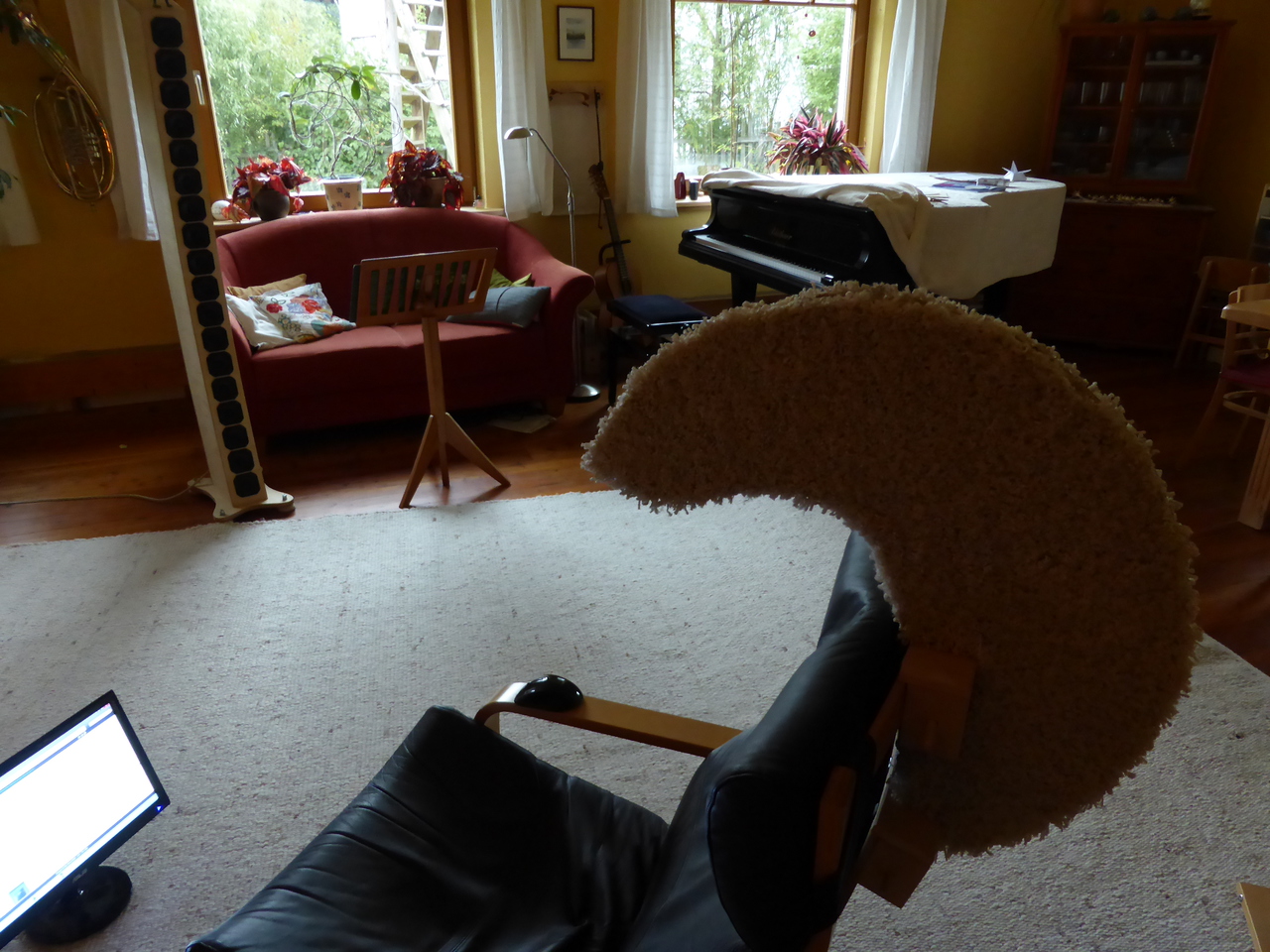

Ben, human beings' brains can partially equalize for the phantom center. Play mono pink noise, sit down in center position and hear, how the dips and peaks sweep thru the frequency band, while you move your head. But it is only a partial fix and ties up mental resources. The error is not natural but only 70 years old, so we have not much evolutionary gear for it, and I do not want to breed that gear any further.

This is a good test. I did it before. The sweep should be audible with a good hi-fi stereo in a good room. To compare, use a barrier like post #8, which instantly removes the comb filter effect very well. A chair cushion is OK.
