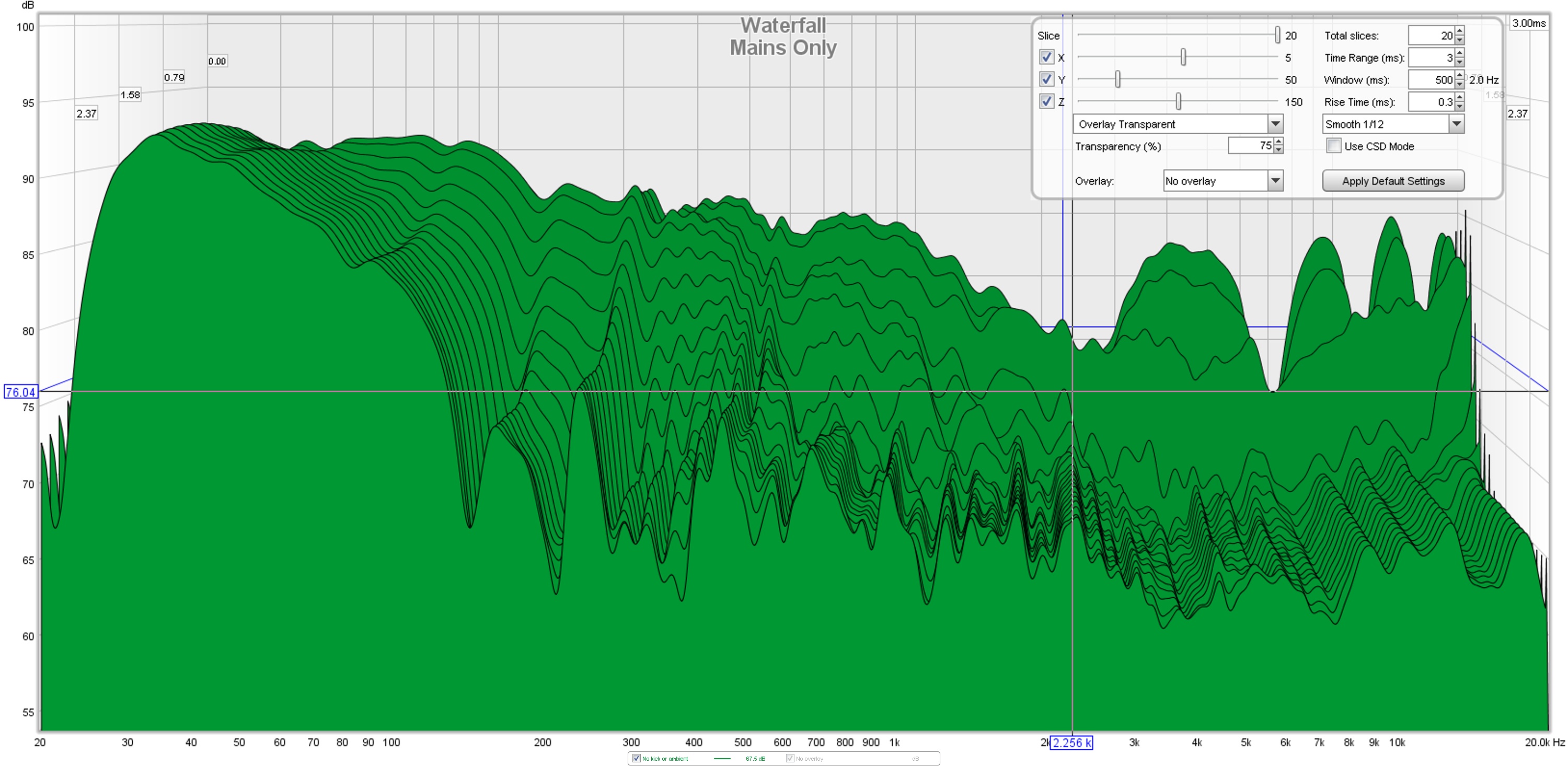

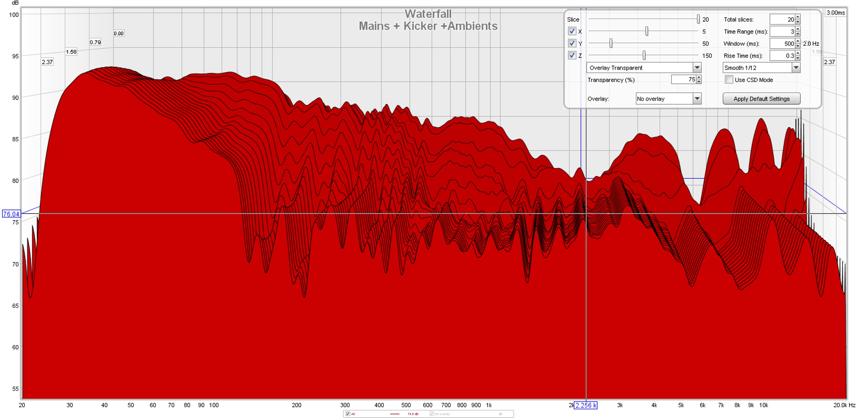

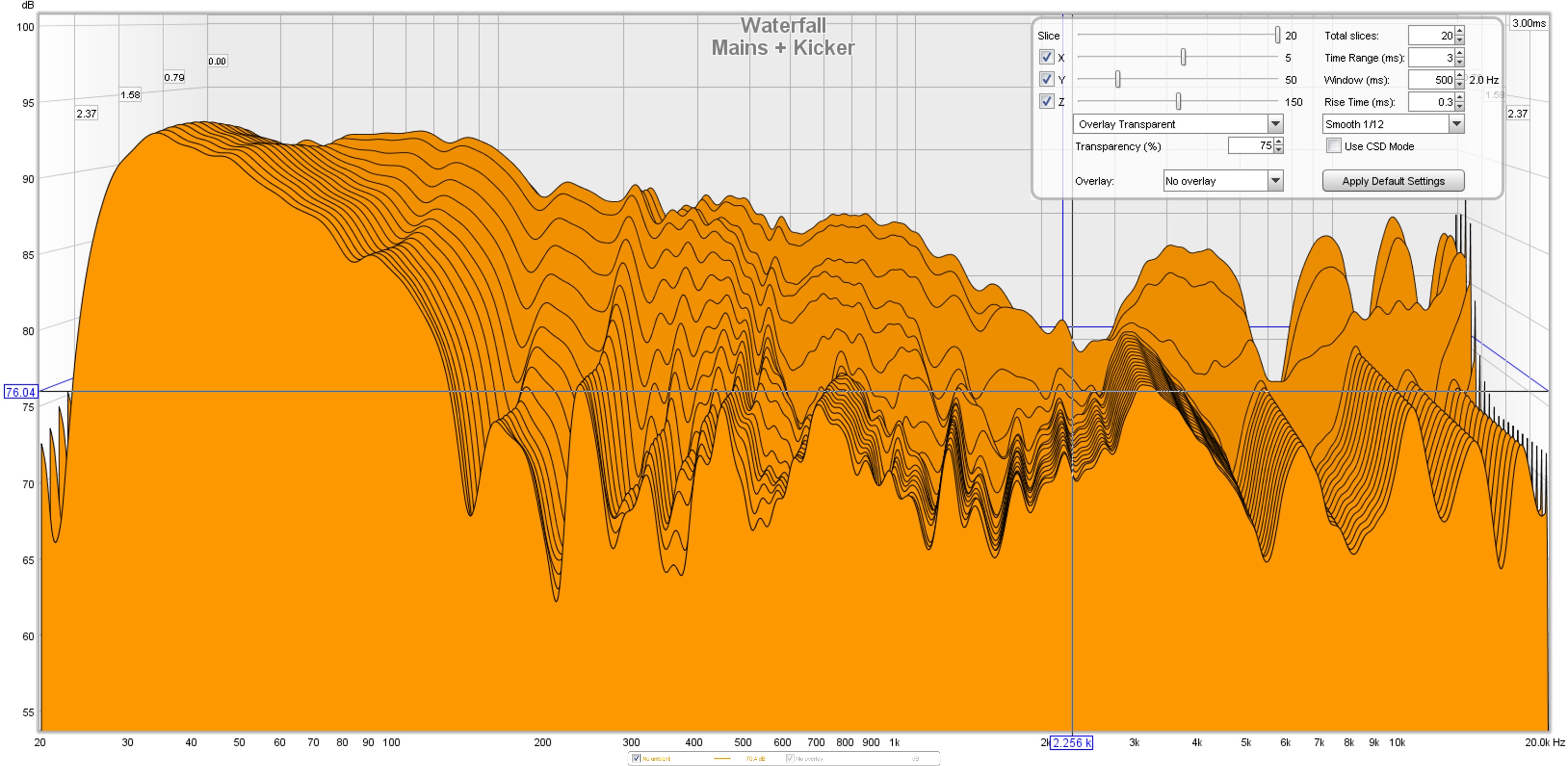

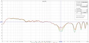

I did yesterdays experiment with the mains only (Green), with Kickers (Orange) and with my Kickers + Ambient channels (Red)
Interesting?
Interesting?
.....Interesting?

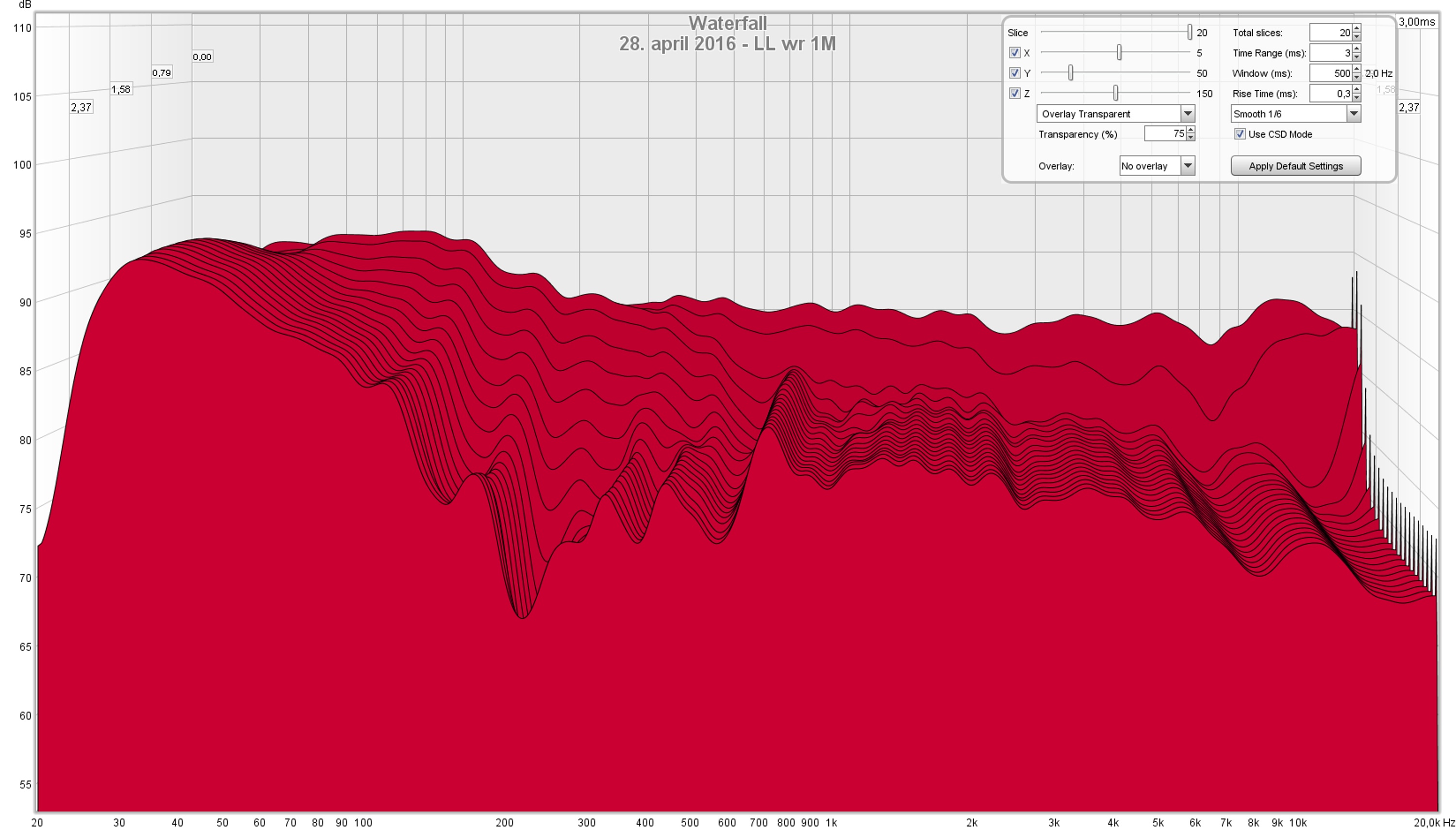

Yes nice to see real world situation from within a good room and system setup, verse pure left or right panned signal there is quite some difference comparing to your shared mdat-file called "16 04 28 LL RR wr: Mains + Ambient channels (1M)" .
Sweeps with both channels driven are nearly always going to show some major differences in the mids and up compared to single channel measurements with a single mic.
Good thing we have two ears

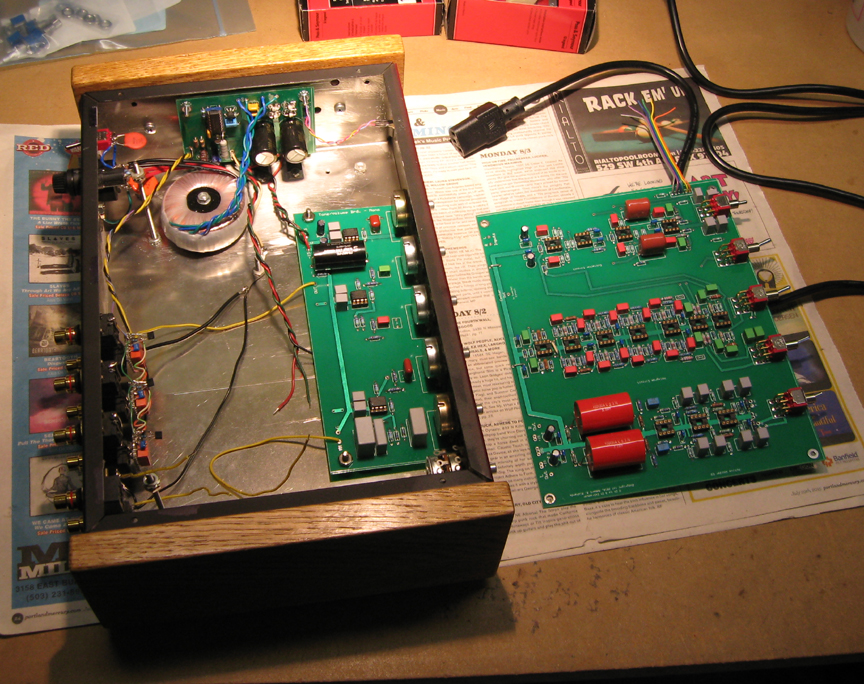

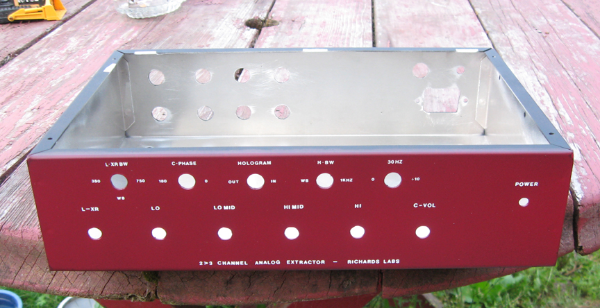

My 2 to 3 channel analog converter; "The Extractor" is nearly done (finally). It's got a stereo matrix working against an L+R function for separation, and an optional inter-aural cancellation function (Holographic Generator) for the L and R outputs, and/or low bass boost circuit (+10dB at 32HZ with fast rolloff below that). Center out has a 4 section Baxandall tone circuit.
True! But even they give us problems with 2 sources.Good thing we have two ears
The rear is boring. 2 inputs, and 2 outputs for L, R and Center (each). Typical use might only need one output for L, R and C, but if you later wanted to add side or rear channels that had further processing (delay, reverb, phase invert?), or add an additional powered EQ'd woofer using the 2nd C output, it's all there. I put the power switch on the rear next to the fuse because I never bother to turn off my low current units (just the power amps). It's been argued that turn-on and turn-off, and temperature change inside some devices may age the parts more than steady operation 24/7. I doubt if that's a big thing, but it also allowed me to keep AC wiring real tight and away from any sensitive circuitry, so minimal hum.Nice one, Bob. What does the back panel look like? Ins and outs,

I think my Extractor does what it's supposed to do real nice, but I learned that the center speaker really does have to be pretty good, or the vocals and whatever center stuff sounds too different. It doesn't integrate well. The center speaker bar with it's 5 inch woofers doesn't quite have the warmth of the side speakers, despite the center speaker tone controls doing what they can do. Some audiophile friends didn't like it, and I believe it's because of that.
I have always contended that the center speaker needs to be the same quality as the sides. This idea of using a smallish center speaker bar with far better sides just never seems to work.
The funny thing is that I was worried that there wouldn't be enough separation between the center output and the sides, since the L-XR stereo matrix is passive (no active steering). After listening to it, I found that it works much better with even less separation. The integration is better, and room acoustics comb filter effects are better filled in when sounds are emitted by more than one speaker. I'm glad I have a continuously variable L-XR function (the X is variable), so I can set it the way I like. I haven't tried frequency selective processing, other than the 2 lowpass options in the L-XR circuit that are loosely based on the research of David Griesinger (formerly of Lexicon). Those options depend on the program material, and whether or not I'm sitting in the middle where I should be, as opposed to over by my fireplace (where I usually am as it turns out...).
