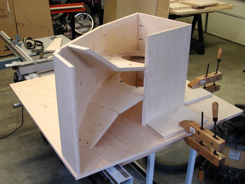

Over the last couple of days I've been trying to get a more accurate simulation of the Labhorn by including the offset drivers and breaking the horn into actual segments instead of the previous method of just simulating a hyperbolic flare with 0.5 T.
The first problem is that Danley's specified horn (the design before he folded it) doesn't fit inside a Labhorn sized box. The next problem, as someone else mentioned previously, is that the Labhorn is pretty weird in it's first couple of feet (starting with a throat that's too big, then contracting until it's too small, then expanding again at a rate that quickly makes it too big again, etc, etc.). The third problem - the big one - is that I can't "fix" the Labhorn. There's no room. There's no way I can make the back chambers big enough without changing other parts of the horn for the worse. A full redesign of the folding in a larger overall package would do it, but that's not something I'm really interested in right now.
My next step is to do a complicated but accurate model with Akabak to try to find out what Danley was thinking when he folded it. Maybe there's a couple of folding secrets to be learned here or maybe he just got lazy and didn't do a particularly good job with the fold. The Akabak model won't happen anytime really soon.
As I mentioned previously, I don't care for the v.2 or v.3 options. The v.2 is quite similar to the original and the v.3 makes some changes I'm not comfortable with - and he didn't end up building what he modelled anyway. The v.3 throat comes to a point, so his compression ratio is a lot larger than he thinks (IIRC he stated it was 3:1, and he incorrectly modelled the horn throat as part of the front chambers). That alone isn't necessarily a huge problem, but it doesn't give me any confidence that he knew what he was doing. And the complexity of the v.3 is ridiculous.
In the meantime, I'm also looking into different drivers to use in a Labhorn size box. Mainly looking into single 15 inch drivers like the Eminence 3015. The single 15 won't go quite as loud but a much flatter response is possible and driver cost is cut almost in half.

Brad Litz's (v.3) front chamber is a complex volume that is defined more by the driver's front volumes than the taper of the baffle. The chamber would be better modeled as a soccer ball than a wedge.

Yes, and it works well. But measurements and simulations and real world thermal overload testimonials show it could work better. It might take a bigger box but it could work better.
Compromises in the flare rate have little effect on the bottom two octaves, where the labhorn is used.
Actually, changing the flare rate has a pretty profound effect. I can show you general simulations if you want but I don't have a complex model of the Labhorn worked up yet.
I haven't spent any time trying to model this version. There are several reasons I don't like it much, I just don't like the choices he made.
