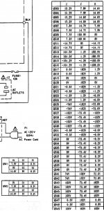

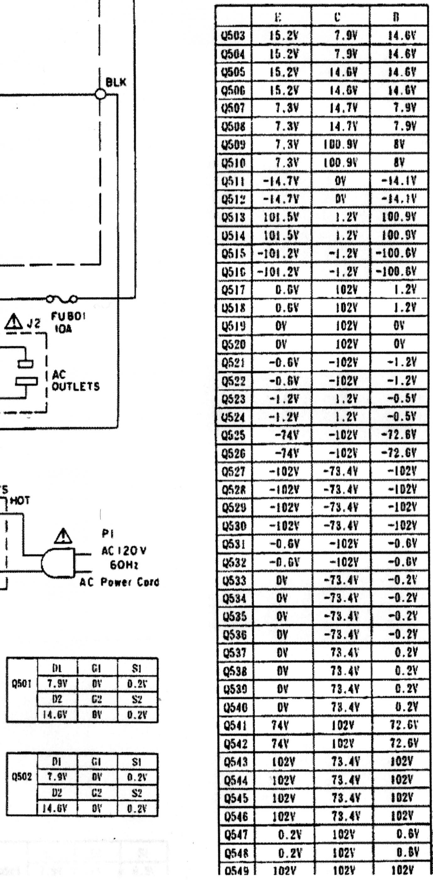

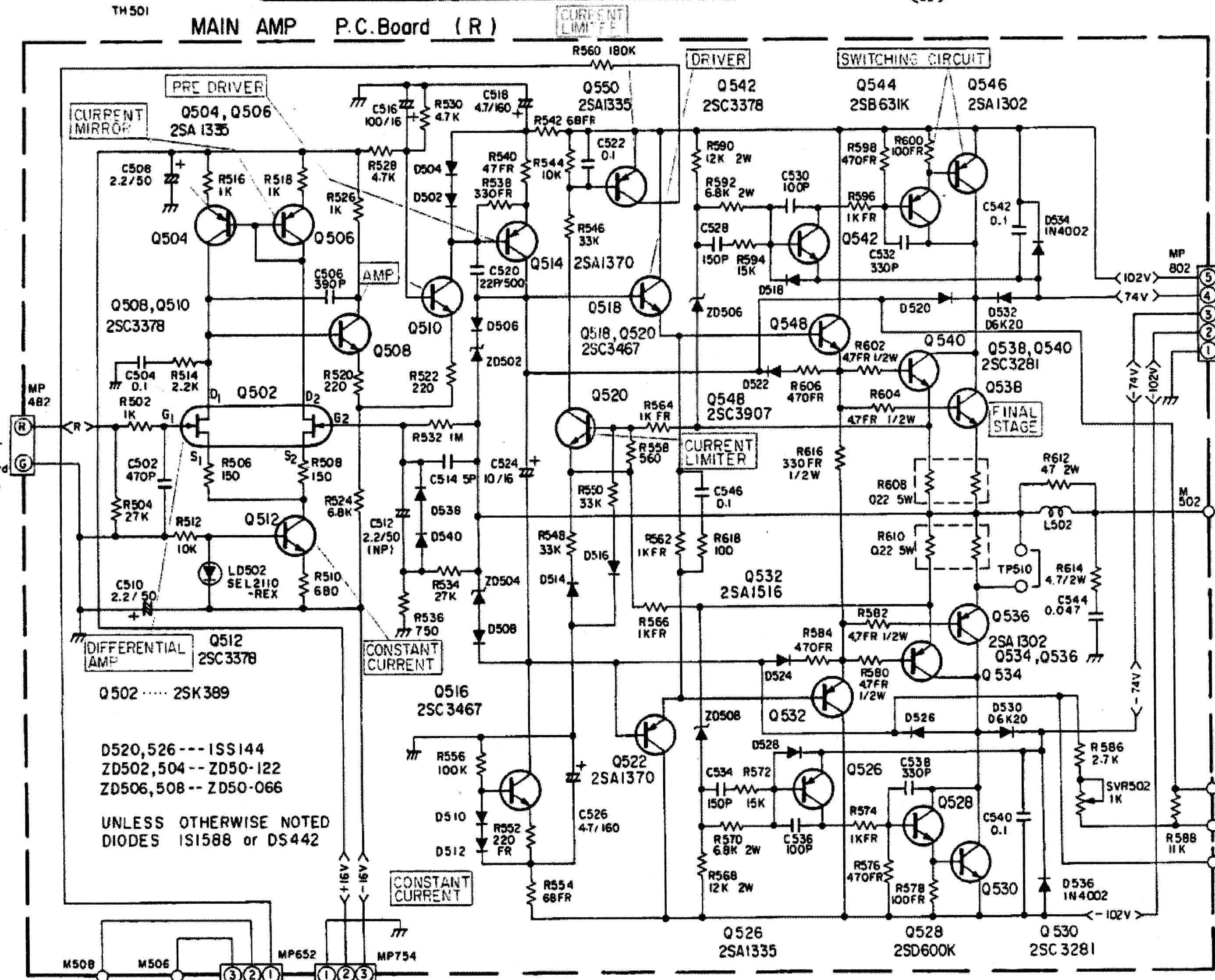

I have a Luxman R-117 receiver with blown-up right channel that I’m trying to fix. I think I found what’s wrong with it but I don’t know why this problem occurred in the first place and how to find it.
This is the former parts unit that I got as non-working: upon power-up it blew fuse. Unplugged both amp boards- powers on OK. Tested output transistors and found that two in the right channel, 2SC3281 and 2SA1302, are shorted. More diagnostics showed that two small current limiting transistors, 2SB631K and 2SD 600K, are shorted too (Q544 and Q528, sorry I can't attach the file with schematics since site is not working well; it s on vinylengine or send me a message). The two big current limiters, Q546 and Q530, are OK as are diodes in the 74V rail, D520, D526, D530 and D532.
What bothers me is when I soldered out the four output transistors and measured voltages at their terminals on PCB, voltages at bases of all four of them were way out of expected: +10.6 to +11.7 volts instead of +0.2 or -0.2 volts. The voltage at collectors was + or – 101 volts instead of + or – 73 but this could be explained since current limiters are shorted and +/- 102 V goes directly to collectors. Voltages at emitters were 7-15 mV which I believe is within specs.
I tested with diode tester a pre-driver Q514, drivers Q518 and Q522, and “post-drivers” Q532 and Q548. Tests were done in-circuit and none of the transistors was found shorted. Resistors connected to bases of outputs, i.e. R580, R582, R584 R602, R604 and R606 are OK too.
Could this wrong voltage at bases of output transistors be an indication of a problem elsewhere? After all, outputs and current limiters were shorted for a reason. What might it be? Where else should I look?
Any suggestions will be most appreciated.
you need to trouble shoot the amp stage by stage ...in your case this is a class G amplifier meaning that its switching rail voltage depenting on the output needs
this can be quite tricky to work with since too many circuits that are involved with the supply but also with current limiting are connected together
if you have no obvious damage a better approach will be in a way to isolate the high rail voltage and current limiting circuits to work with the amplifier in class AB conditions ...stabilize his section first and then look to the other sections such is the current limits and high rail symmetrical switch and power parts

The schematics and voltage tables are now attached. Sorry for the inconvenience.
All:Thank you very much for your help and advices. I will do some more troubleshooting and will report back..or ask for help again.

I dug out the spreadsheet with the R117 repair info and provide the below list as it may be helpful. I bought this unit as non-working for the purpose of restoration or to scavenge the parts for another unit if I failed to get it running. I was right it was the right channel that was blown. The below list of damaged items is what I like to term the Path of Destruction.
Q538,2SC3281Shorted
Q540,2SC3281Shorted
Q534,2SA1302Shorted
Q518,2SC3467Blown
Q522,2SA1370Blown
R602,4.7ohm 1/2 watt F.R.Open
R604,4.7ohm 1/2 watt F.R.Open
R616,330ohm 1/2 watt F.ROpen
R608,.22 ohm 5 watt C.E.Open
R584,470 ohm 1/4 watt F.R.Open
R562,1K ohm 1/4 watt F.R.Open
D506,1S1588Shorted
D508,1S1588Shorted
ZD502,Zener 1/2W 12.2V ZD50-122Shorted
ZD504,Zener 1/2W 12.2V ZD50-122Shorted
Using your basic VOM and a capacitance tester I got to the above list by starting at each of the power transistors leads and working my way out along the circuit paths. I sometimes had to de-solder some components to test them properly. Once I had my list I went shopping for the parts. If I had to make a guess, remember I am not a tech, as to what it was that blew up this channel. I would have to say that I have strong feelings on R608 as the culprit.
You can look over the above for now and see if it is helpful. I will try and put together a list of sources for the parts I replaced. I kept to the original OEM spec and name brands as best I could.

I did another round of testing and didn’t find any faulted components except those found before. Form all the components Retrex found damaged only one of Q538/Q540 and one of Q534/Q536 are shorted. I checked all electrolytes for shortages and found none.
That’s what I am planning to do (I am not a tech, so bear with me):
- order new output transistors from Mouser, MJL3281AG and MJL1302AG, substituting for 2SC3281 and 2SA1302, respectively.
- order the exact replacement for Q544, 2SB631K and Q528, 2SD600K, from B&D Enterprises. Should these be hFE matched?
- order replacements for Q532 and Q548, 2SA1516 and 2SC3907, from B&D Ent. They test OK at least in circuit but might be stressed by shorted outputs.
- get new emitter resistors, R608 and R610, since they could also be stressed. However, I didn’t source them yet. Any suggestions (3-pin, 0.22 Ohm, 5 W)?
Then, as Sakis suggested, “isolate the high rail voltage and current limiting circuits to work with the amplifier in class AB conditions” by not soldering back Q530, Q546 and new Q528/Q544. Solder in new outputs and test with the dumb bulb tester if Luxman powers up well. If yes, supply 1 kHz input signal with a generator and test the amp circuit with the scope. If amp is OK, solder in Q530, Q546, new Q528 and Q544 and repeat the scope test.
Does this sound as a good plan?

Soldered in four new outputs and powered Luxman up using that bulb thing. The bulb glowed for the moment and then dimmed, Luxman display lighted up and then a relay clicked. No smoke or firework display. Powered without bulb- everything seems OK. Measured voltages at output transistors –within specs, same as in the left (good) channel. Supplied 1 kHz signal with the generator and scoped the outputs at low and moderate signal level- perfect sine wave of the same intensity at both channels. Set up bias. Played some music with suicide speaker using tuner as source- plays good, no distortion.
Next, replaced drivers, post-drivers and soldered in new Q544/Q528: they and big switching transistors, Q530 and Q546 were taken out. Powered up with bulb - OK. Scoped all drivers, “post-drivers” and outputs - OK. Measured voltages at Q530/Q546 terminals –within specs.
Then soldered Q530 and Q546 in. Repeated the procedures listed above-all seems OK. Set up bias. Run Luxman for a while then connected 220 W 8 Ohm dummy loads and voltmeter in AC mode to speaker terminals and supplied 1 kHz signal to the CD input.
The maximum power I got from the Lux was 167 Watts from each channel, which correlates well with the expected 160 WPC. Interestingly I didn’t see any clipping by the scope at the max power-rotating of the volume knob further clockwise just didn’t result in the increase of the output voltage. At the max WPC the transformer (?) hummed and the receiver heated up but not as strongly as dummy loads. At 100-120 WPC there was almost no hum and not that much of heat.
Finally re-tested bias checked the DC offset at speaker terminals (OK, less than 10 mV) and hook her up to the main system.
I’m using the Luxman for two days now powered on for long times, playing music at different power levels. Everything seems OK- great sound, no distortion or other adverse effects. The initial smell of burning dust is gone. The time will show; however, I hope I fixed it.
