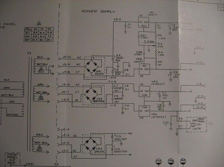

For some time ago I received an older function generator (Wavetek 191) which was not working properly. When powered, the output of every one of the output connectors (pulse sync out, sync out, pulse/square out, func out) goes to approx. +5 volts, and stays there no matter what buttons you press or what knobs you turn. I suggested that the problem was with the power supply. That was indeed the case, the attachment shows the power supply schematic (photograph taken from the original manual), and the voltage of the -5 V rail is about -0.8 volts. All the other voltages are ok.
The first thing I did was changing the caps C9 and C12, since this generator was built in 1983 (the same year I was born
). That didn't help, so I changed the regulator VR4. Even that didn't help. It's not the front panel indicator lamp either (I removed it to test whether it was pulling the voltage to zero). And because the secondary voltages of the main transformer relating to +/- 5 volt regulators are just fine, the only thing that can be defective is the diode bridge CR2.
Does this make any sense? So far I have considered diode bridges to be virtually indestructible (considering the voltage and current stresses with this application). Can you see anything from the schematic that could be the source of this problem?
Scope shows that the input voltage of the -5V reg. is not that -11.3 V as it should be, but about -3 V instead of that. And, the voltage at the input terminal of the +5 V reg. is completely fine. I'm running out of ideas. This shouldn't be too complicated, right?

Power diodes and diode bridges do fail, occasionally. If you have narrowed it down to that, then you might as well remove it and test it out-of-circuit, at least, especially if you have something with which to replace it. Or, simply replace it and see if there is any change.

I did not mention it earlier, but the -5 V supply feeds quite a large amount of different devices, each with their own bypass caps. So in order to find a defective capacitor, I should go through every one of them! And believe me, there are tens of them.
Yes, I would definetely disconnect the -5 supply from its load if I could. But there's no any circuit breakers, just copper traces - which I'd not like to break.
I guess I'll start from the diode bridge (as soon as I get some solder wick) and if that won't work, then I'll cut the trace and see if anything changes.

Tektronix usually placed zero-Ohm resistors in series with each supply rail. It's unfortunate that Wavetek didn't do the same thing.
I would probably cut the trace, since that would be a valuable test. And it should be easier to cut and later re-bridge the PCB trace than it would be to remove and replace the rectifier bridge.
