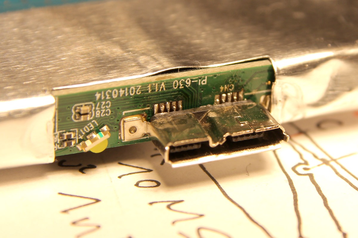

this might be helpful for anyone having similar problems:
I am using two toshiba external HD drives for data and backup (yes, i know, i should have at least a third one ... ).
after around 8 years of frequent use both drives started clicking, stopping and restarting from time to time.
also the drives were sometimes "lost" in the OS.
this got worse in the last months.
i first thought the gold contact surfaces of the connector must be damaged and tried all sorts of testing, cleaning, bending of contact springs.
it did not help at all.

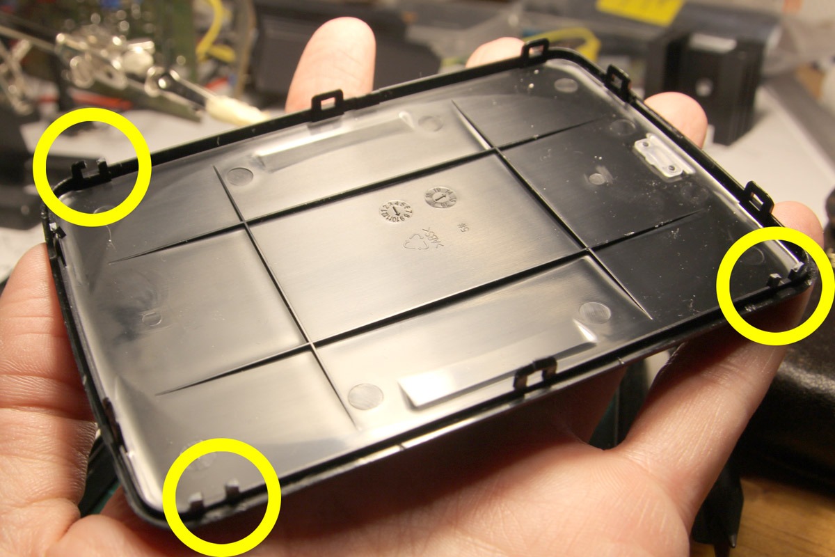

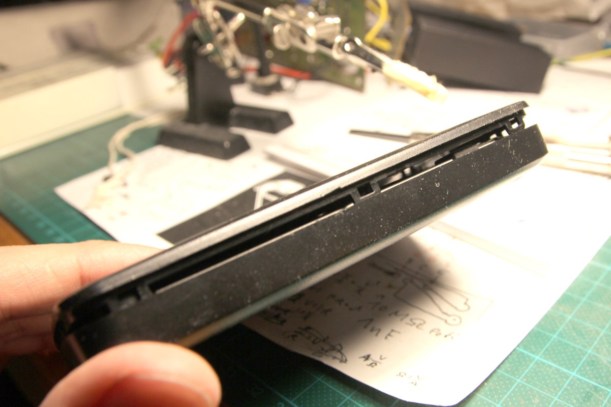

what immediately did help however was to open the drive enclosure and reflow the connector solder joints that apparently did not whitstand the force induced by cable and plug!
opening the enclosure needed the use of a sharp knife and a bit of force and I damaged some of the plastic hooks. but anyhow, the drive works smoothly again and it was definitely worth it!

I have an old DELL laptop, bought in 2009 that still has a firewire connector which i use for measuring with an external focusrite-interface. i once tripped over the connected cable and since then the connection sometimes is faulty. I will try to reflow the solder connections - i suspect there is a similar issue here.
