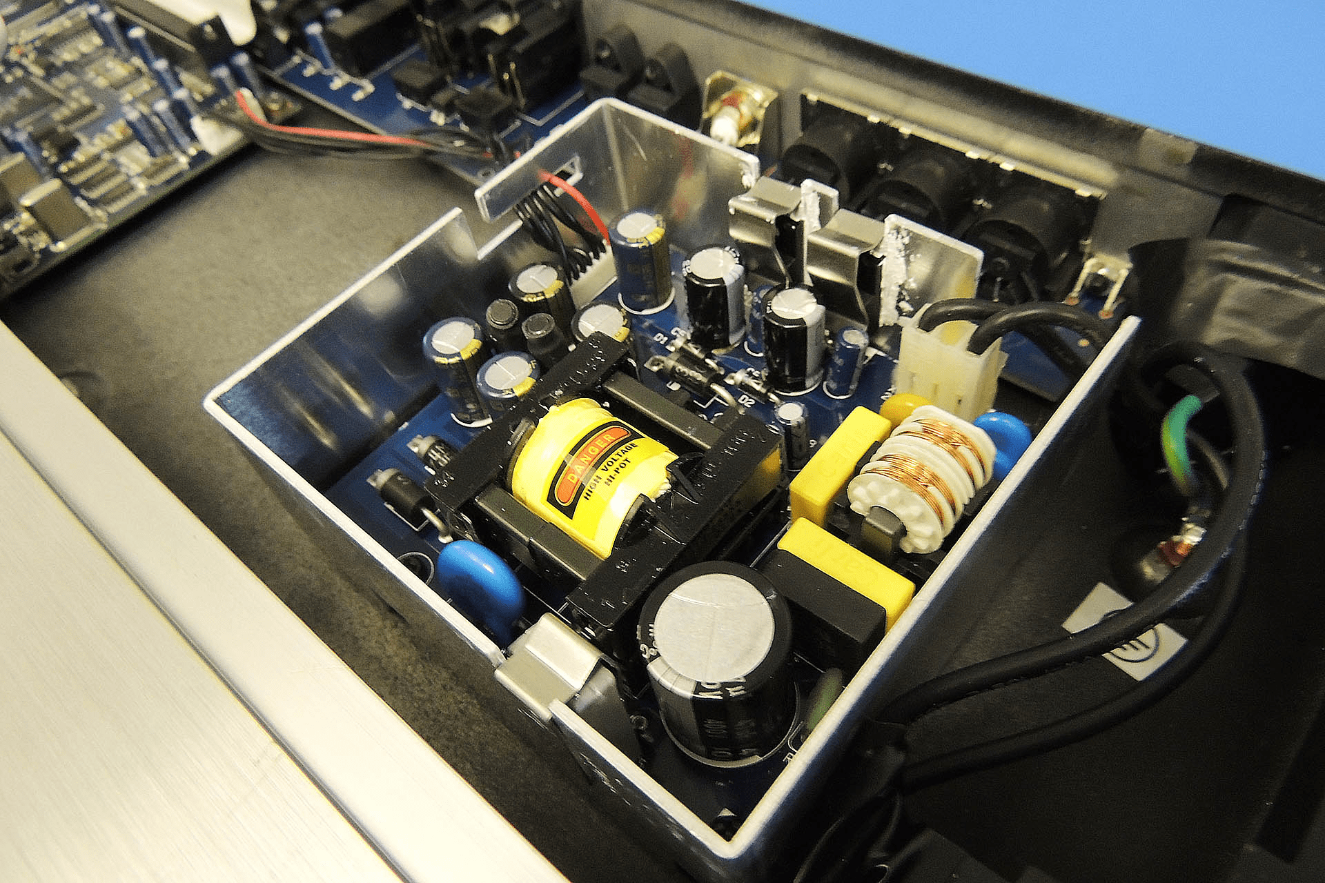

Trying to remove the old cap, it's clear to me this is using a different kind of solder. I still have my standard and eutectic leaded solder from the 70's. This may be some kind of unleaded solder as is required now. What kind of solder should I get and what temperature should I set my Hakku iron to?
Use whatever solder you want if you got it out already. If you want to maintain RoHS, use tin.
If you want to get it out still, crank the heat on the iron. If it's still not melting get a bigger iron? 😀 😛

Any good cap there will fo the job. For SMPS in my opinion Nichicon are best, but there are some minor trades that also perform well: Jamicon as example.
If you have 3.3V (rare), don't use 50V. The cap so exagerated don't perform good. Use the highest immediate to the voltage found. 3.3DCV sounds rare for a self power of the PWM chip, usually are in the 12/15DCV as they have to drive the main MOSFET gate, and 3.3V is too little. 16V seems reasonable.

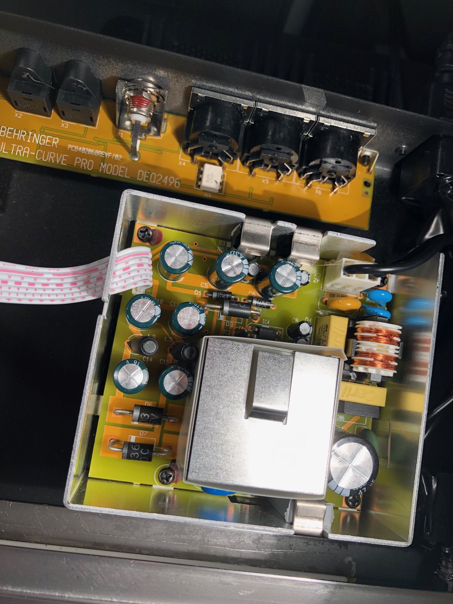

The schematic doesn't match the parts. The schematic has C14 as a 10uF 25V, but the actual part is 1000uF 16V. The schematic has C7 (the big cap) as a 47uF 25 volt but the actual part is 47uF 400V. I will get 1000uF 25V for C14 and match existing part for C7. It seems to be easier to find 5000 hour parts in these ranges.
For solder, I'm considering 217C melt point Kester 0.31 with 48 activated flux. Flux is said to be not good for "sensitive electronics" but probably better for an amateur like me. My old standby was a 63/37 Kester with activated flux. I see lead free solder melt points go all the way up to 800F. This is a lower one, but still higher than leaded solder. https://www.amazon.com/KESTER-SOLDER-24-7068-1402-SOLDERWIRE-217°C/dp/B00DDDFYKW?th=1 An alternative would be identical except 275 "clean" flux like this https://www.amazon.com/Kester443-84...sprefix=lead+free+solder,aps,117&sr=8-11&th=1

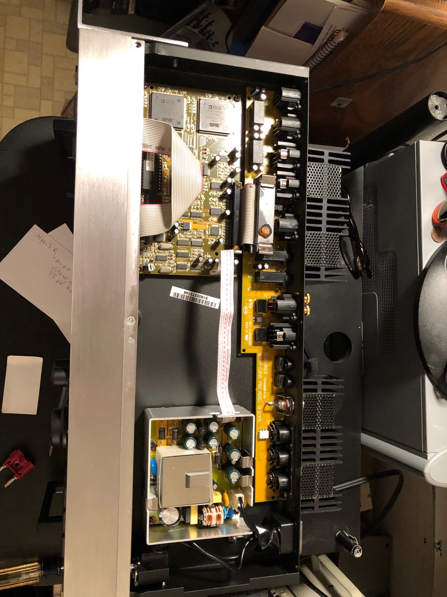

I think the time has come to start trying to fix them. They are unavailable new and the used ones (I have sadly learned) may be nearly "used up" if they work at all. I got exactly one year's use out of the last one I bought on ebay for $200.
The latest one (a year after purchase on ebay) has now died with the "flashing screen" problem. When the unit boots up you never get the copyright screen or anything just a flashing screen. Something like half of the ones in my dead pile died with that problem. Others may have the "blank but lit screen" problem, or the "dead as a doornail" problem. I suspect most or all of these problems are power supply related.
Sadly there is no schematic and no service manual. I have found a multipage schematic of some kind but I haven't seen the power supply on it.
I am going to be taking one apart today or soon to see what I can figure out.
These soldering gurus suggest you stick with the original solder alloy. Actually I don't know the alloy Behringer uses except it's one of the lead free ones. https://www.circuitinsight.com/programs/50589.html
For the 1000uF, 25V I bought Panasonic, Rubycon, and Nichicon in 5000 hr rated parts. I'm also going to judge by looking at them but only the Nichicon has AQ certification, so I think I may go with that. It means good for inside cars. I also bought the Kester 217C lead free solder with 48 activated flux. I'm going to do some test soldering with it first, see what setting works for it on my Hakko.
