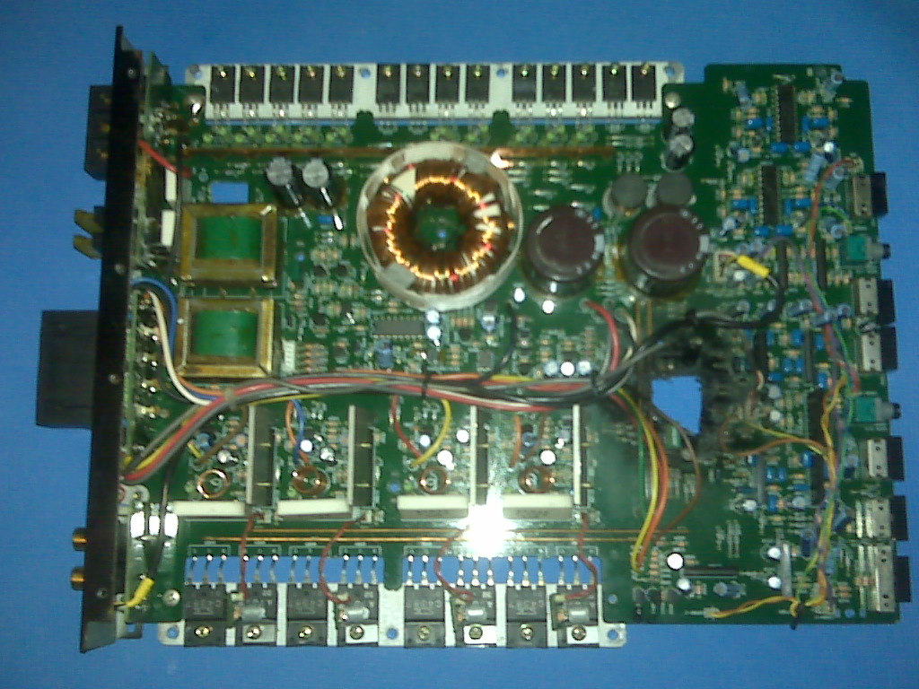

My other amps just died ;( its an alpine 3555. Didnt know how it happened, but it just stop working. When I opened it up. Saw a hole in the pcb, picture attached.
Can this be fixed, or there is no sense to fix this? Looks like one or two caps exploded leaving behind a big hole. Can an exploded caps do this?
Good news is, I can swap the output devices to my 3554. The amps part seems to be working well, no shorted output devices. Its the small signal part that is non functional.
What is that area of the exploded caps? are the 2 transistor, 1 is green and the other is black, part of power supply/regulator of the op-amps?

The 3555 can likely be repaired but you may need good quality photos or a schematic diagram to repair the circuit paths that ran through the burned area. Instead of trying to reconstruct the zener regulator that was likely there, you should use a couple of 3 terminal regulators. If the rail voltage isn't more than ±35, you can use the L7815/7915.
The damage was likely caused by the high operating temperature of the regulator transistors. The heat causes the board to become conductive. After the board begins to conduct, the heating increases until the board breaks/crumbles away or the voltage is removed. The caps (if they were leaking electrolyte) can contribute but didn't cause it alone.

The missing hole on the last amp picture is where the 16 volt rail regulators were supposed to be located WOW !!!.....Alpine used simple pass element and zener diodes and caps with a current limit resistor for the lower supply. I am guessing a three terminal regulator could be used to replace each rail but my big question is where you gonna hang the TO-220 regulators IC's
I have had to rebuild this section before hence my intimate knowledge of the hole I see. The board likes to burn up as the caps go bad in these amps with age and the lower regs just super heat and cook the board. But I have never seen one as bad as yours.. Dang man some one cut out the PCB....it must have been cooked to carbon to justify such a act.... WOW !!!!
There should be sufficient clearance under the board. Lay the 3 terminal regs on the heatsink (with insulators) and clamp the board down on top of it. If the board doesn't hold them tightly to the heatsink, use a piece of open cell silicone foam rubber to fill the gap and apply pressure to the regs.
If there isn't sufficient clearance for the body of the reg under the board, position the bodies of the regs in the open part of the board. Drill and tap a hole in the sink and make a clamp to hold the regs down tightly to the sink.
