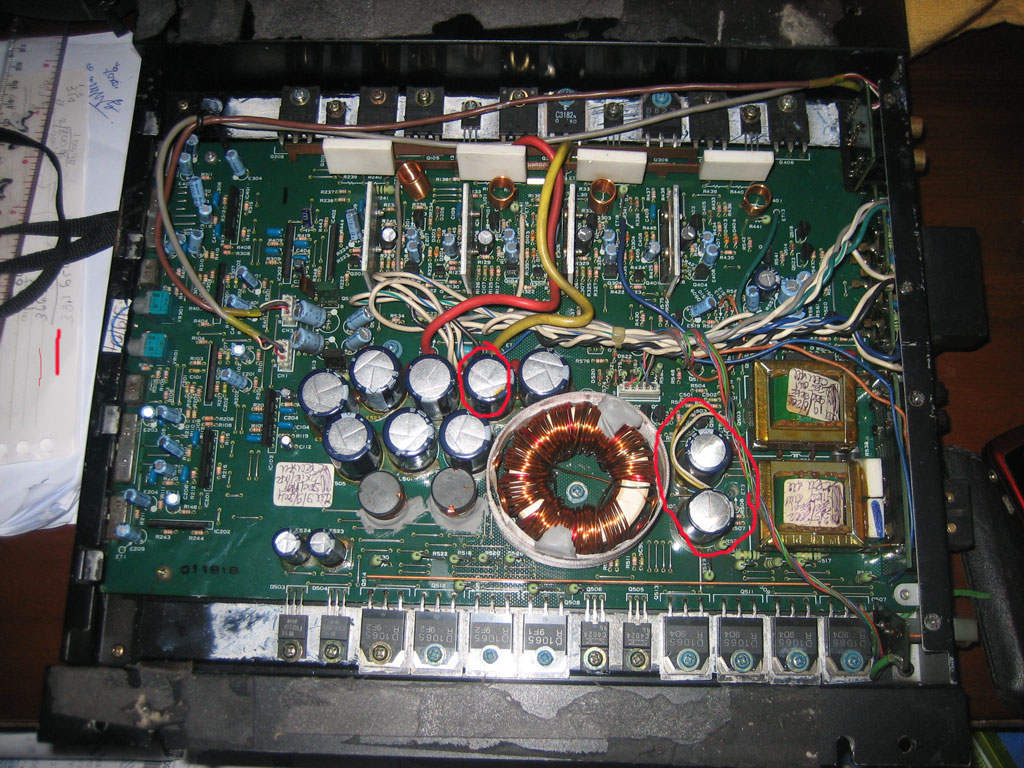

Im trying to fix an Alpine 3554. its blowing fuses and even melt the sockets of the fuse.
I checked some of the transistor, for each channel it uses, 2sc4387 and 2sa1672. On one channel, repair has been made and it uses 2sc3182 and 2sb827.
While the transistor is intact, the previously replaced 2sb827 has shorted legs. So am i correct that this is defective?
Where can I get the replacement parts for the 2sc4387 and 2sa1672. I want to restore it back to them its they are still available.
I noticed some capacitors are getting bulged a bit, should I replace them while I fix the transistors?
How do I remove the caps which has been epoxied?
What other things should I pay attention to an amp this old. I really like to fix this.
Thanks much for the pointers.

Attached is the suspected caps. I will try to remove the shorted transistor. I havent opened up the amp yet.

The two in the power supply look like they've overheated and need to be replaced. The ones in the audio section don't appear to have overheated.
For the power supply capacitors, try to find 'low impedance' replacements rated for 105C (temperature).

Havent test run it yet. But the overheated power supply caps are out, I checked by charging with +6vdc, and measuring the voltage across. 1 is slowly declining in voltage, the other one is much faster. So will replace both of these.
Can the failure of this cap somehow blown the output transistors?

The 2 470uf capacitor near the dual-rectifier are rated 35v, does that mean I can use a 35v rating for the 8 ps caps?
Ben
Ben
I know of no way that the primary filter caps could cause the failure of the output transistors.
If the two small caps near the rectifiers have one leg connected to the center leg of the rectifier and their other leg directly connected
(~0 ohms) to the secondary ground (non-bridging speaker terminal), you're probably correct and you could use 35v 2200uf caps but you need to confirm that the rail voltage is no more than ±35v. You should reinstall the primary filter caps (the two you removed) before applying power.

You are correct. The 2 caps are connected to center legs of the duals, and the other leg of the caps is connected to the non-bridging terminals.
Will measure the rail voltage later to check if its more than 35v.
Can an output transistor blow without blowing other component?

In amps that use driver transistors instead of the driver ICs, it's common for a single output to fail without doing further damage but I don't remember if that's the case with the amps that use the driver ICs (I haven't worked on many of them in the last 10 years).
