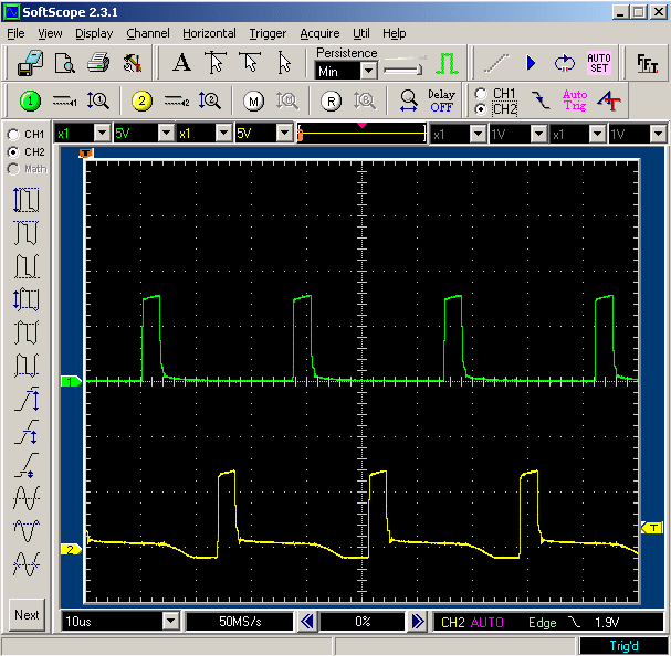

Ok, parts finally came in. I replaced the drivers (KTA1266 replaced with KSA1015 and KTC3198 with KTC1815). Amp is drawing 1.3 Amps, and output relay clicks on. Nothing gets hot except the 7812 and only after a minute.
The two sets of IRFZ44N gate waveforms depicted below. With the board not attached to the heatsink, is there much danger trying a very small audio input to drive a 4ohm speaker at very low volume? The amp would be connected to a 1amp limited supply for the test.
I would Bolt it back on the heatsink before any more testing is done to ensure cooling is achieved.
Drivers look better, Could you measure the waveforms before the resistor to the IRF44 fets. That liitle bump at the bottom of the waveform is interesting. and the Top is not fully square, Is your Probe DC connected?

Yes, the probes are set to DC coupling. That waveform was identical before and after the resistor to the IRF44 fets.
I wan't sure what to make of the below zero signal or the rounded tops...

Am I ready the Waveform correct that the Peak Voltage is around 8v.

I agree with brettcoupe. That is not even 8v. When testing use recomended input voltage for amp (12-14v).
Also can you check any resistor in path to gates and tell me where they are (before/after buffer....) and their value.
7-8v should be enough to fully open this fet, but I would be more happy if I would see it around 10V, coz you should have almost full voltage when gate is turned on.

All 10 of the resistors going to the IRFZ44 gates are 100 ohm. Both before and after the resistor, on all of them, the waveform is nearly identical and look like the image I posted earlier.
The image below is the TL494 Pin 9 output (yellow) and the corresponding buffer output (green). Note that I changed the voltage scale on this image to 5v/div.
According to the IRFZ44N datasheet, they are fully on at a maximum of 4 volts, so 7-8 volts should be plenty, even given a supply voltage drop. I'm no expert with this, but it appears to me as if they wanted to avoid fluctuations in the gate voltage...???

In this image you see the +batt voltage dropping to +10v with the amp turned all the way up and the input turned way up (input from a portable cd player).
The IRFZ44 gate is the green, and the yellow is the +batt voltage.

It Looks Better
However I still think that the driver O/P should be Higher V and Cleaner on the zero V line.
Also I hope that Spike thats on teh Batt Trace and on the Green Trace is due to the Inductive Pickup of the Core into the Probe lead.
Are u able to sketch out the driver section schematic?

I am just concerned that the Driver is not turning off fully, and leaving a bit on after the Pulse. if you look carefully it looks Like it is up around a 1-3 volts briefly. This could cause some leakage and minor Cross over of the Fets It could also account for the Spike and it kinda co-incides for when the driver goes Off properly.
I gather this driver stage is a pair of Transistors One to + and One to GND . One Set per Side.

I think what your problem is Batt sag, if you could keep it higher then 13v at all times, you would get more power out of it.
From pic that you posted, it looks to me that your amps duty cycle is almost 50% (D.C. + some dead time).
Output coil heating? Normal coz this is Damp, so heating of output coil is normal even at idle.
Gate turns on from 2v to 4v, but for fet to conduct large amps, it need more voltage then that.
