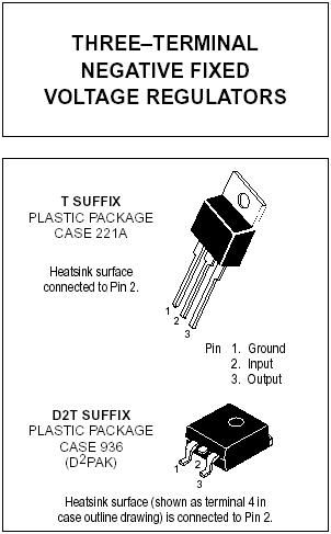

The 40V rating of the capacitor has nothing with this to do but I'm not explaining why since you told us to leave out the basics.
If you are using the TO220 version of the regulators, make sure the 7915 mounting tab is not grounded, it's connected to the output (middle pin).
Other things to try, connect small 1 to 10 uF capacitors as close as possible to the input and output of the 7915. Negative regulators are more prone to oscillate.
Yes, centre pin is output on these, not ground.
I attached a picture that shows the middlepin as being the input. Pin 1 is ground and pin 3 is output.
Ops!
My memory isn't what it used to be, middle pin is od course the input. Sorry for the confusion
