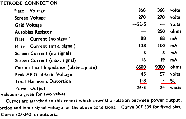

> The figures given in the 807 app report do reference voltages to ground. They shouldn't've, but this is quite common when dealing with VT specs.
That line should read "Plate Supply Voltage"; someone had tired fingers.
In commercial design, you are "given" a certain voltage (maybe the Buyer got a "deal" on some odd-volt power transformers) and you have to make the most of it. We assume that anyone can read "300v, 250Ω cathode resistor" and know the actual voltage across the tube is less.
> I assume that self bias would be essentially identical to fixed bias.
Only if the individual tubes have ZERO 2nd-harmonic distortion.
Real tubes have significant 2nd-H nonlinearity. 6L6/807 has a lot.
From a typical grid bias point, going 10V positive may increase current 50mA but 10V negative decreases it only 40mA. Tube Gm goes down with current.
The most obvious proof is any tube-manual condition for single-ended operation. The plate current should be the same at idle and at full-signal: in fact it declines significantly at full signal.
Look again at Miles' 807 data. For self-bias we have 88mA+5mA= 93mA flowing in 250Ω, grid bias voltage is -23.25V. For an ideal tube working in "good" conditions, the peak grid voltage will be equal to the grid bias (fixed-bias shows 45V p-p or 45V/2= 22.5V peak for 22.5V bias). But the self-bias condition shows 57V p-p or 28.5V peak... from a -23.25V bias point? They are not driving the grids positive, they are swinging current up and down, and tube nonlinearity means more up than down. Cathode current increases, which shift the bias voltage. I figure 114mA, the chart shows 119mA, good agreement.
And that's ignoring load current. At 6K6 load, the cathode current wants to go up to 154mA. If we were using the 250Ω cathode bias resistor, the grid-cathode voltage would shift to -38.5V. That kind of major shift would put the tube at very low Gm at the zero-crossings (what sand-heads call crossover distortion, but much softer) and a high THD number. To keep that from looking too bad, they spec a higher 9K load for lower signal current.
If the load impedance is very-very high, or signal current is very-very low, then yes: self- and fixed-bias come to about the same thing. But power is very low too. For "interesting" impedance, current, power, self-bias is like a "fixed" bias that actually varies with signal level.
All of that assumes perfect bypassing. And no positive-grid overdrive. Even so, I don't believe the 2% versus 4% sheet-spec has anything to do with electrolytic distortion. Those guys were clever enough to fix or subtract any flaws that were not really in "their" tubes. Cap-distortion will vary with frequency, tube distortion won't, so they could quickly check for cap-crud. While they used the $0.10 caps in the consumer products, a Lab has $1.00 electros and $100 banks of oil-caps they can use to "perfect" their measurements. And it is reasonably valid to use the resistor to find the full-power bias point, then replace it with a tapped truck-battery (0.1Ω dynamic resistance) to take the THD measurement.
But self-bias does not have a bad rap in speech/music work. We don't have sustained full-power tones. Musical dynamic peaks are short enough that a $0.50 capacitor (couple-hundred uFd) will not change much before the transient is passed. Put a voltmeter on a self-biased amp's cathode resistor and play music. If it idles at 23.25V, then most normal playing will stay there or rise to maybe 23.5V occasionally. Driven into the edge of audible clipping, it may rise to 24V, with hard-rock maybe 25V. But speech/music can't force a decently-bypassed self-bias stage all the way to the 28.5V bias that we see in steady-state test-tone testing, not unless it is "beyond gross clipping".

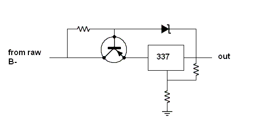

Since the subject of a clean negative bias supply has been raised, could the brains on the forum suggest a compact way of getting such a clean supply?
Its easy, a regulator is not needed at all as the current draw is neglible as long as we are talking about class A1, AB1 or even B1.
Use a rectifier bridge, a cap a series resistor, a cap, a series resistor, pot and resistor in series to ground and then a cap at the viper of the pot.
In my OTL i use 100u, 22k, 220u, 22k, 22k pot and 39k, with 220u at the pot viper. this is compeletly silent and has no effect whatsoever on the hum level, in a push-pull amp the requirements are very low any hum on the bias is cancelled due to balance, but the circuit I describe is more than enough for any SE-amp also.
To use an electronic regulator for bias is serious overkill and a complete waste of time and money.
A problem with using a electronic regulator is that the bias voltage stays fixed even when the mains and anode voltage is dropping which means that the cathode idle current goes down.
What you need is that the bias voltage also is automatically adjusted so that the cathode idle current stays the same, this can be sometimes easily achieved by using a zenerdiode in series of one of the series resistors of the circuit described above.
Without the zener the bias voltage usually will drop to quick which means that the cathode current increases, (at least for high Gm tubes)

Ok, I'm missing something here. I've assumed that the function of the bypass capacitor is to keep the voltage at the cathode constant for music signals (bypassing AC). If that's true, I don't see how that differs from fixed bias (perfect cap assumption). If the cathode/plate/ grid voltage relationship is the same in both cases, output should be the same. And signal swing should be the same. Charging the cap to a higher level under clipping makes sense, I think I get that. But otherwise, I don't see why the current in the tube should be different from the fixed bias case. Are those chart values taken under static conditions? That would be different. Sorry if I'm slow. I'd like to understand this.
One thought; even with a perfect cap, you'd see some ripple at the resistor/cathode. Is that what leads to the higher distortion?
Sheldon
BTW, I really appreciate your posts. You go to great lengths to provide a detailed explanation.
There is no difference all things being equal. But all things aren't equal- in order to keep that bias reasonably constant, the tube operating conditions are generally changed so that the cathode current doesn't vary as much from idle to full power. In theory (and maybe more than theory), you could trade off being able to run sustained power levels above the idle and bias up an automatic bias output stage to run the same conditions as fixed bias. Mullard had a nice little treatment of this in their tube book, calling it "low loading."
Low loading is a fine and efficient way of running automatic bias, BUT it is not suitable for loud music with limited dynamic range (i.e., most pop). And it's unsuitable for test bench analysis, but that's a pretty liveable trade-off.
Thanks Both,
I think I've got it. It seems the significant issue is charging up that cap so that the cathode voltage drifts higher. At lower outputs, the circuits are mostly equivalent, sonic subtleties allowed for. I wasn't weighing in on one side or the other, just wanted to understand the issues.
