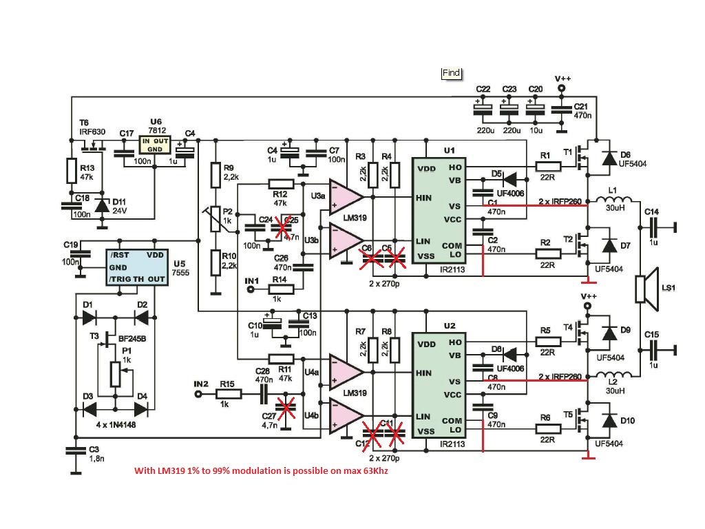

I already made it , triangle wave is perfect.I made everything in modules to test it and it works perfect(very messy setup 🙂 ).Probably i will make proper layout in Protel and assemble it as one design.I am to bussy now but in next few weeks probably i will make it.
Well,some more fixes
I defined few things here.Max modulation and highest efficiency is possible on frequencies at am of 65KHz couse comparator is slow.Also few caps r making performances to be lower than they can be good.
I think those capacitors were to slow down switch on of mosfets.
Another method is to discharge mosfet gate through a diode but charge it up through say 10 ohms.
C5,C6,C11,C12 are for dead time adjustment.
The required values will depend on the chosen MosFets, chosen gate drive impedances and the desired trade off regarding idle losses vs dead time distortion.

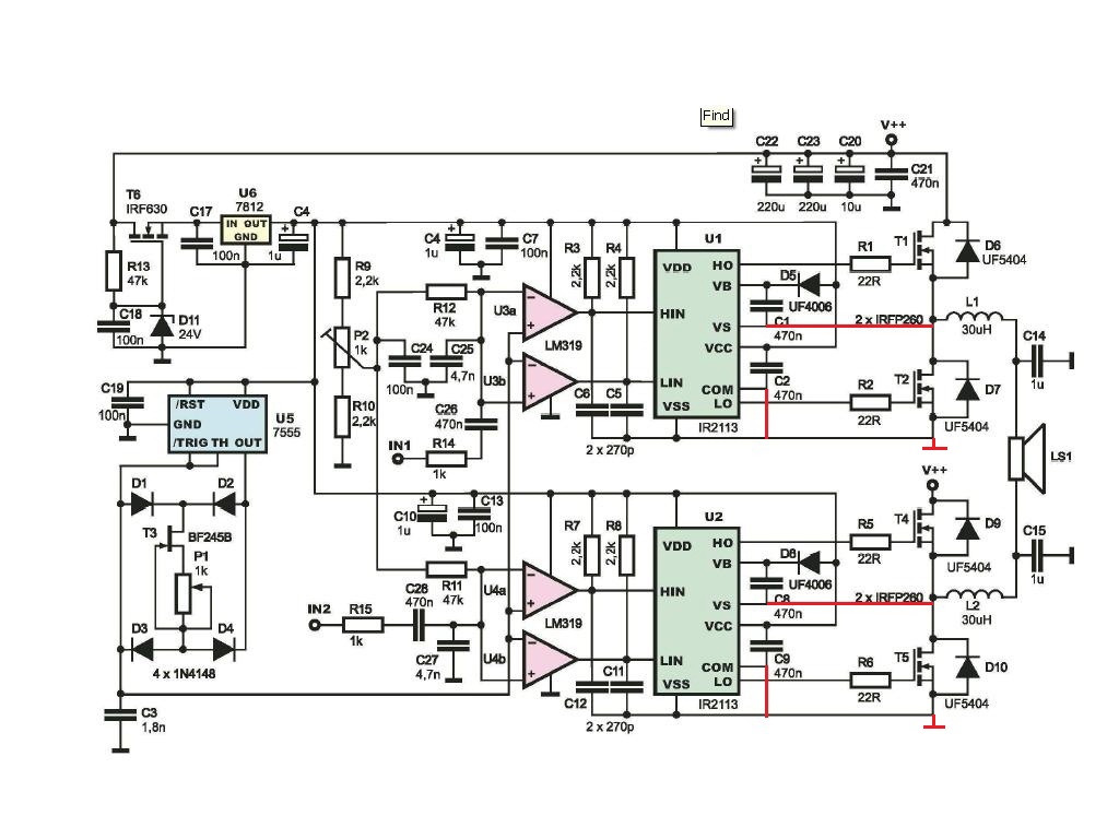

- Class D
- Fixed "mistakes" on great sch :)
