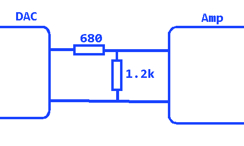

question about diagram
(I've never replied on any forum and hope it works okay..)
Thanks for the diagram PRR... i assume you are simply trying to say: use an Lpad circuit to attenuate? Is that what you are suggesting-- because I don't understand the actual values you have in the diagram. The values themselves seem like they would not result in enough attenuation? -- thank you.

Thanks again rayma for pointing that out about the diagram. With 1.2K series and 680 ohm shunt PRR is dropping the voltage to 0.64V max which is about -12db. But that again brings up the question as to: why use 1.2K versus 12K for example?-- thanks again...

calculations from rayma
Thank you again rayma. You have cleared up something in my brain. I wasn't sure how to include the output impedance of the DAC in any calculations. So all my calculations have been off (including my calculations of PRR's circuit). I wasn't realizing I needed to include the 100ohm resistance at the output of the DAC as part of the signal path... meaning that as the DAC gets loaded it will always drop some (small) voltage over that 100ohm resistor. Very helpful. I was able to use your updated values and include the 100ohm resistor to verify in my own mind that you indeed dropped the voltage to 0.75V. Is that what you typically aim for (allowing max input) or do you ever target something lower than max? Thank you!
Thanks for the diagram PRR...I don't understand the actual values you have in the diagram. ....
I have two sick dogs here. They distract me and I can't keep a thought together. As Rayma figured, I swapped the values. Big dog little dog, big resistor little resistor, big/little dump on the carpet.
_I_ would not be afraid to put 2k load on a DAC. But the values Rayma suggests are not much higher and we are nowhere near the hiss level.
