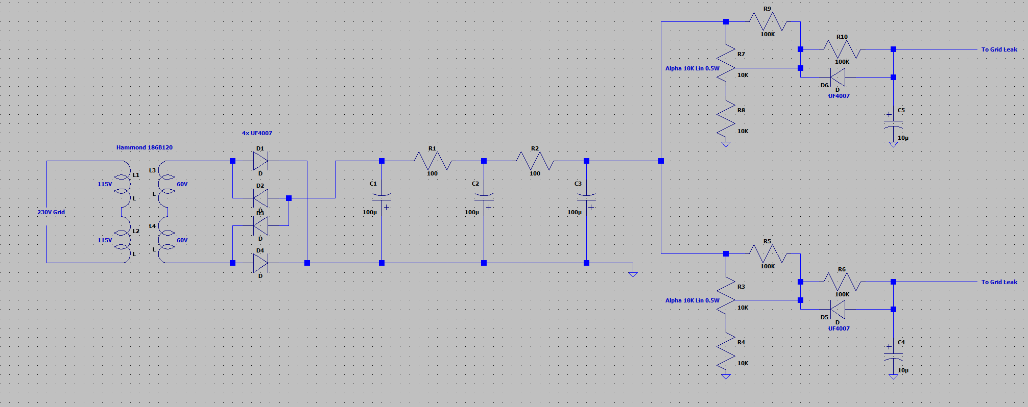

Here is a schematic of my Bias supply, i copied it from here apart from the Rectifier and Filter.
Edit: Just noticed C4/C5 are connected in reverse in this schematic, they are the other way round in reality.

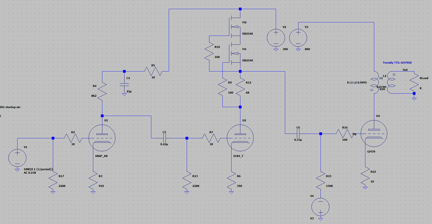

And here is the schematic of the Amp itself:

Measured Driver Stage by itself, without GM70s inserted: Gives me clean 180Vpp on both outputs without oscillation
So this makes me think it's some sort of interaction between the tubes, but where are they connected? Could the two Bias "Legs" interfere with each other somehow? Output Transformers are connected correctly, at least according to Toroidy's Datasheet. Secondary Ground is connected to Amp Ground.

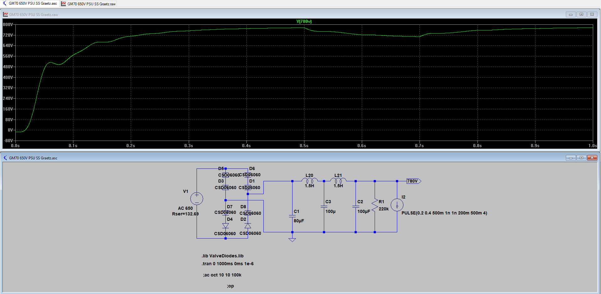

PSU uses 650V 0.3A transformer into 1.6KV bridge -> CC->L->C->L->C. Caps are 40µF 1.1KV Epcos DC Link. Chokes are Hammond 159V installed in the ground leg. PSU ground is connected to amp ground after the 2nd choke ofc.

You should try to short the two chokes and with just all capacitors in parallel to see how it work

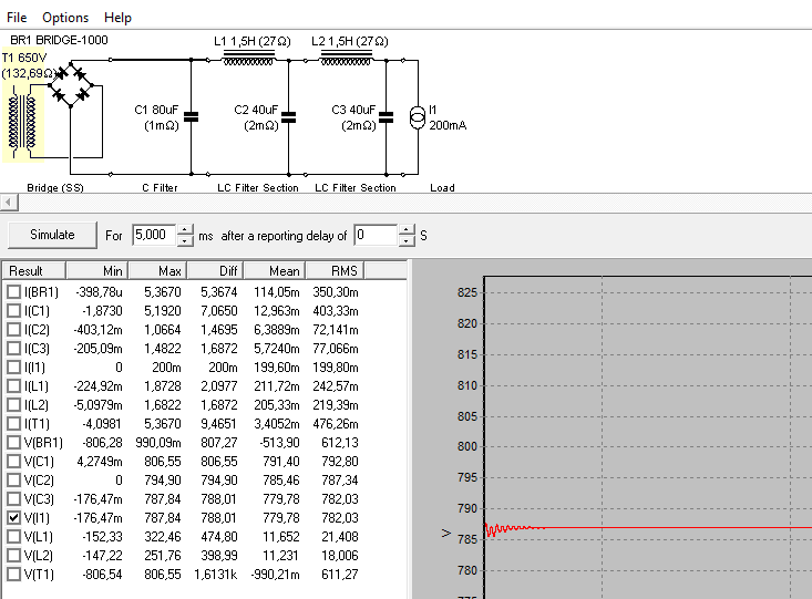

This is likely a low frequency phase margin problem, not just DC voltage sag.
Add more capacitance in parallel with C3 in diagram in post #5 (at least 100uF more) and see if the problem is reduced.
You may need to add even more than that.

rayma, i will see what i can find in terms of additional caps and try that. This guy seems to use the same configuration but with a single 10H choke without issue tho.

euro21, so more capacitance? I cannot observe this extreme sag when measuring and the voltage is higher than in the simulation. 900V with a single tube running at 100mA, sim shows 840.

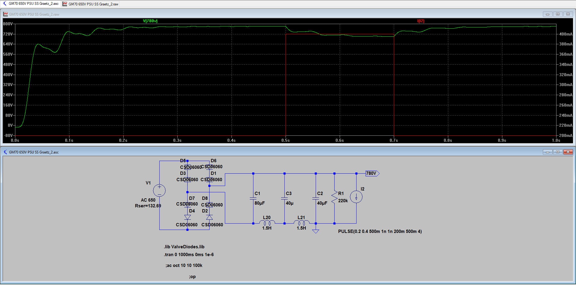

At least short out L21, if you don't have more capacitors to parallel with the last capacitor.
That alone may help enough.
Maybe he could move one 40uF from input to output ...
disso , the voltage is not sagging , the inductance and capacitance have such values that is oscillating . Of course adding more capacitance is always the solution . But if you don't have more capacitors maybe could be rearranged .
