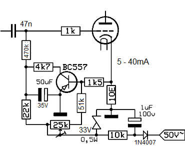

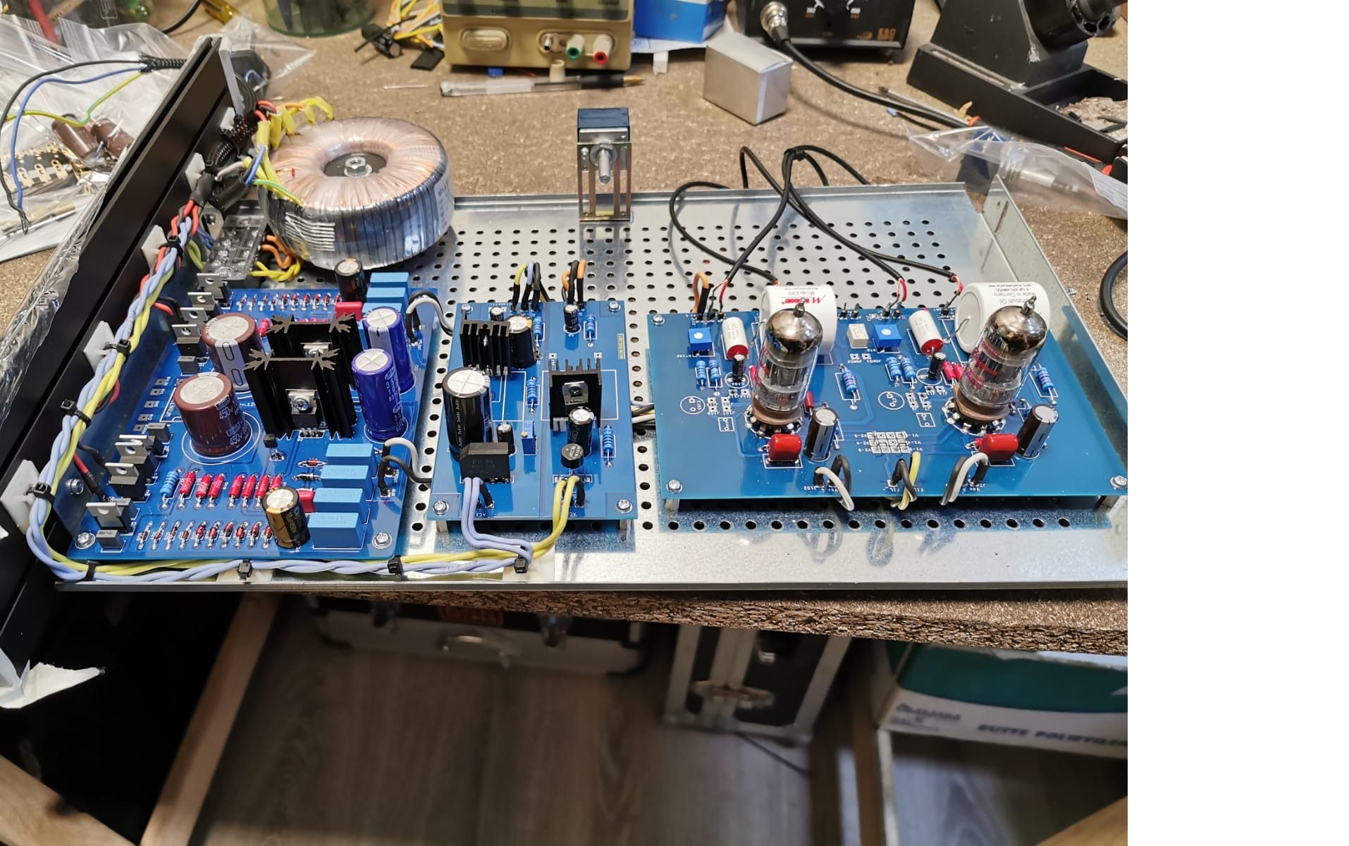

Hi
in attach the photo of a project I have develpped years ago and now available.
It can use some tubes and mainly 6H30 with fixed bias ( in the photo) or autobias just with little changing in jumpers.
The negative bias is done with a 7915 the a trimmer. And HT is ss regulated ( mandatory)
It works great without any problem with this solution
Walter

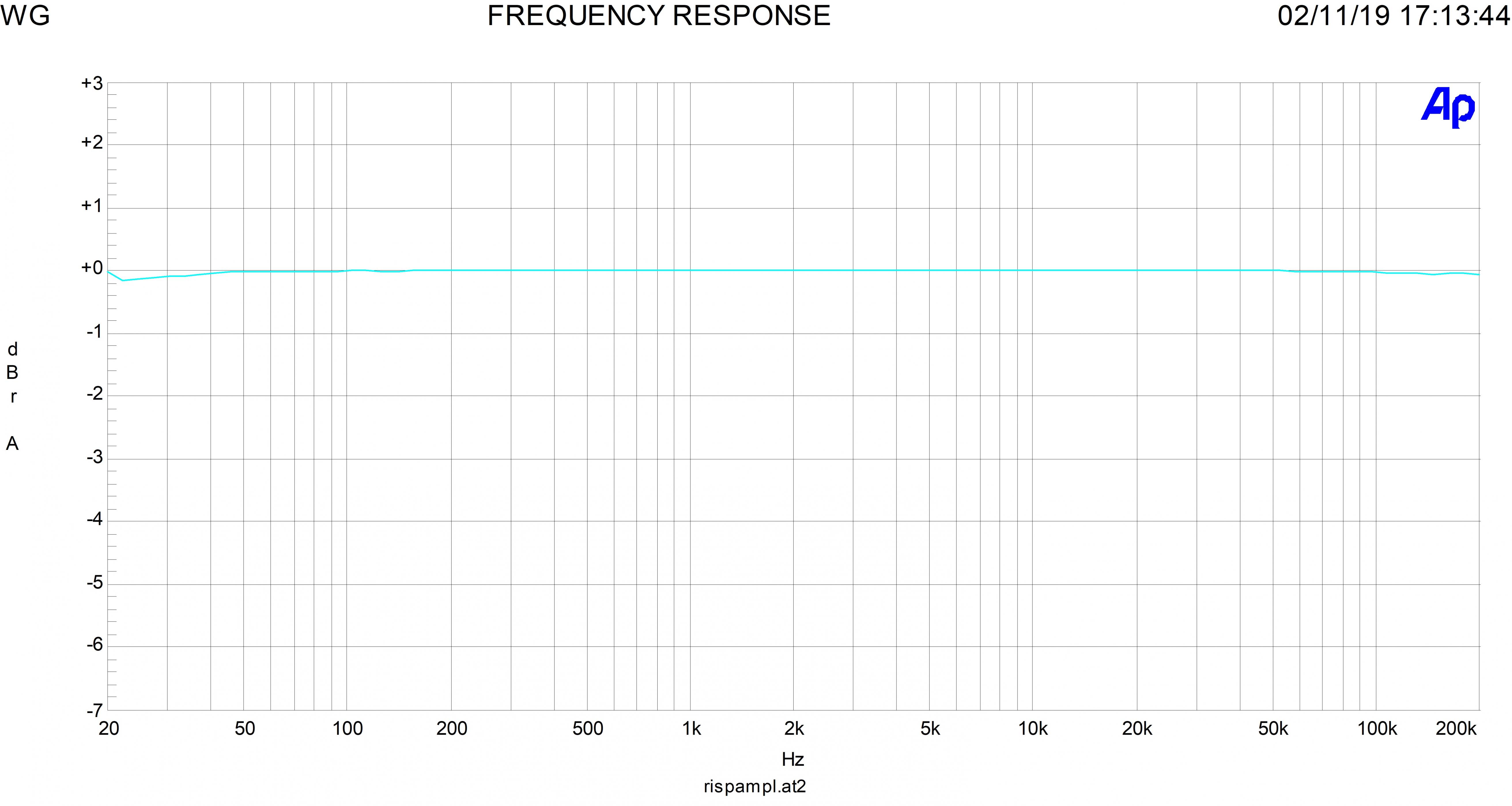

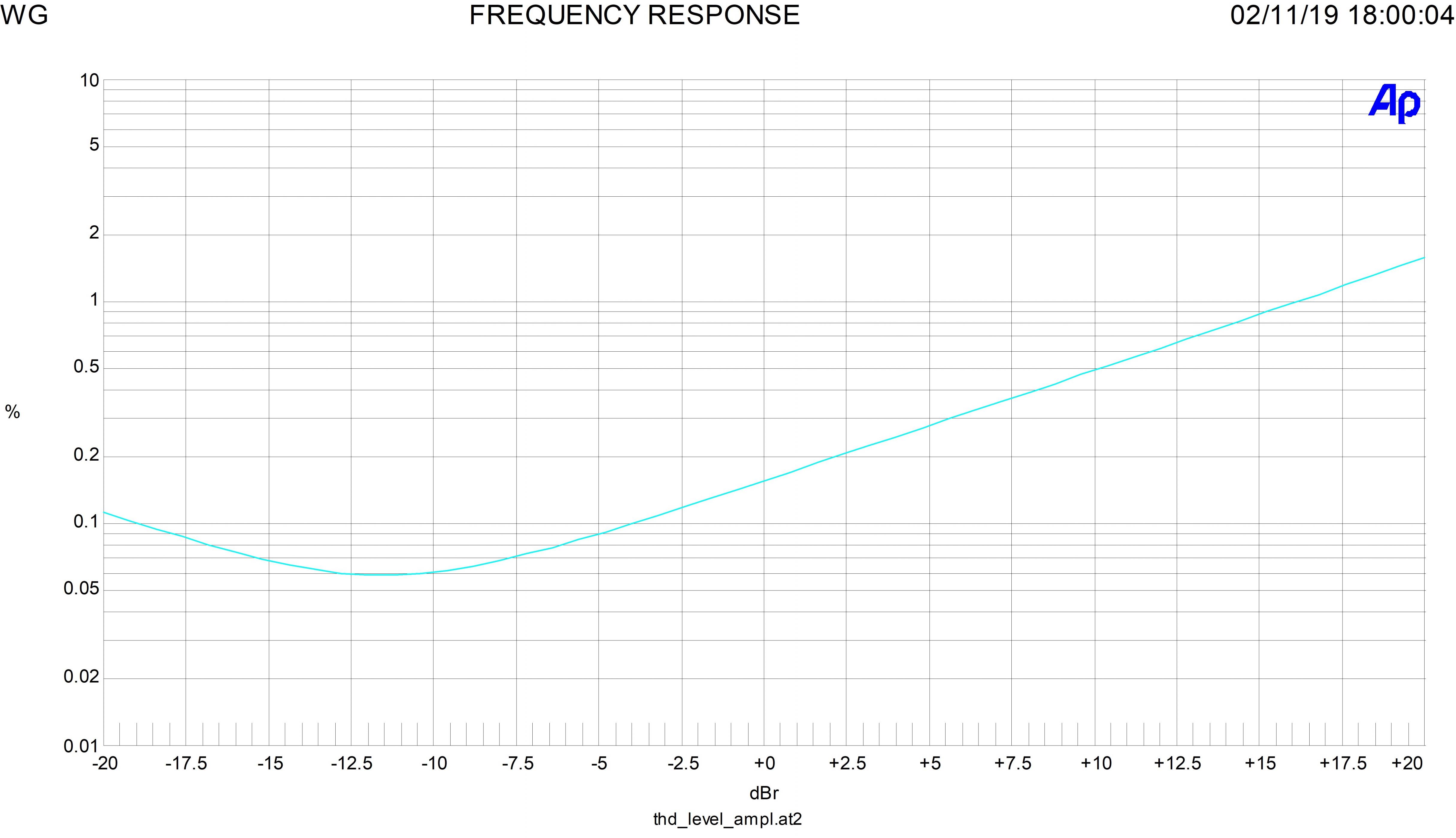

In attach the schematic
It is a simply CF but with the possibility to change some tubes changing the jumper fo filaments
Family as ecc88/6H23/pcc88/6N6/6H30/12BH7/ECC82 etc.
With jumpers it is possible to have a fixed bias or autobias
In addition the thd vs level; the 0 dB is 2 volt, +20 dB are 20 volts
Then the frequency answer

waltube,
Thanks for posting the schematic.
The input stage appears to be a combination of Self Bias and Fixed Adjustable Bias.
I do not see a stage that is only fixed bias.
But I do not know the resistance value of the cathode resistor. It appears to be large enough to require the option of using one or more bypass caps (the pads that seem like they might be jumper-ed or not). Most would not use a bypass cap of the resistance value is very low).
That indicates to me it is using combination bias.
I see a way to jumper out the fixed bias, but I do not see a way to jumper out the self bias.
Your Cathode follower is self biased, the un-bypassed cathode resistor is self bias.
From there, it is connected to a coupling cap to the output.
Oh, just for others who read this, what you call auto bias, I call self bias.

I assure you that you can configure the input stage in two indipendent way.
Fixed and self bias ( if you prefer.)
Just with the combination of jumper that can fix or amovible and reversibke in case.
In case I can explain you the way If you can't see the two method.

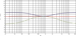

I forgot to mention the possibility with three jumepr /channel to insert the tone control
In attach the schematic and the board
In addition the response with 6N6
The the esaltation and attenuation is not very hard
Walter

waltube,
You are right.
I did not look hard enough.
You can jumper from either J107 or J109, to J115.
That bypasses the self bias resistor.
Thanks!
