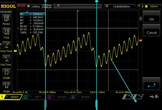

I want to build a PP-Amp with fixed bias. I tried different autobias modules like tentlabs, but they smoked after a while tgem self to death. So, in a perfect world, a switch beteen the measuring resistors, a stationary voltmeter and round knobs to be used without screwdriver would be cool...or is there a better way ? It would be nice to see some pictures ...?
Just implement it like this (attached). Doesn't get much simpler. Metering consists of 10R/0.25W current sense resistors in the cathodes. These should be sized small so they act as fuses of last resort.
The metering is with a 100uA meter with a series resistor to set the full scale. I calibrated it by setting up a 100mA CCS with a power transistor to set the current. Used a 100K pot in series with the meter and adjust to 100uA. Note the series resistance. In this case, it was a little over 7K, and within a couple of ohms of a combination of 12K + 1K. A small on-off-on switch selects each final for bias adjust.
