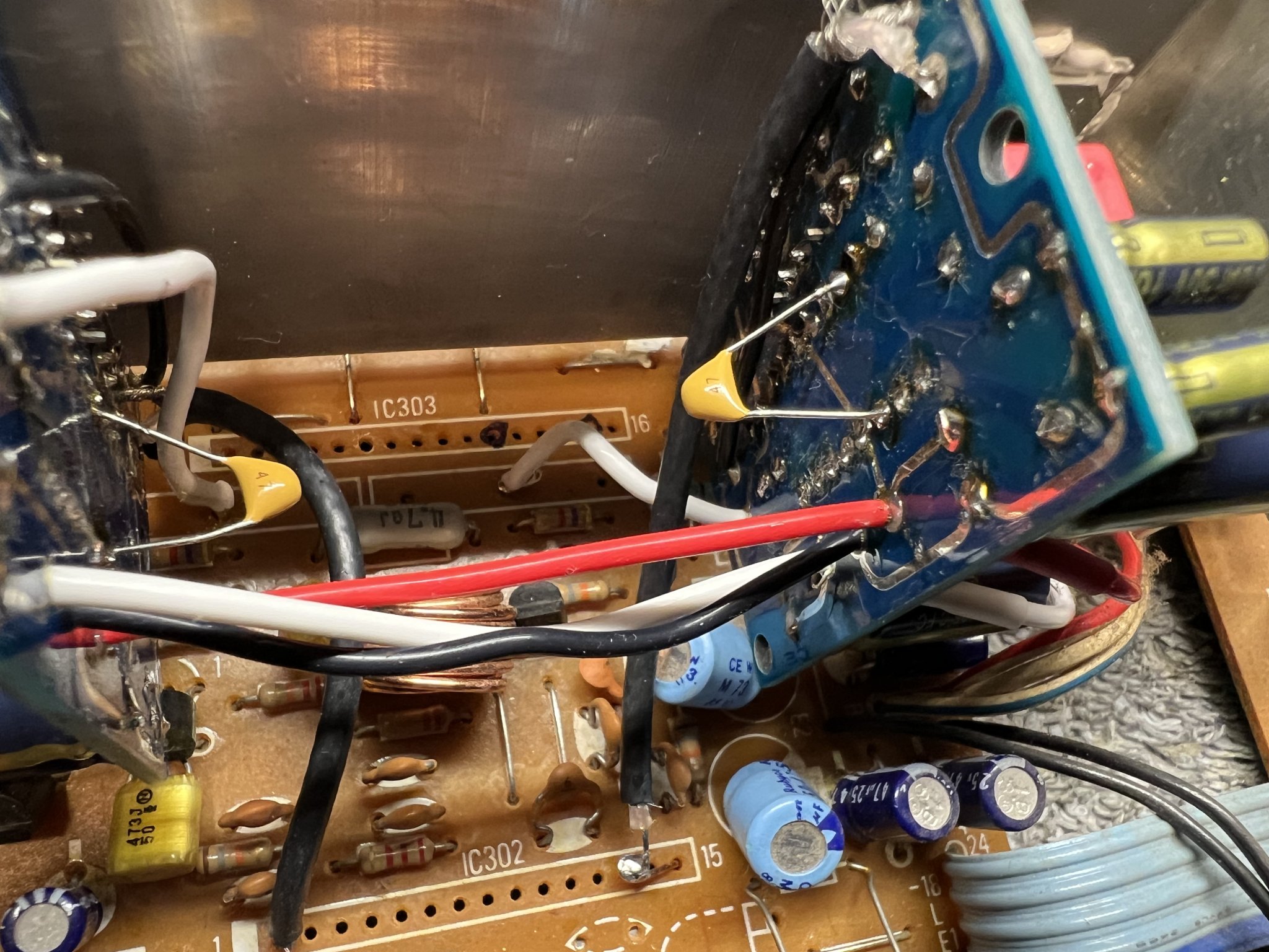

All of the grounds on the amp connect on the same ground trace; those being ground for the power supply, negative speaker output, and ground for the input. Even though they all connect together with the traces, I also ran wires from their holes to each other on the board and all the grounds for both boards met at one wire that went directly to the chassis, right here. You can see the screw right under the heatsink. I went for as short of a run as possible.
The audio input for each board came from where the input pins of the old STK3042 would have been. The wire going from that position on the board to the TDA7294 board is a shielded coax cable, shielding being connected to the ground of the TDA amp board.

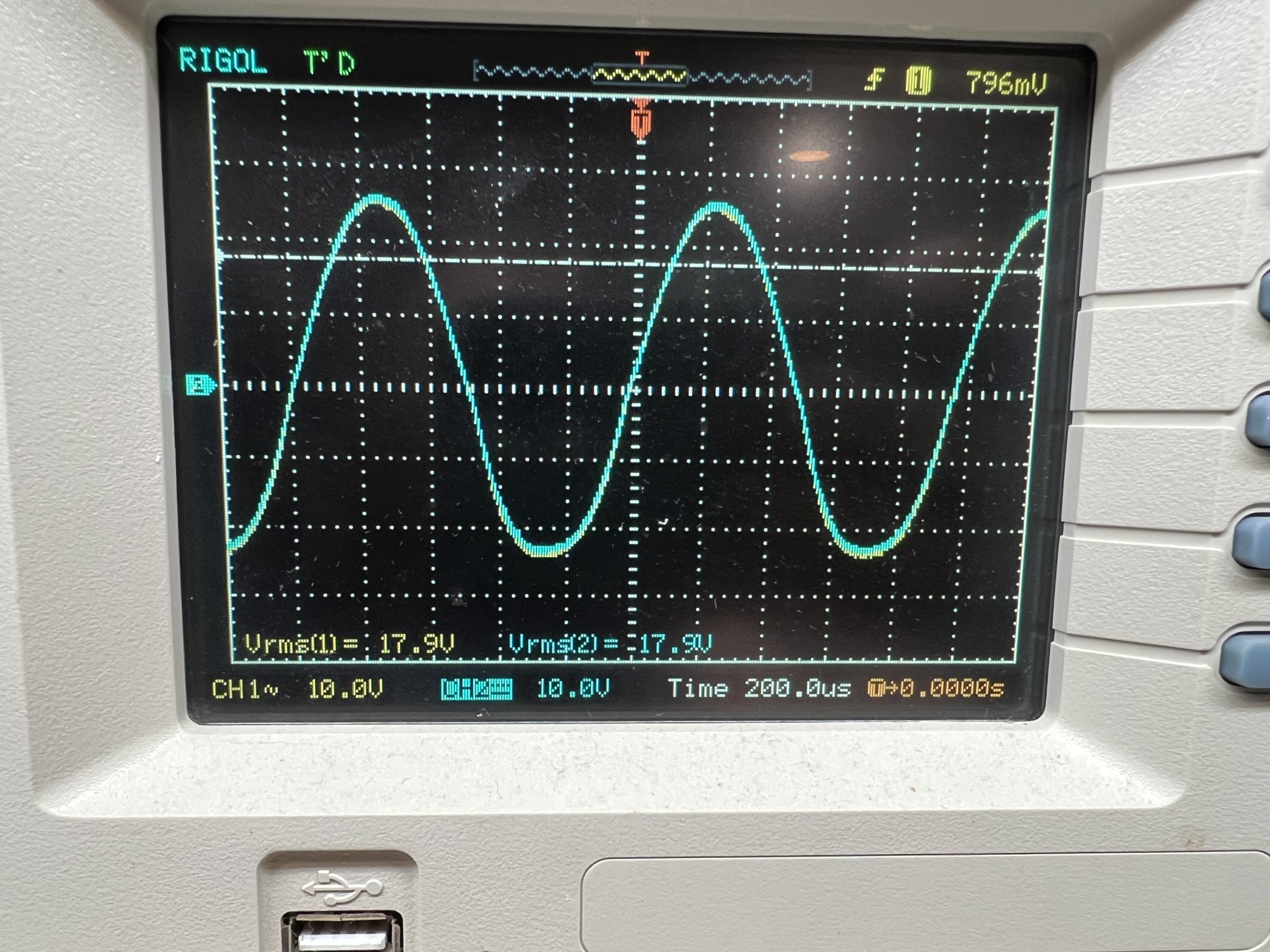

Here you can see the output of the amp, the trace is fuzzy since it has that 430 mV of hum riding on it.
Any suggestions on why I have that hum? Any suggestions as to how to get rid of it?

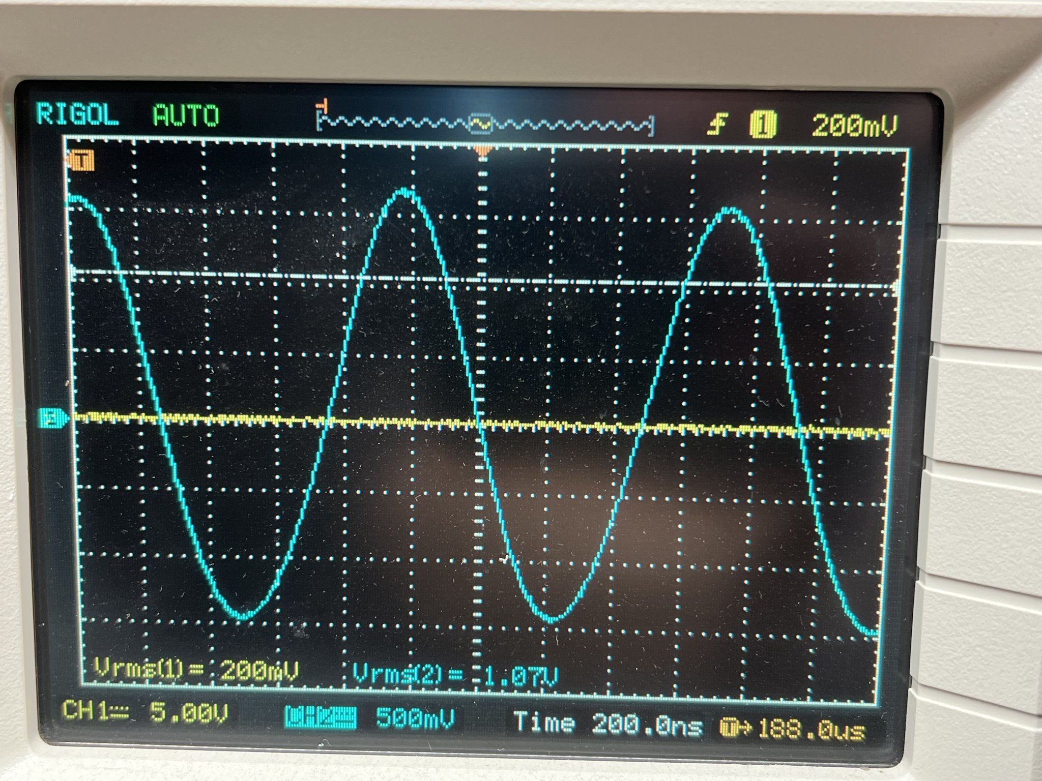

Your amps are oscillating for some reason. I guess you were showing a 1 kHz signal, weren't you? The fuzzyness on the scope never do result from mains hum, but from a very high frequency (much higher than 1 kHz). This may also explain why your chips are getting that hot with no drive.
Best regards!
Thank you, I was wondering if it was an oscillation, here is an image of it close up. And yes, the output signal I was showing was 1khz. I need to figure out how to get this scope to display the frequency it is seeing.
Would I be correct in thinking this is a little over 1 MHz, like 1.1 MHz? I’ll probe the power supply and the input, but I’m guessing it’s originating at the chip. Any thoughts as to what would cause this? I’ll post pics of the boards I used later.

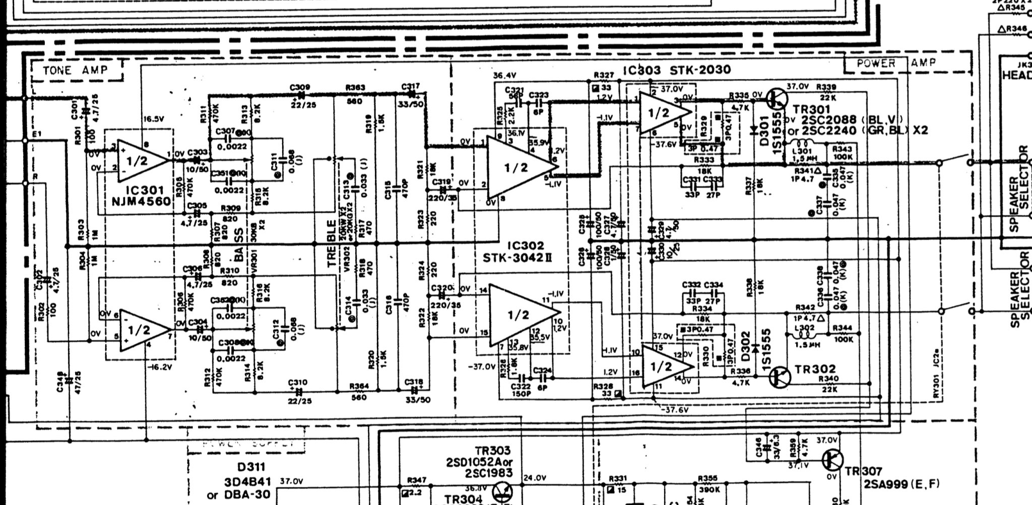

Kindly post the schematic of the amp in question.
Here is the schematic of the R-300. I’m taking the signal from pin 1 and pin 15 of the STK-3042 and the output is going to directly to the junction of the two 0.47 ohm emitter resistors. Emitter resistors have been removed.

As far as I can see the only components missing from the yamaha pcb are IC302/303 and resistors R320/330, everything else is still on the pcb. If you already have input reference and feedback resistors on the TDA7294 board, you have a problem...they will be in parallel with the input reference resistors R321/R322 and feedback network (R333//C331+C333, R323-C319) and the same for the other channel (R334//C332-C334, R324-C320).
Also, you have a problem with grounding and PS lines, but you will deal with that later.

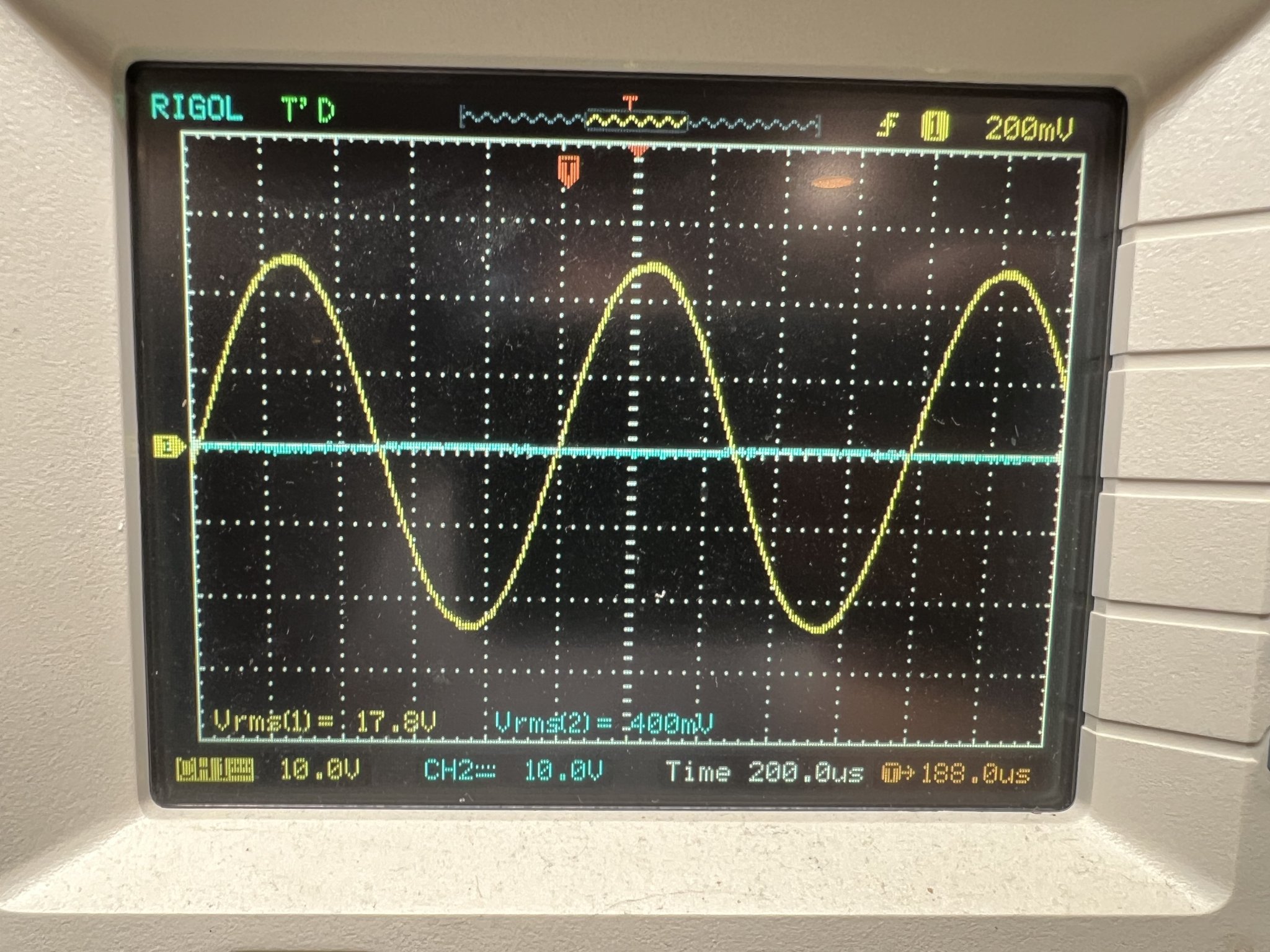

Got side tracked and wanted to come back to this. So I placed a 47 pF cap across the 22k resistor you suggested.
The hum and oscillating is gone. The heatsink no longer gets warm. It plays audio, but there seems to be a fluttering to the sound. Best way I can describe it.
Here is the waveform, doesn’t look great.
Thank you for your input. Are you suggesting I remove those resistors and caps from the Yamaha board?
