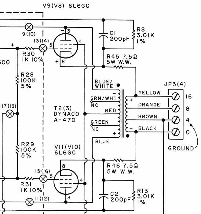

Grounding the 4 ohm tap was also a modification that ARC did to the ST-70-C3.
ARC successfully abused standard Dynaco iron, don't see any reason the same
trick woud have caused Fisher to go winding a custom? Its probably standard
Fisher iron, but just guessing...

Of course Dynaco iron will not fit, that wasn't the point. The point was
to show an example rewiring the usual 4 ohm tap as C, not so unusual.
And did not require a specially wound transformer in that other instance.
I have not yet seen a Fisher C3 schematic to confirm or deny it abuses
ordinary iron and the same center tapped output trick as ARC's modified
ST70... After mod, the ST70's usual C and 16 were fed back to cathodes.

Now please glance at the schamatic at the bottom of the following link:
audioresearchst-70-c3amplifier - mpbarneyamps
Nevermind the pre-amp section, just ask if the strange output transformer
rewiring looks like your Fisher X-100-C or not?

YES....that diagram looks very similar. However, I note at least one difference, that being that the 4 ohm tap on the ST-70 Mod is NOT grounded....where it IS grounded on the Fisher. And, like you said...the driver circuits are different once beyond the OTs, so I didn't go much further. I DID manage to extract the subject failed OT from my Fisher this evening.....and it is indeed 'Half-Dead'! Its funny that it's also half good, which disguised it's failed nature. But.....I'm pretty confident that once I find a suitable replacement, and do some basic 're-capping'.....I'll have a pretty nice amp to listen to for a long time to come. I wish I could just go buy one of these things some place....although I think the price tag might be about a week's pay for me! Anyway, I'll keep looking....and to anyone else who happens to be reading this thread.....if you can help me find an OT for this Fisher X-100-C......I'll be REALLY grateful!! Many Thanks Ken. BTW....the primary on the Good Transformer....tubes removed so no load or connections of any kind: 300 ohms...or actually about 295. One side measures about 150 ohms and the other is about 145. And, the 'good' side of the 'BAD' OT measures 149 ohms......so.....I guess that's a starting point! Thanks again, Regards, Tom
ARC's 4 is definately grounded, I cropped the schematic is all.

Well......'yes'.....I did go back to the Schematic on that ARC amp and I saw where the 4 ohm tap was, indeed', 'Grounded' on the 'star-ground'....back after that string of diodes! So, I guess that setup is nearly exactly the same.....as far as I can see.

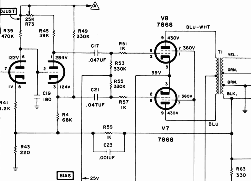

I see GNF, not the same thing at all.
Not sure why they ground 4 rather
than reverse phase of transformer?
Something to do with center channel?
Whatever...
Service manual suggests testing with
25W dummy load, so guestimate 25W?
Also figure about +/-300V plate swing,
what impedance ratio is this? I gots to
go git my Jethro Bodine hat an' cipher...
