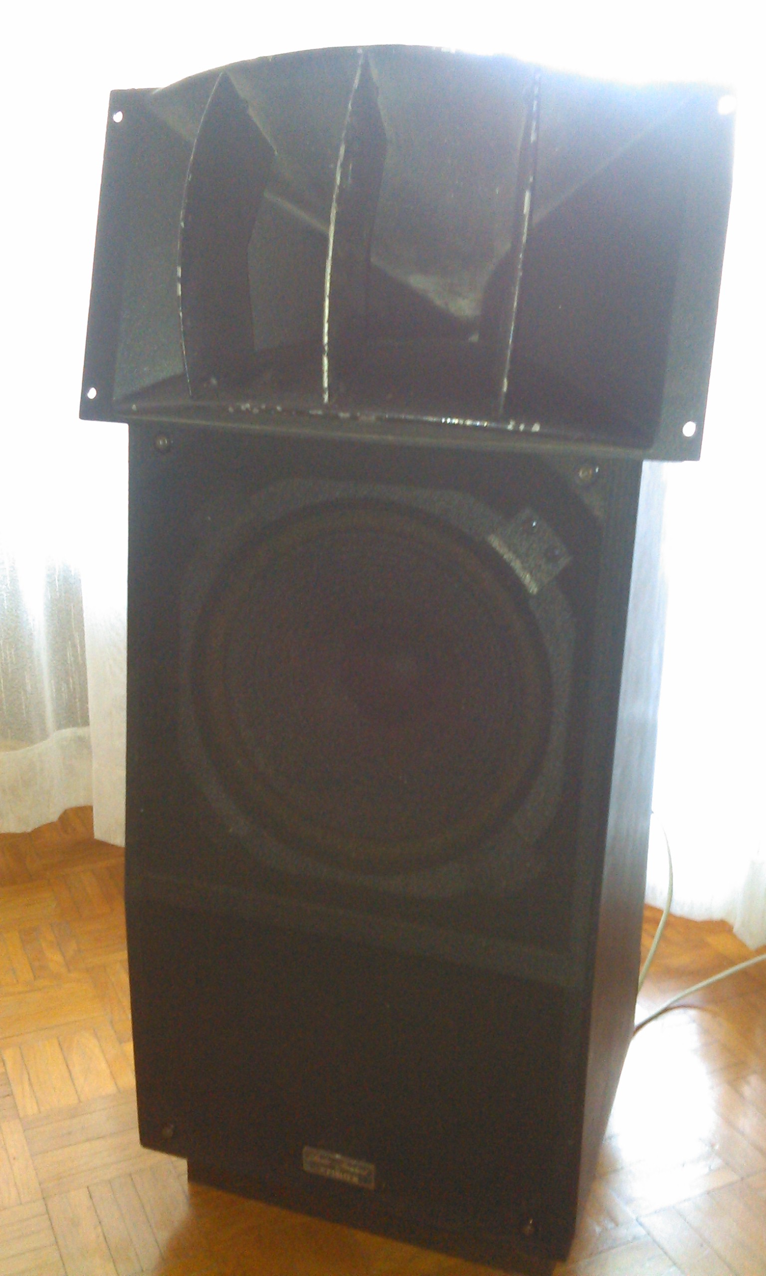

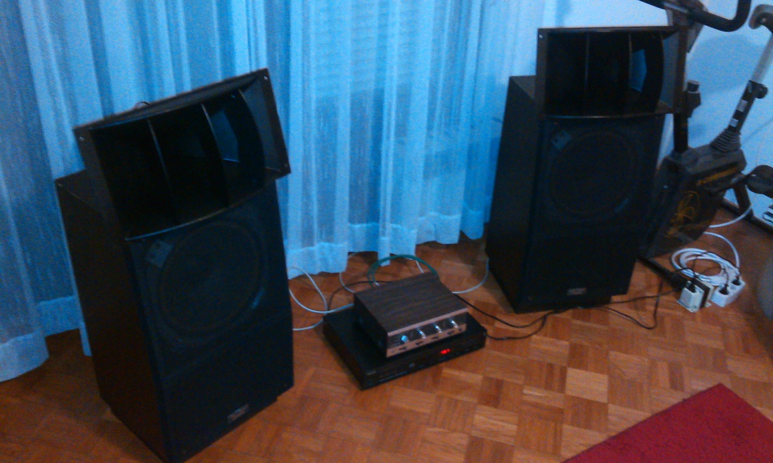

For anyone who cares for the info:
These speakers surprised me BIG.
I didn't expect much and I got plenty.
One thing though - I only found and bought the woofer enclosures and connected my RCF mid-high horns an it BLASTED me (after some horn level adjusting)!!!!!
Wholeheartedly RECOMMENDED!
Abundance of first class sound and atmosphere typical for vintage Klipsch!

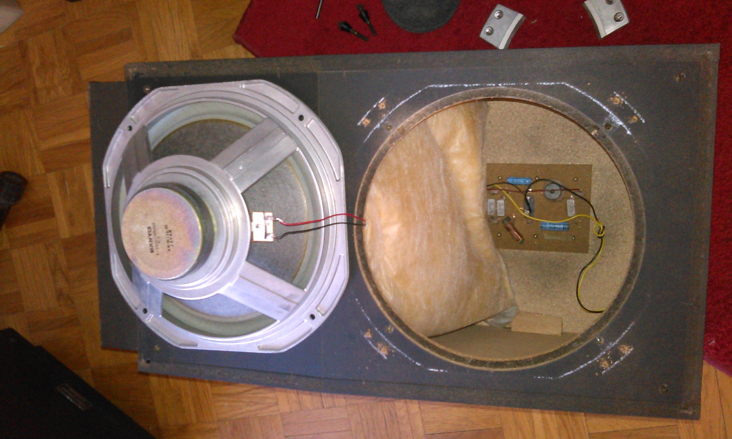

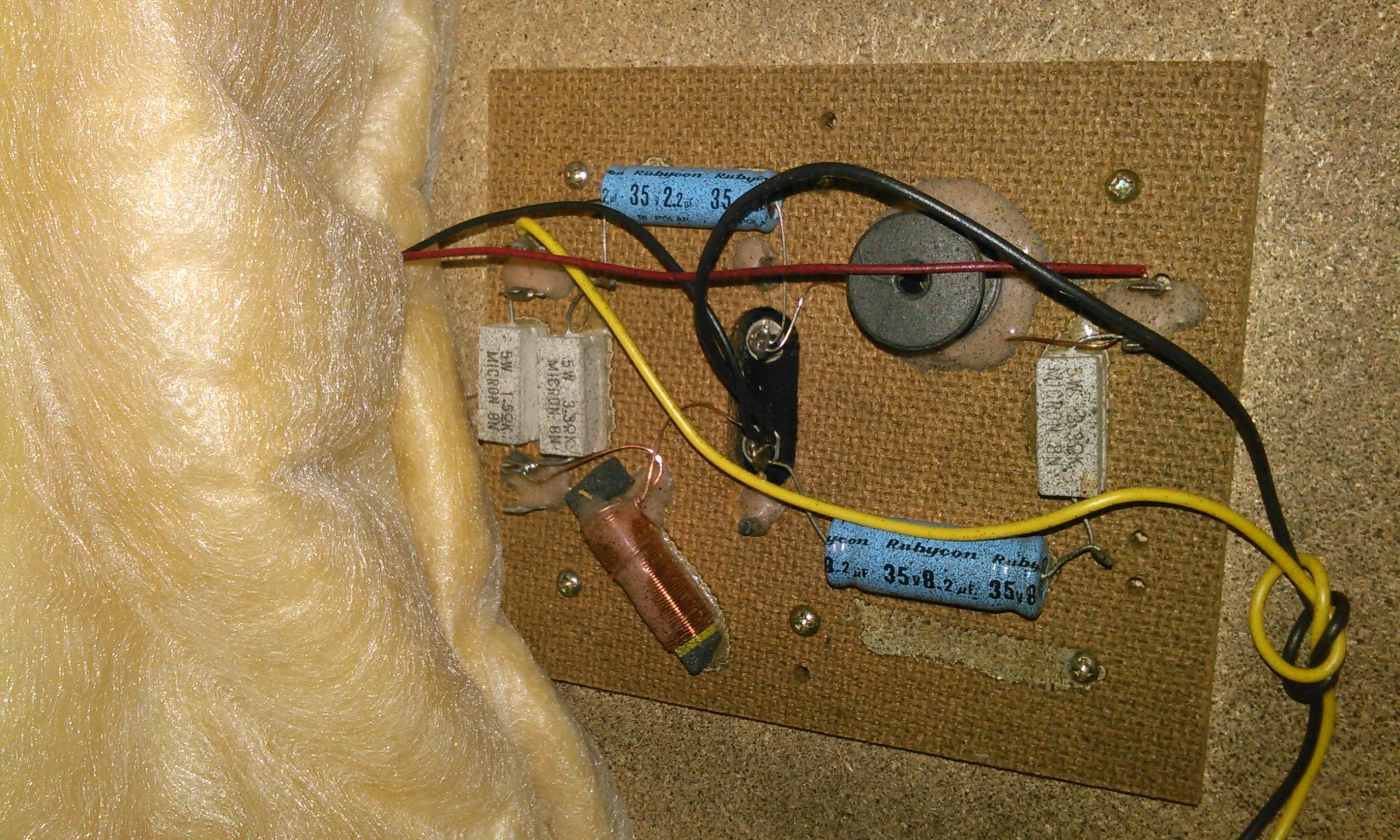

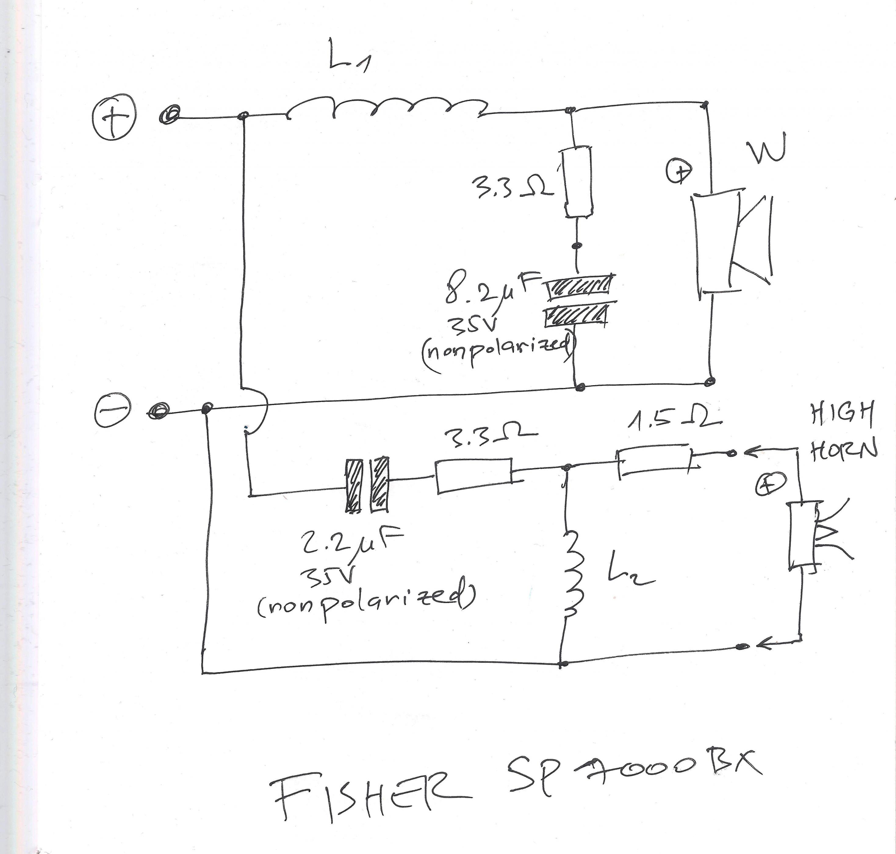

I'll be posting a crossover schematic soon.
It's quite clear from the crossover photo though.
