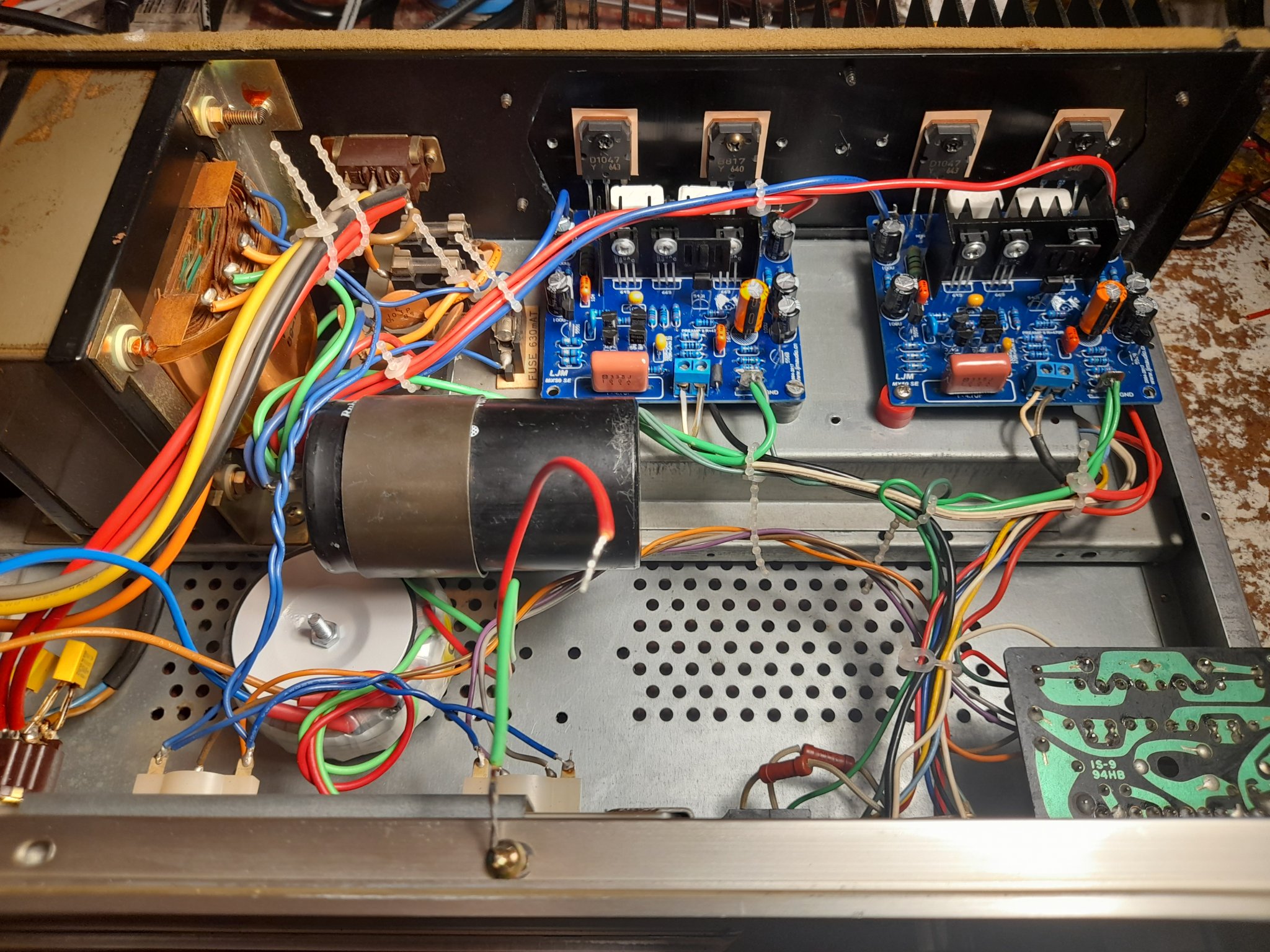

Actually the MX50SE are complete boards, I'll just remove the whole board that is in place now with the stk's and just rewire the inputs to the new boards, connect power supply (maybe with some fuses) and add a relay board. They physically fit on the existing heatsink, I'll just have to drill some new holes.
Yes ,that is good solution . According to stk datasheet ,it had 0,2% distortion ,and its output was assymetric . Old technology would not sound best as possible ,so another module or board ,with better parameters is like upgrade .MX50SE has kinda similar schematic as stk inside ,but complementary output .
Most of these stk's, apart from reliability problems, don't actually have terrible specs but I sure am all for discrete components !!
Some stk were released in different versions ,generations ... I , II ,V ,XI ... I was interested some years ago in building amplifier with one of those ,with xii at end ,but read about oscillation problems and changed my mind. In XII version ,if i remember correctly, pinout same ,but distortions lower than II version .

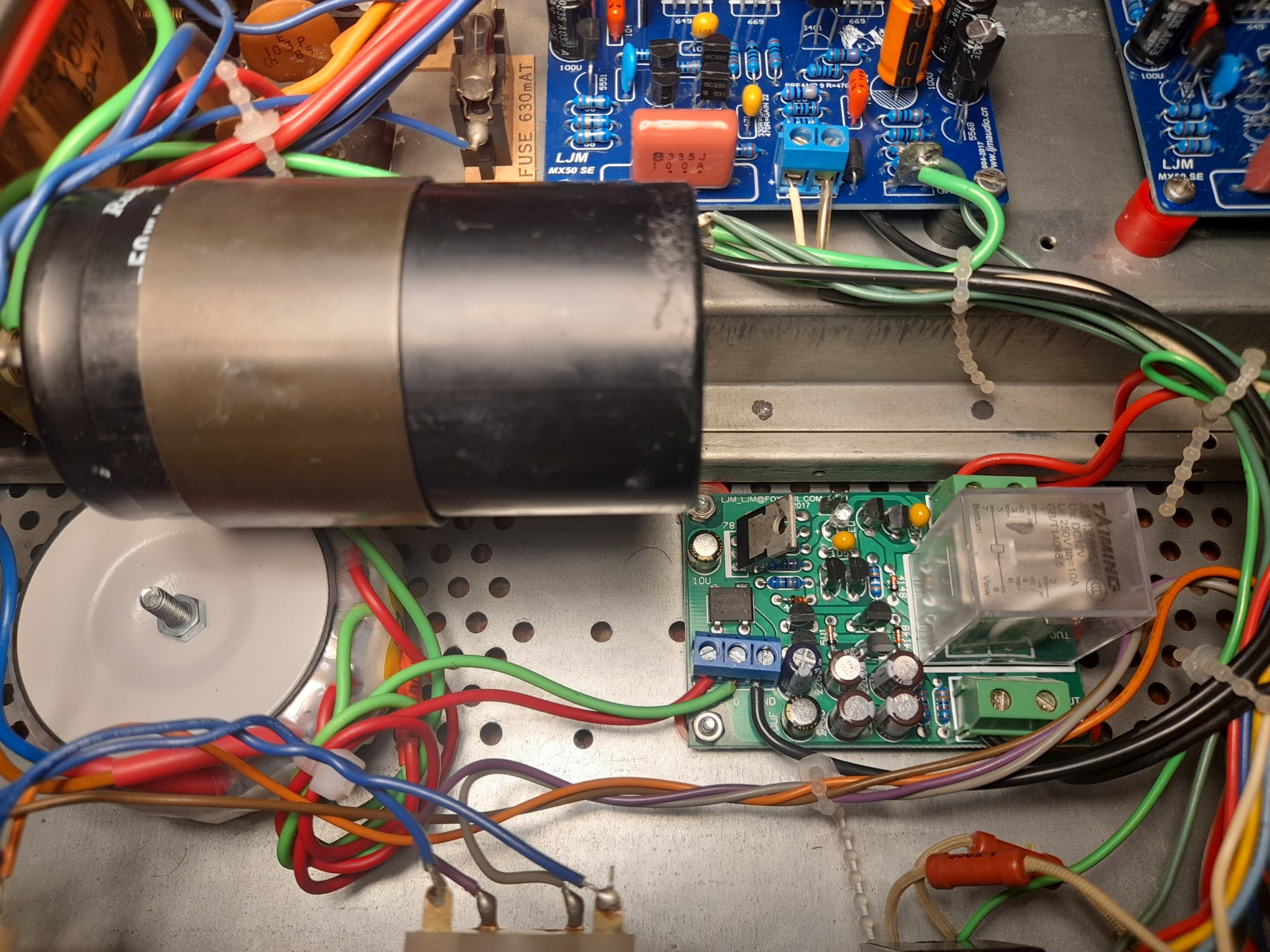

I just finished installing the MX50SE modules and it turned out pretty good. Nothing really exceptional but I'm getting clean power (0.02 ~ 0.04% distortion) all the way up to 57W from 15 to 26Khz. There possibly is room for improvement because I used the cheap components that were delivered with the kit, also bias is higher on one channel and not adjustable but I'm quite happy with the way it turned out. Also I happened to already have a little 12V transformer that is perfect for the protection board and fit nicely in there as there's a lot of room in these. Plenty of space on the right to fit the relay board.
My main amp is a Sansui BA-3000 with its complementary pre so I don't think this one will come even close. I think I'll either use it as a bench amp or just keep it as a project to experiment.
