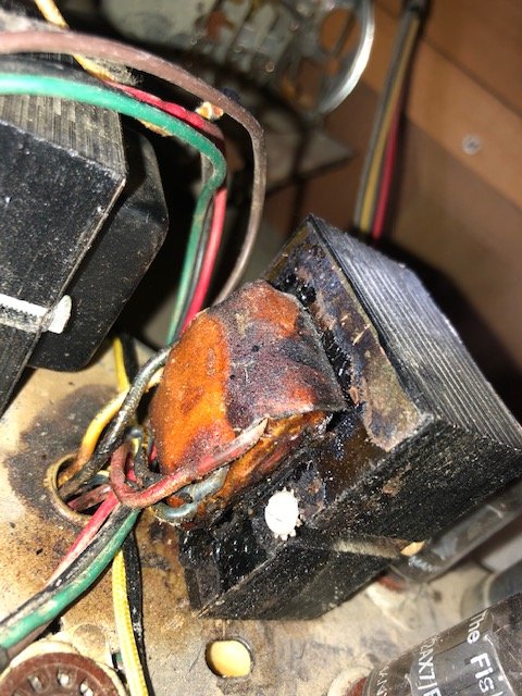

Hello,
Another rookie question. I have a Fisher console amp I've had for about 10 years. Don't play it often as I'm trying to decide what to do with it. Turned the switch one day and it popped the fuse. Got it fired back up and one channel is dead. Took a picture of one of the transformers that looks suspect. I don't know how to test one. Thought I'd ask the smart people before I start searching for a transformer. Thank you
Did you intend to attach the picture?
Before attempting to buy a replacement, note that output transformer failure is usually a symptom of a different kind of failure elsewhere in the amp.

I once had a Fisher console amp in the shop that was pretty toasted.
One output transformer AND the power transformer were shorted, and bad tubes.
It was an SA-16, an EL84 design.

I have the same amp. There's specific things you must do to it, to get it to operate as a stand-alone entity. 1st and foremost, without the tuner-preamp part of the console attached, the cathode current of the output tubes has nowhere to go. Unsure if that would result in the damage you've experienced, with your tubes and output transformer.
I'm fixing mine up so that it operates normally by itself. I'm going to try generating a bias voltage, applying it to the existing bias control for the output tubes. At the same time, I'm going to reduce the output tubes screen voltage, as this amp will run a very hot B+ without the rest of the console circuitry attached.
You'll need to measure the windings on that suspect transformer, compare to the other channel. If its cooked / shorted, then you'll need to make a decision, something along the lines of $50 for another OPT, $50 for set of working 6BQ5 tubes (or equivalent...); $50 for a matching OPT - after you get it working / stable with the mis-matched ones.

To be specific, measure the dc resistances of the primary and secondary windings of the suspect output transformer and compare the readings with those obtained from the transformer on the working channel.
