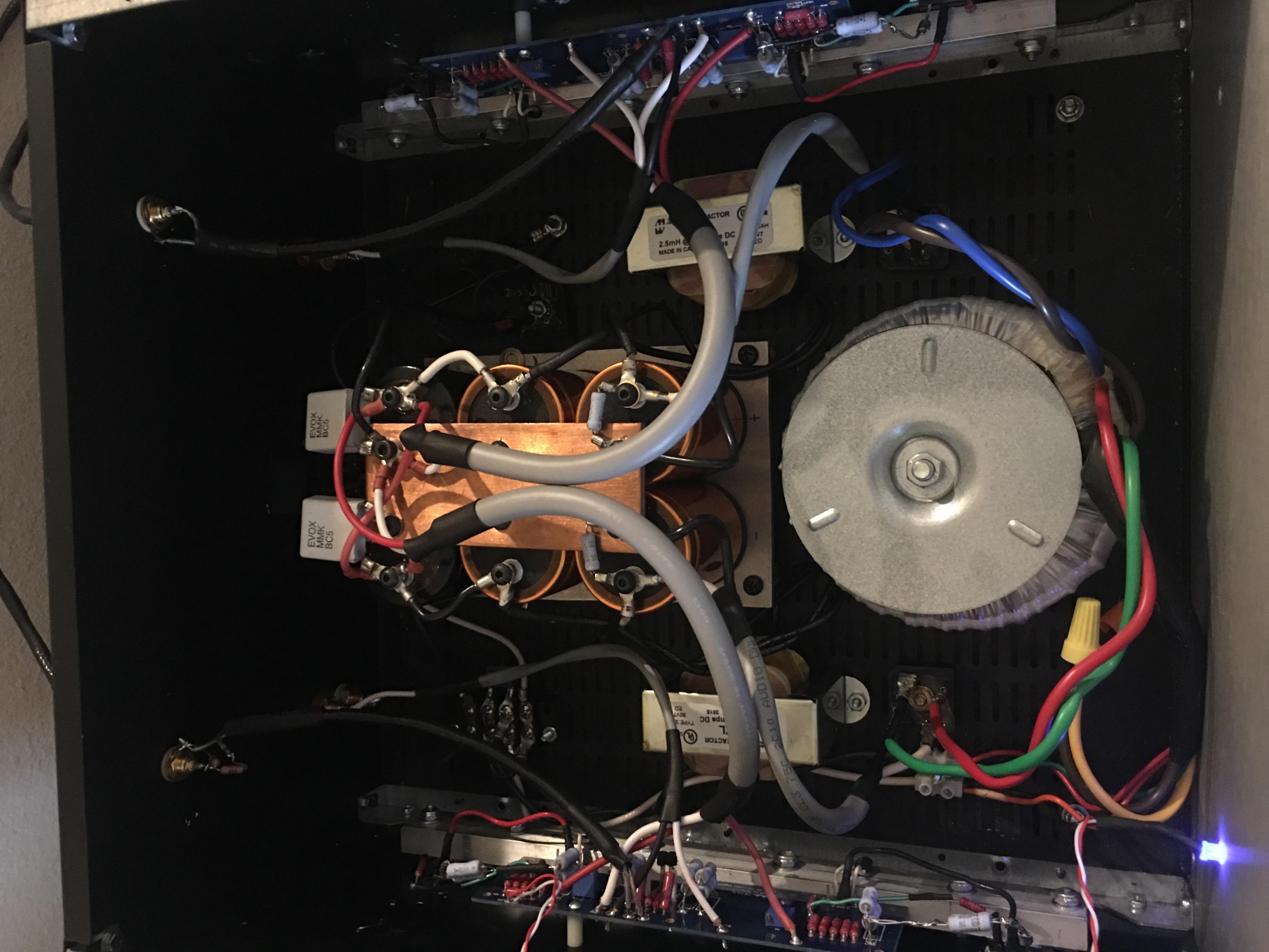

May I kindly ask for opinion on the durability of the FW J2. I am in Japan, and the PL dealer no longer sells the FW J2. So, I must turn to the second hand market, where 3-4 come up during the year. Some of these are of an early vintage (2010 or so). Would there be a concern about the durability of the FW J2 for that period of time - specifically would there be maintenance needs coming up to the age? Thank you for your opinion. [PS. My first post here, and I apolgize in advance for any transgressions of etiquette.]

I don't recall any failures of J2 in the last 5 years.
And we do keep an inventory of the Jfets for repair work.
You can purchase new from Reno Hifi and have it shipped to you.

I would have no reservations buying it second hand. If I chose to buy second hand, I would either buy from Mark at Reno HiFi or at least verify the serial number with First Watt to make sure it wasn't a Chinese fake.
There has been one in Spain for sale for some time that is clearly a counterfeit. Interestingly, the market seems to know this as the vendor has lowered their price several times and last I saw it was still for sale.

I would have no problem buying a used one, especially in japan...the land of well cared for personal items. The only thing that would possibly need replacing are the psu caps and there are so many places in Tokyo to get that done...or at least there were 15 years ago when I lived in Tokyo. I have friends running a record shop near Shibuya...They can provide some info on repair/service places if you need it.
But the caps should be good for another 10 years or so. The caps in my DIY F5 were made in 1996!
