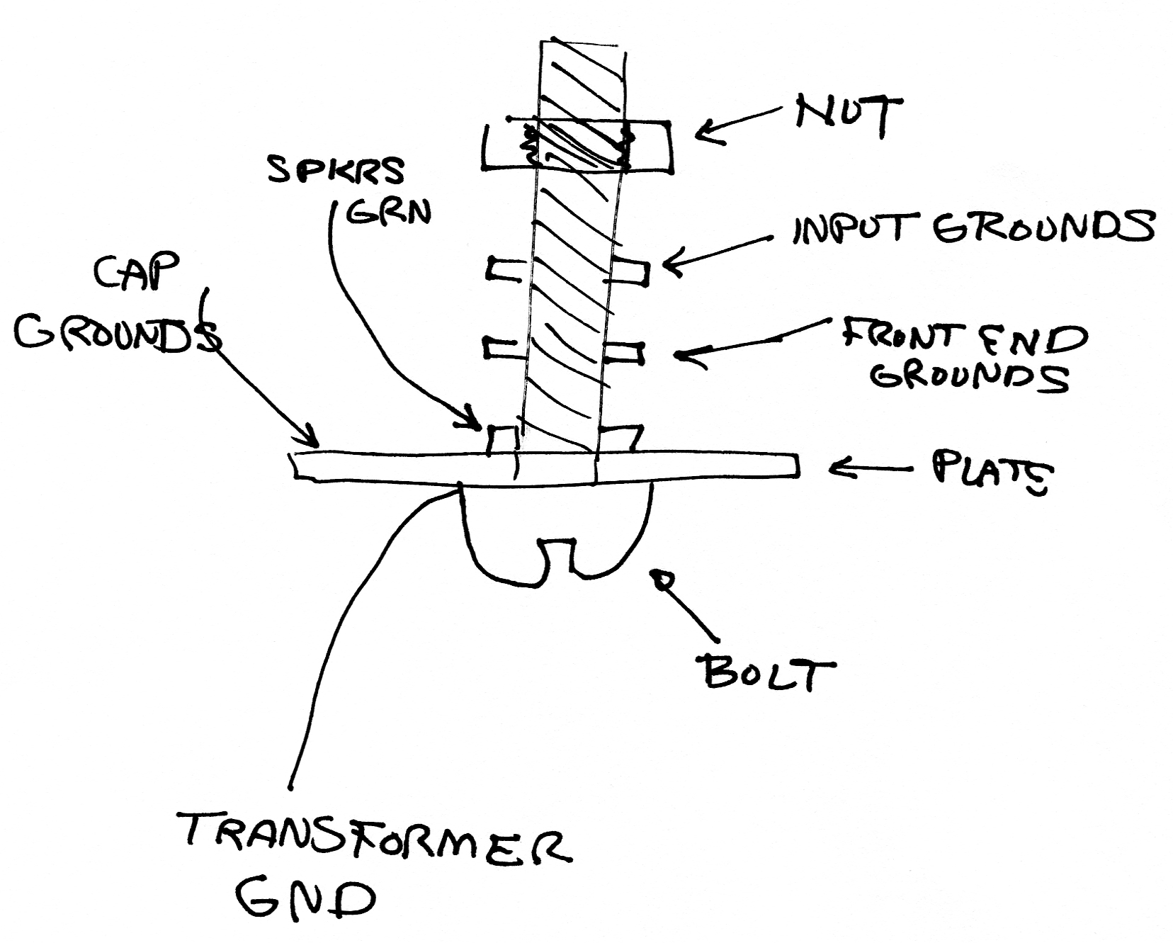

I had the wisdom to buy lots of the R100's, so there will be continued
product either of J2's or something else.
The issue about two channel supplies and grounding is largely economic.
Better isolation is afforded by mono chassis, and for stereo units the
grounding layout becomes more critical. I use the "hierarchical" approach
and the result as noted by Stereophile is an isolation on the order of -100 dB.
I weigh that against the approximately double cost of mono.
:cool:
Mono is not for everyone since if you aren't going all of the way with it it is almost nonsense.
No question it would probably not be much cheaper than just getting two J2s.
Now we will all be studying to figure out how to implement a hierarchical ground!
Take care,
