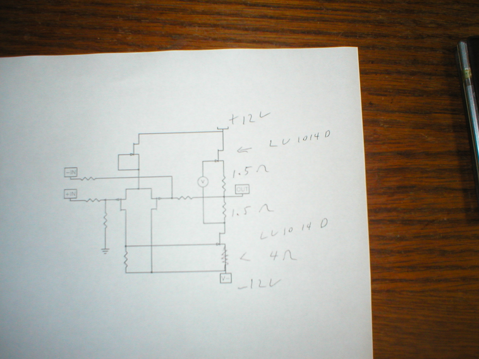

Looking at the simplified schematic of the J2 I wondered if the LU1014D might be used to build a 5W version. I stole the schematic from Nelson and wrote in some values. Note I added a big 4ohm source resistor for the bottom LU1014 it was either that or run the front end at a higher voltage. Even at this 5W level keeping that tiny LU1014 will take some work! Keep in mind this is still just a simplified schematic.

Looking at the simplified schematic of the J2 ....
somewhere in Aleph J thread you can see some good (Papa's and Patrick's ) thoughts about implementing LU in that concept . there you can also see my usual "dumb ZM" contribution :rofl:
besides that - in same thread you can find plenty tips regarding Uds and Iq for LU , to keep it in sweet triode region
F3 pdf is certainly informative , too .
ZM, might you be thinking about the DAO or headphone amp threads? Whatever, there is some good info from Patrick on the LU device but finding it all might be tedious...
However, my own thumbnail suggestion would be, a 1-1.2 ohm Rsource for the LU and 1/2 that value for the 2 Rs in the middle... Just my 2cents worth. running non cascode you would likely want to keep the power on the LU <10W and maybe paralell a couple?
